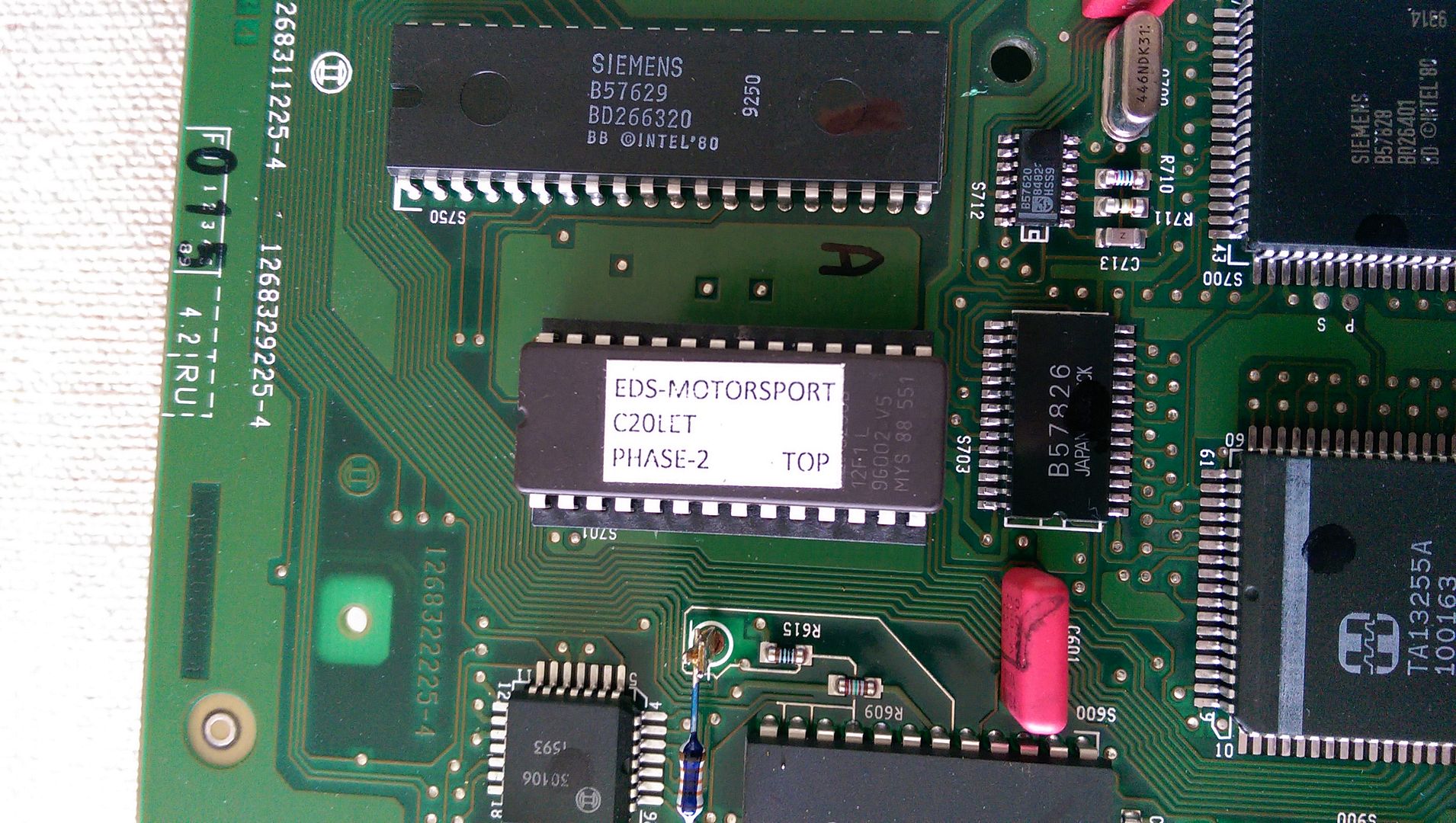

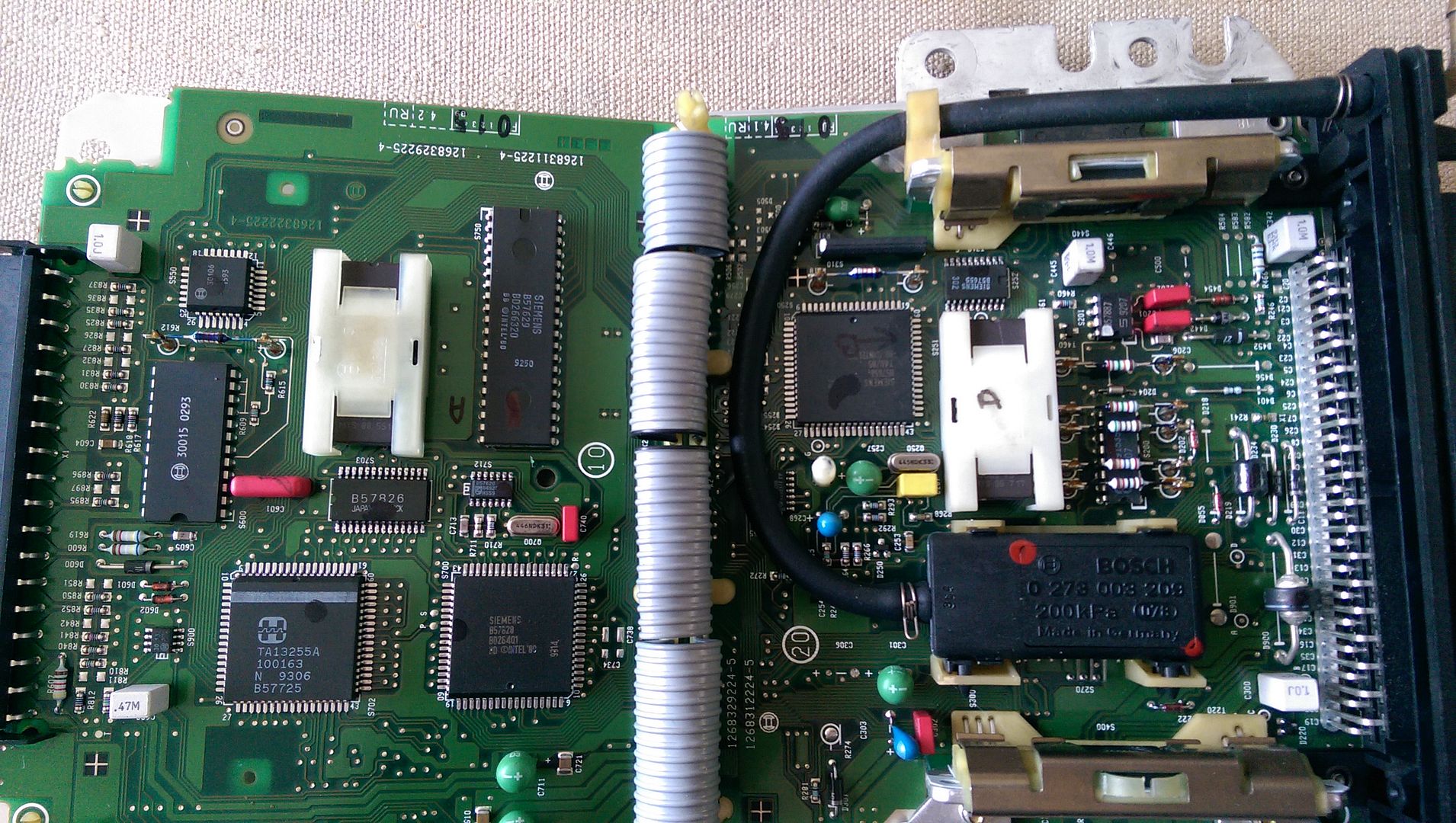

So took the car home and found the ecu was very hot... That isnt right.
Opened the ecu up,
These where in it... Meant to be gen chips, I don't think they are.
http://img.photobucket.com/albums/v3...ps520d5223.jpg
Swapped to a spare set i had.
http://img.photobucket.com/albums/v3...psf83e56c4.jpg
ECu light still ok, still running off.
but now got a standard ECU tried it last night and it runs much better and no ECU light. Just need to adjust my fuel pressure down now.

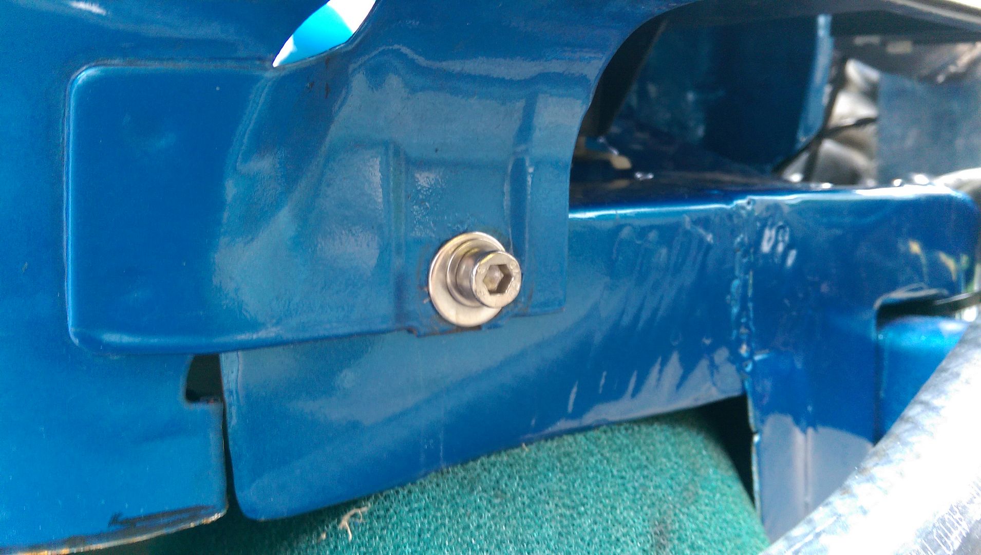

Being a big fan of riv-nuts/clinch-nuts i've fitted the to where the wings mount to the front panel. Makes life much nicer and easier.

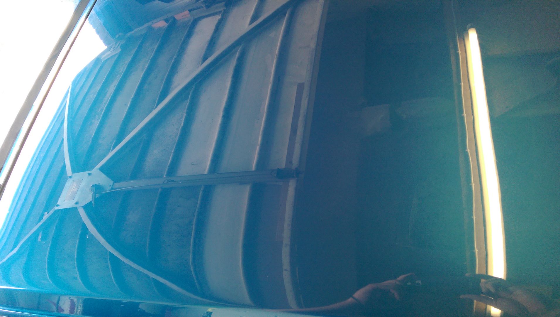

Now i had a lot of marks on my roof, from me and from being in the bodyshop. So i set about fixing them, more involved than i thought. I ended up 3000k grit wet sanding my whole roof.
http://img.photobucket.com/albums/v3...ps32282c9e.jpg
Looks a bit better, i've looked for marks and can't see any.
