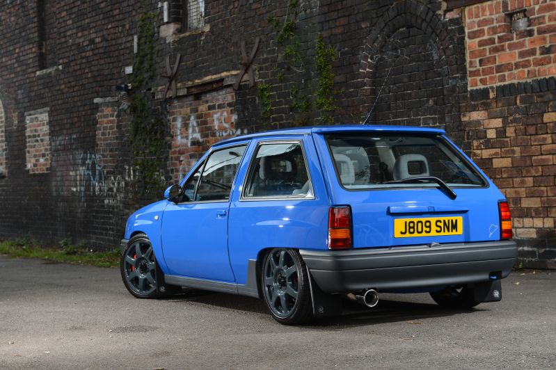

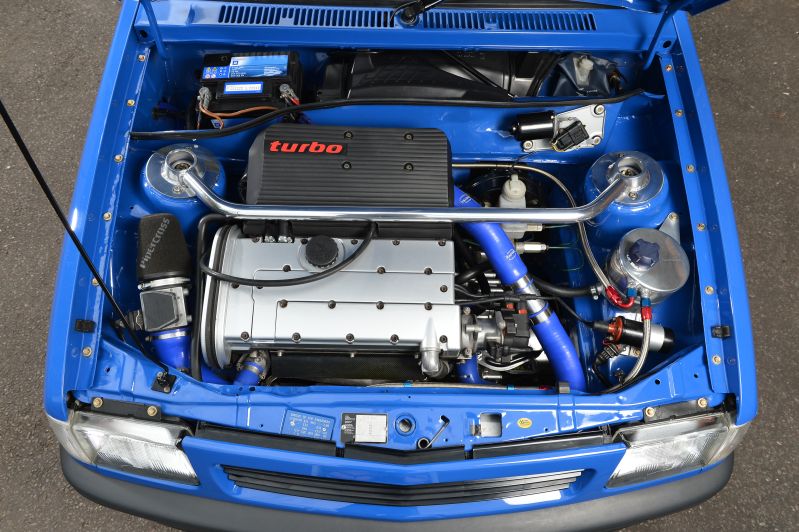

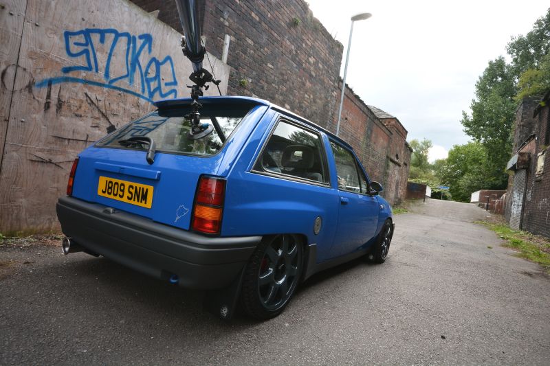

    For those who havent seen Martins recent thread or the total vauxhall feature heres a few pics of the build process...
    Fully blasted/re galvanized shell via central blast cleaning which later went to Ade culley for a bare shell top paint job....
    Rebuilt C20let engine and quaifed F28....
    Radtechs custom Intercooler/Radiator combo designed by Andy.....
    After years of graft and a huge amount of money the car was featured a few months back looking fantastic....
    Full spec list for those who fancy a read...
    Spec.
    Body
    Full bare metal shell restoration – repainted in Original Breeze Blue
    Central Blast Cleaning shell preparation including stitch welding and 3M rust proofing throughout
    Harry Hockley Group N strengthening kit
    Powdercoated everything, TCA’s, Rear beam, all brackets (anything that could be done, was) all fittings replaced with stainless.
    New GSI bumpers & skirts. New lights all round, grille & gutter trims and windscreen all brand new.
    Manta 400 wing mirrors mounted on carbon backing plates & base model interior trims (no adjuster)
    Engine & Transmission
    C20 LET – ARP Rod bolts, 2mm Cometic Head Gasket – all new gaskets, bearings & rings. EDS phase 2
    F28 Gearbox with Quiffe ATB, Grifford Engineering fully rose jointed selector linkage (short-shifter), new driveshaft seals and Gulf Racing oil
    JP Custom exhaust from Turbo
    Custom Radtec concealed alloy intercooler, radiator & oil cooler package
    Walbro 255 fuel pump & all new lines
    Aeroquip turbo coolant, oil cooler and header tank lines & fittings.
    Equal length driveshaft setup with new bearing.
    Custom Lloyd racing hubs comprising reinforced bearing carrier & truck bearings.
    Chassis & Steering
    Corsa B EPAS steering column with weight adjuster
    Quaiffe 2.2 quick rack with solid billet mounts
    Spherical bearing top mounts and tie bar mounts
    GAZ GHA Coilover's all round with custom spring rates
    Fearless Motorsport Strutbrace
    Custom lower arms with strengthening plates and tie bar lowering spacers all in one.
    V6 front brake conversion & Astra rear disks. Goodridge hose all round.
    Rare 16 x 6.5 Raceline RL7 alloys powdercoated in anthracite. Continental Sportcontact 2 tyres

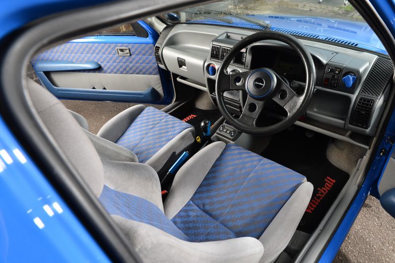

    Interior
    Immaculate 92 blue/grey SRI interior
    Astra GTE Digi-Dash (was brand new from Billing)
    Corsa C info display
    Electric sunroof conversion using Vectra surround.
    Calibra Turbo steering wheel centre
    Body coloured heater & headlight controls
    Leather gearknob & alloy handbrake handle, both with leather gaiters
    Rear Headrests
    Classic Kenwood Mask headunit!
    A few weeks back I returned to stoke to collect It. Really enjoyed the drive home whilst trying to get used to the power steering, Helix paddle clutch and the six speed box ratios as Ive never used these before in my previous nova turbo/big block novas etc. I was also thinking about what I could do with It??? Hmmmmmm.....
    More to follow.......
