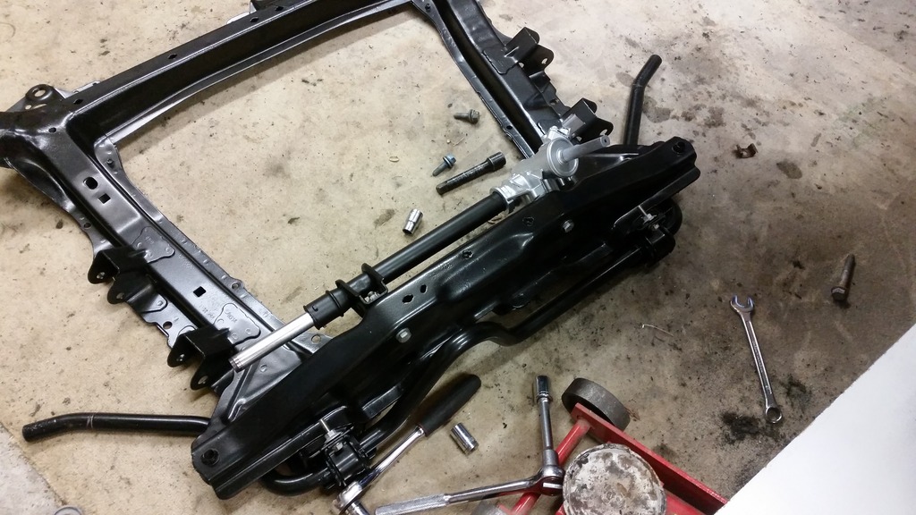

How about something akin to the Clio 1*2 Front Anti Roll bar where it goes backwards and is bolted properly to the body/subframe, yes it would be work but its likely to make a positive difference to the handling rather than a negative one that the std one does

No pics, more that When I was under my 182 years ago it looked like a good solution, so could use something like that as an idea for the Nova...
