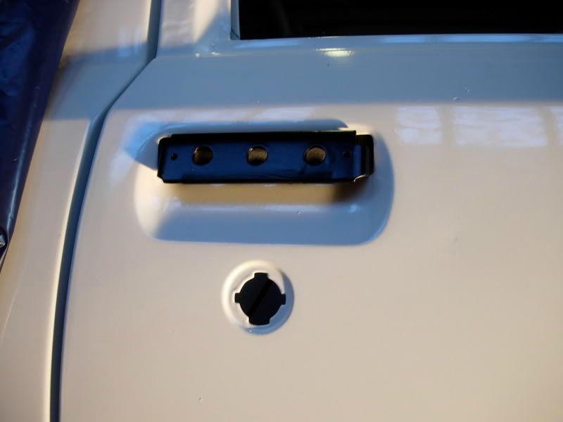

I was modifying the handles to light weight/flush fit items, we shall call them DH'Development style handles lol
So it went something like this...
Cut the rubber covers off
http://img391.imageshack.us/img391/3...re001small.jpg
Then placed the handles back in to find that part of the rubber cover has the bulges on it to rest on, meaning the handles were hitting on the handle opening, at first i was like NOoo what have i done, then i realised there was potential for a nice flush fit handle, so marked up where the henge was hitting, grabbed a file and attacked the doors!
http://img391.imageshack.us/img391/3...re002small.jpg
Drilled out with 8mm drills on two side one's,then step drilled the rest with 8mm-10mm then finished with 13mm OD,and primed.
http://img391.imageshack.us/img391/9...re003small.jpg
Both done and top coated in rover hurricane gray (thats almost the same color as the standard rubber cover)

So this work was done at the weekend, but i fitted them today, as i wanted to make sure they had dried quite well.
Onto the fitting today.
Quite a flush finish to them.
http://img391.imageshack.us/img391/2...f0573small.jpg
http://img391.imageshack.us/img391/9...f0574small.jpg
http://img391.imageshack.us/img391/3...f0577small.jpg

Nice work Scott, 3 holed handles FTW!! lol
http://img.photobucket.com/albums/v3...a/DSCN2345.jpg
lol Ian you might want to go put them groves in the doors to make them sit flush :thumb:
What OD did you put in yours?

Not sure, the biggest drill bit I had at the time! lol,
There not that big to be honest

I used a 13mm for the final hole size, it just fits upto the slanting part.Quote:
