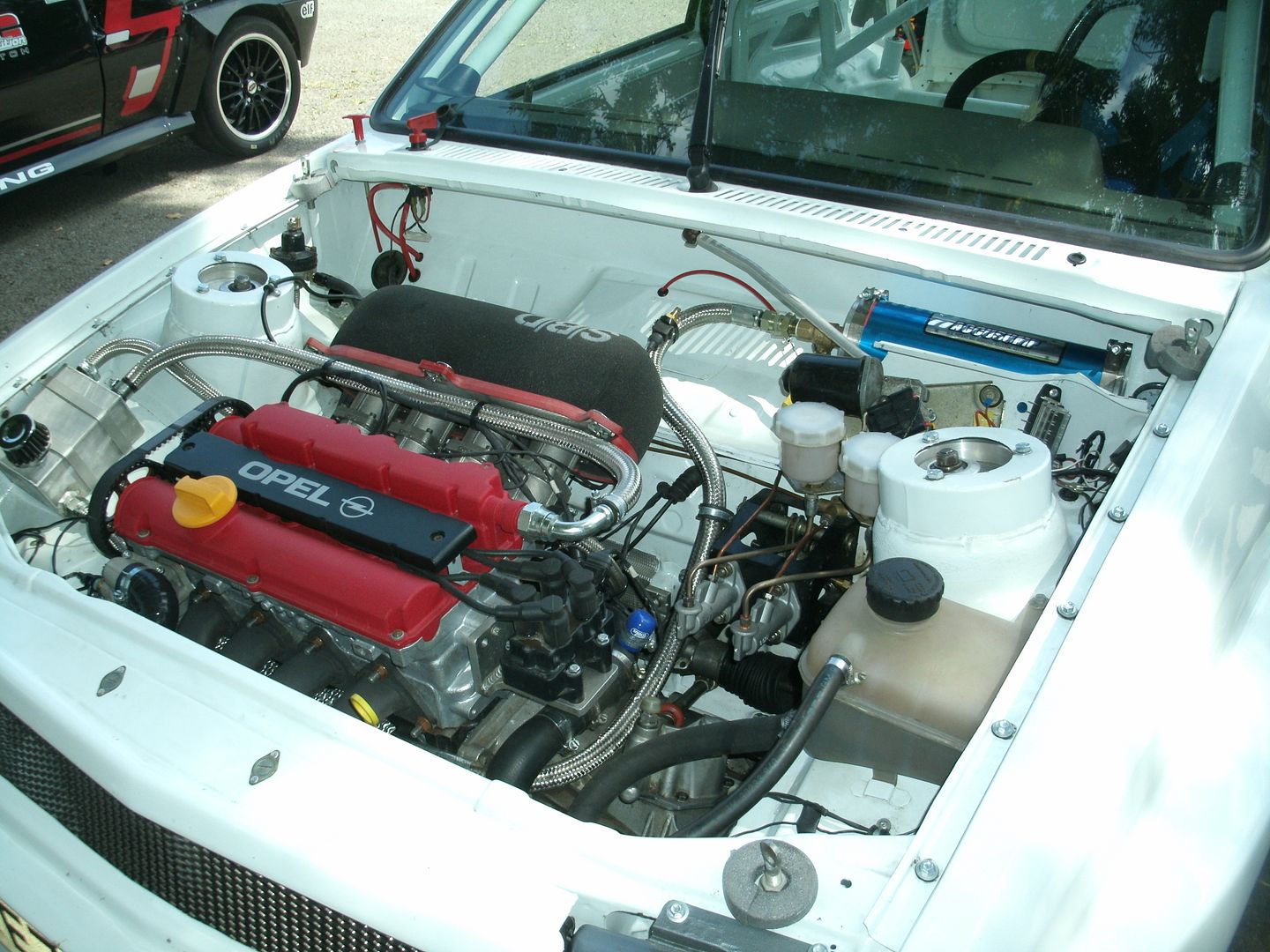

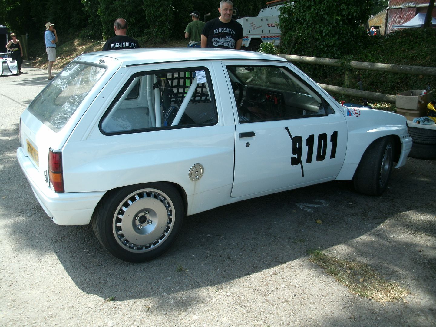

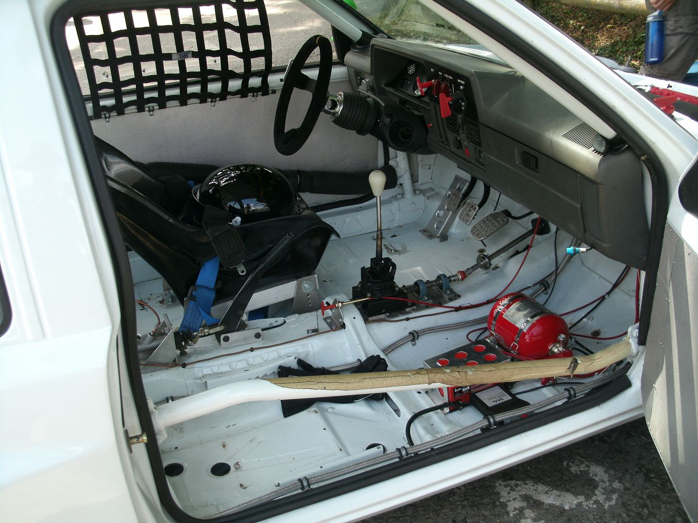

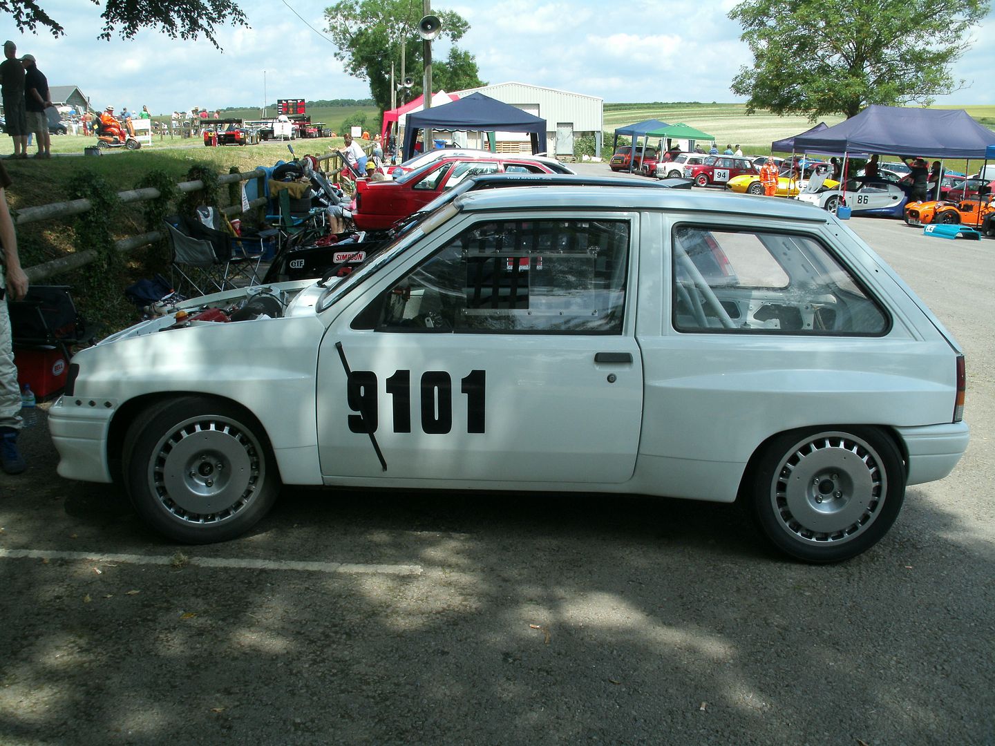

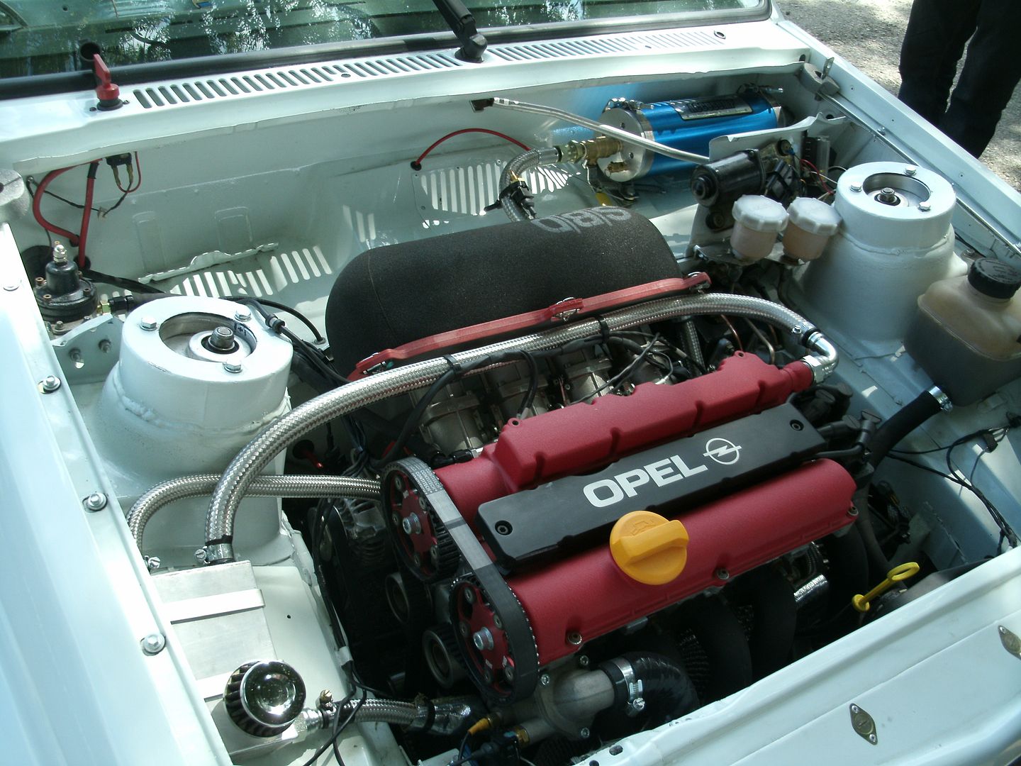

Not an update on my car, but after a 7-year absence from motorsport, it was great to welcome back Kevin and Ian Plummer today at Gurston Down hillclimb;
http://i285.photobucket.com/albums/l...ps0ca5b333.jpg
http://i285.photobucket.com/albums/l...ps34f4ccb7.jpg
http://i285.photobucket.com/albums/l...ps67519227.jpg
http://i285.photobucket.com/albums/l...psdecb2ca7.jpg
http://i285.photobucket.com/albums/l...ps34e7cd70.jpg
A very successful return it was as well. The car previously used a 2.0 XE, but following the rebuild it has a 1639cc smallblock 16v engine with an XEL head, couple to an F20 Quaife SCCR gearbox with ATB.
Note the wheels - ex-works Astra 16" magnesium in ET49. Looks great.
Very nice Colin ,I love it
I was on my way up, but decided not to at the last minute as we would have arrived just before lunch time. Wish I had now.
Note, Note.... Wheels have fixing threads in them for the super rare brake cooling fans. Those would have been on either the Works Mk3 Astra or the Opel Calibra.
Kevin built this engine himself (with input from Steve at SBD), and he's done a brilliant job on it.
Very good power and excellent torque on standard cams, and there's potential for more yet (I won't post the numbers on here!).
I will pass on your number to Kevin so you can get together.
