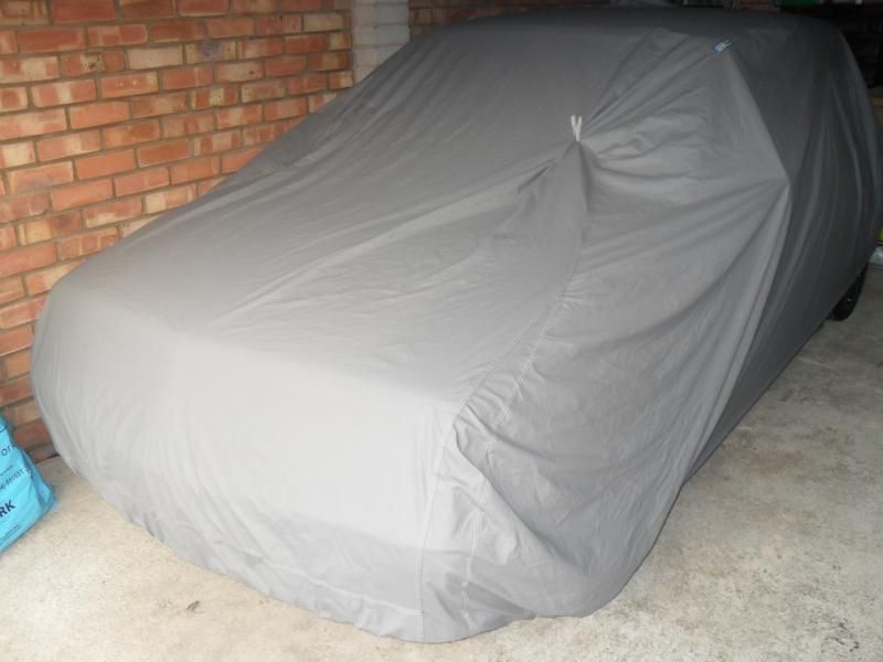

Lovely big garage there dude. You want that all painted too soon.

Cheers dude, Its much better than my old prefab at our previous house so Im very happy with it. Once I get chance I'll have it painted up and some more lighting fitted etc.

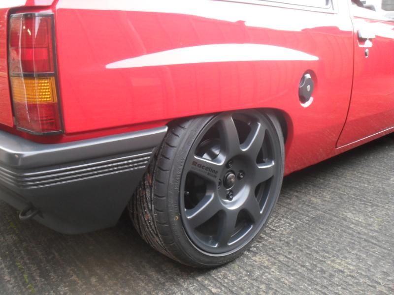

With the front brakes sorted I ordered new for the rear all round. Drums were finished in the same colour/finish as used throughout........
http://i84.photobucket.com/albums/k2...bowip195-2.jpg

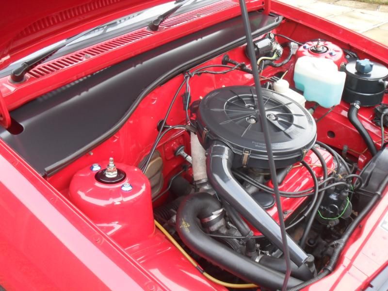

Lastly I've been thinking for a while what to do to freshen up under the bonnet. Here's what I came up with........
Wiper motor/backplate,gsi servo and bailey header painted up and fitted......
http://i84.photobucket.com/albums/k2...bowip191-2.jpg
Then I decided to do the airbox,dizzy cap,dipstick and filler cap grey too. To compliment these the rocker cover was painted up in carmine red......
http://i84.photobucket.com/albums/k2...bowip190-2.jpg
Heres how the bay looks on the whole now........
http://i84.photobucket.com/albums/k2...bowip193-2.jpg
Im quite pleased how its looking now. It may be sometime until I can fund the conversion so I thought It may as well look tidy until then! More soon.

Wheels and brakes look great, will you be running a center cap? Bay looks tidy.
wheels look the bollox but u have copied me on the wheel bolts flol

The wheels were rally issue so didnt come with centres. I know from last time I tried their is little to no chance in finding a set unfortunately. Bay looks cracking in the flesh its my poor pics that dont show It very well thats all!

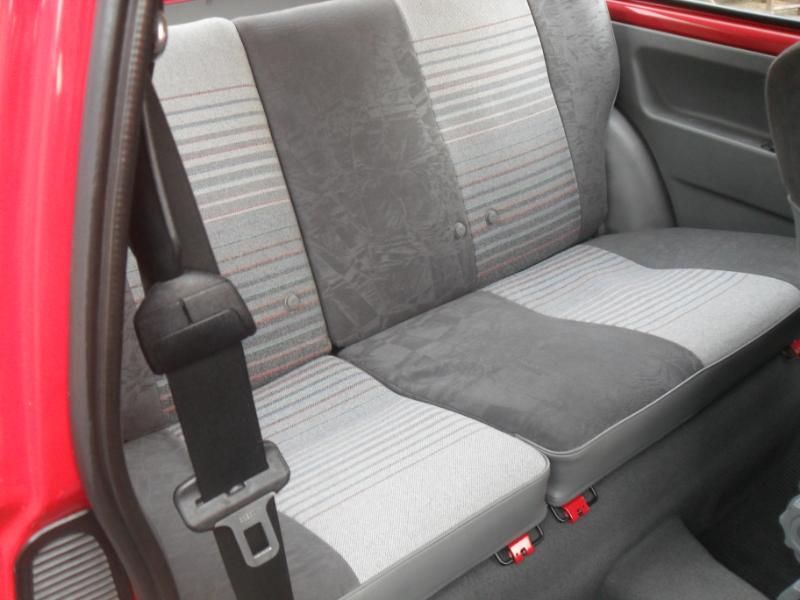

Also a little while back I decided Id like an interior change. I wanted something that sort of represented the cars age/eira however Im really not a fan of the burberry or sport trims so thought a gte interior would suit rather well? After putting a wanted advert up Edd got in touch to offer a mint interior he had stashed away a deal was later done and up North it came. I had a valeter from work give it a real good going over with fantastic results and later trial fitted it........
"Mint" and I mean "Mint" rainbow sr trim and genuine rubber mat set from the 2k mk2 I sold on sometime back........
http://i84.photobucket.com/albums/k2...g?t=1357402379
Now I didnt actually realise until it turned up that this trim used a 60/40 rear split bench so I wasnt ready for it but got it in for mocking up purposes.....
http://i84.photobucket.com/albums/k2...g?t=1357402200
I later sourced the rear seat brackets from a gsi project of Phil lofthouses who wouldnt be needing them. Big thanks to Phil who relieved his shell of the needed parts of floor section that the brackets were on! I had one of the panel guys from work very neatly seperate the brackets from the floor section so they could easily be re used. I then cleaned them up and painted them in carmine red. Now as many of you know the rear bracket can be easily bolted in but the front one needs to be fitted via weld/rivets or run completely without the front bracket as Ive seen some do in the past. However I wanted it to be done neatly and properly so thought out my options and one of the guys from work came up with idea of using a proper 2k adhesive bonder to effectively glue it down. Now I know this may sound dodgy but the product we used is the same gear we've been using to fit Bmw roofskins/quarter panels for years and it sets like concrete and is the official repair method/product so Im sure it would suit a bracket that doeant really take any load. So with the rear seats in position I could mock up exactly were the front bracket needed to be marked it out and rubbed this area back to bare metal. The rear of the bracket was treated to the same and the next time we had a car in for a quarter I used a little left over product to glue the front and rear brackets into position and left a heavy weight on the front one overnight so it didnt move. With the brackets succesfully in place the only last thing to sort was a smaller bracket that sits in the centre/left of the rear bench area. This sticks up and prevents the rear bench sitting down fully as you can see in the picture above on the left side. To fix this I cut the top off it then ground/sanded the remainder until it was flush with the floor and finished by re painting it. Below you can see how they look........
Front bracket.......
http://i84.photobucket.com/albums/k2...bowip262-2.jpg
And the rear which was glued as well as bolted. The smaller bracket is the one which I mentioned I trimmed flush so the seats sit down perfect etc.....
http://i84.photobucket.com/albums/k2...bowip263-2.jpg
With the above sorted I could then re install the rear seats properly for the final time.......
http://i84.photobucket.com/albums/k2...bowip260-2.jpg
I also found their was no need to trim the carpet around the bracket as It will neatly sit under it without sticking out so didnt bother. All thats needed now is another bracket cover which is on the way as I already have one (cheers to Rich for that!) Then I can pop the screws in and clip the covers on to finish the job!

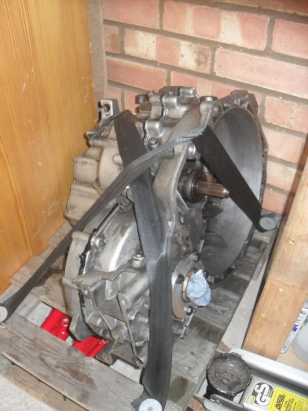

Whilst on with the above I also had this F28 6 speed with quaife/2wd arrive.......
http://i84.photobucket.com/albums/k2...bowip265-2.jpg
