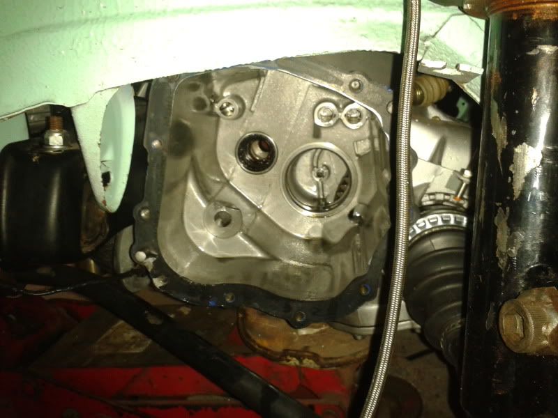

so i had a look through the vauxhall gearbox info that stuart has in his sig link and found that the f18 has similar in gear ratios and the same 5th ratio to the f28 but a different final drive and in 5spd and as i dont really want to change to a f28 i thought id get a f18, now the f28 has a 3.72 final drive ratio and thats the same as whats in a f20 4x4 gearbox and luckily i aquired a 3.72 cwp from a f20 4x4 gearbox a while back so i went and got a f18 from the scrappy off a cavalier and removed the cluster from it ready to strip all the gears off it and put them onto my 3.72 pinion shaft
cluster out
http://i127.photobucket.com/albums/p...6-07194022.jpg

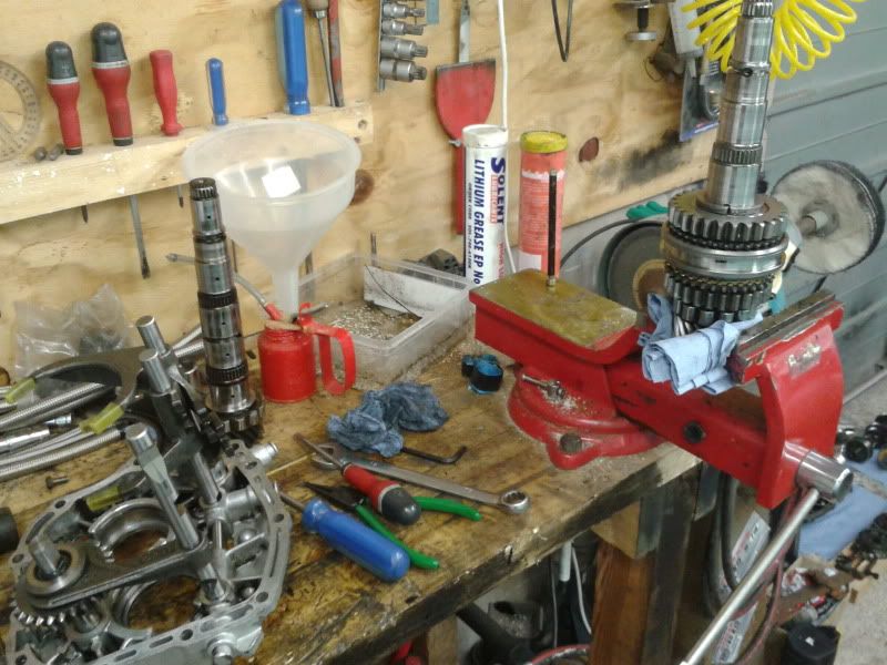

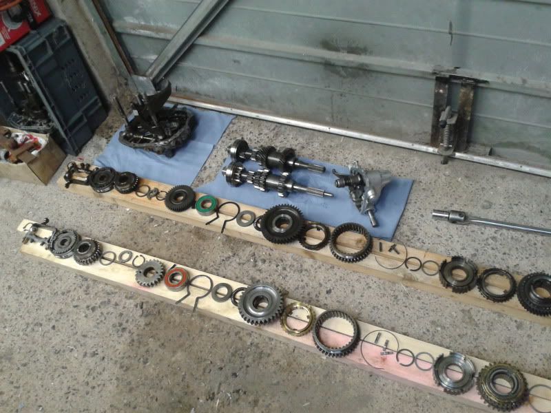

strip down
http://i127.photobucket.com/albums/p...6-07193532.jpg
http://i127.photobucket.com/albums/p...6-07193519.jpg

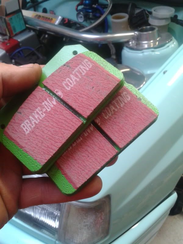

got some new greenstuff pads put in too
http://i127.photobucket.com/albums/p...6-09183214.jpg

Nice work, stripping the gearset looks a scary task how do you know what you're doing (as Haynes has nothing about it)?
