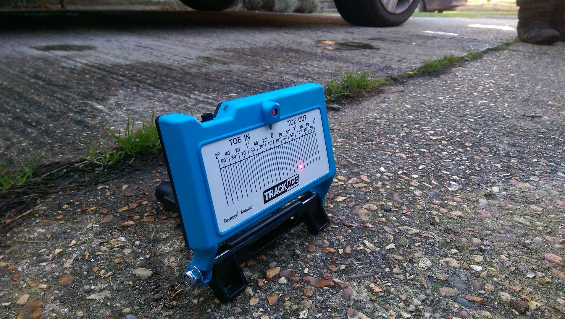

With the steering arm mods done the tracking was miles out. So Petor came over with his gauges to reset it for me.
http://img.photobucket.com/albums/v3...ps1o2gkmfu.jpg
Simple mirror with light and gauge set up.
http://img.photobucket.com/albums/v3...psdsjt4vea.jpg
Petor dived in and did it all. Got it back to 0

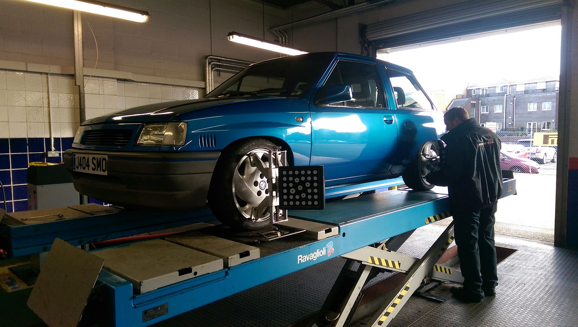

Popped to Protyre to get a 4wheel work up done.
Guy says to me as i drive on to the ramp "can you rise the back up? While looking a bit worried, then asked "it's on air yeah?" Nope, static all round i told me as i laughed.
Told him how he has to take the scaning wheel things apart as they have to run on the sides of the wheel not the top and bottom.
Bit of spanner action and we're ready to roll.
http://img.photobucket.com/albums/v3...ps733szqhb.jpg
The n/s wheel was a -0.36deg. the o/s was off to but not as bad. Not sure what happened or why. But it was reset back to well with in the limits.
