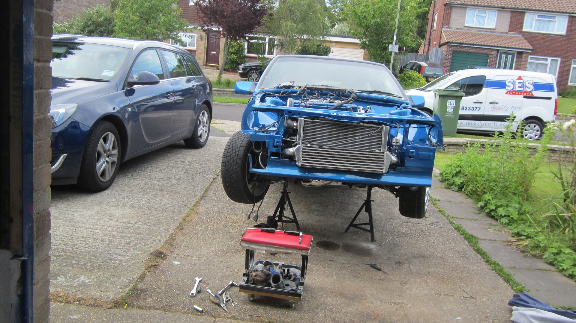

Still cracking on...
Found my filter pipe wasn't a good seal. I had an off cut so i've added it on, got it as centered as i could then tacked it on. Then welded both sides up.

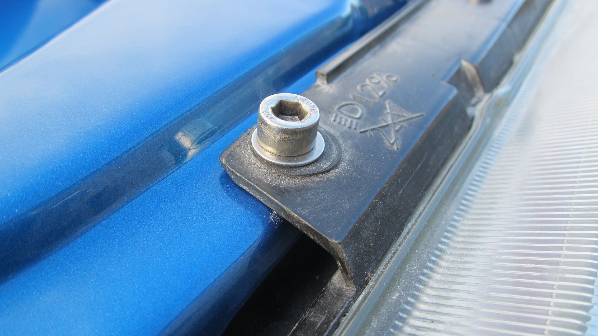

Nova headlights i think like all Vauxhall are just speed bolted in to the slam panel. Not the best, two of the 4 on mine have all ways been a bit crap. So time to sort that..

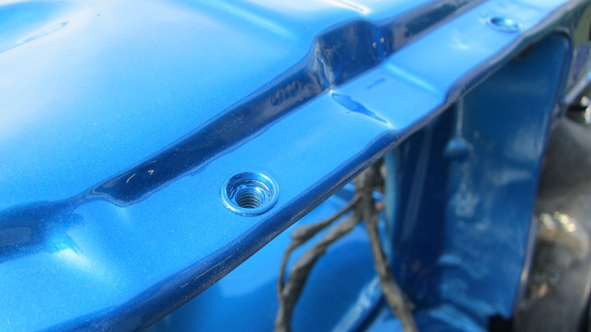

Knackered hole.
http://img.photobucket.com/albums/v3...psb53d78e3.jpg
http://img.photobucket.com/albums/v3...ps540d57f0.jpg
Al i drilled them out and have fitted clinch/rivnuts in place. As they are much better.
Fitted,

After paint.
http://img.photobucket.com/albums/v3...ps2be5dfb6.jpg
Kinda finished, but want to fit dom style nuts.
http://img.photobucket.com/albums/v3...psc12a990a.jpg
Top work as always through your build. Please dont ever sell this.
Good improvement with the headlight mounts, the original ones are shocking! Keep it up not far now
