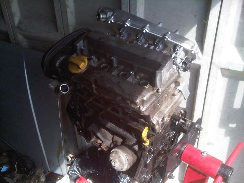

Sorry, only just seen this...are we talking about the inlet?
Like this?

Looks like it, doesn't look the easy thing to work around with that.
That inlets a waste of time unless your trying for big bhp which if a right your not.
the more i read you build benn the more i want them BBS for my cav f lol lol
Nonsense STE - you could be at a stock state of tune, change only the inlet & see a totally different power & torque curve.
I think at the mo, i wouldn't be swapping the inlet. If i was gonna i'd go DewMS as it would be a bolt on fit, so less messing about.
