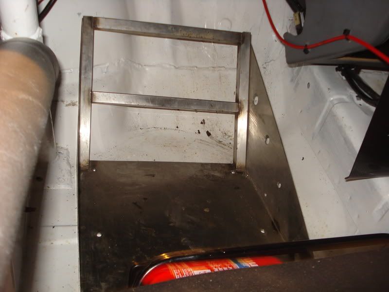

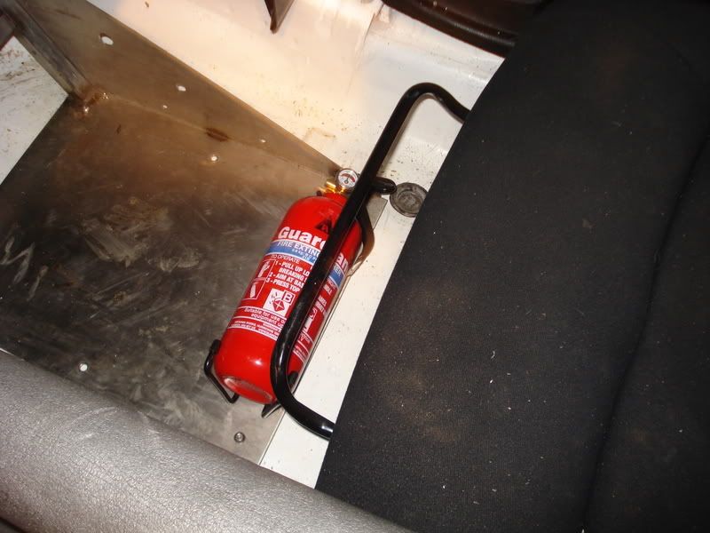

Nice progress. Here's where I fitted my footrest (same as yours)
http://iainel.co.uk/images/forums/Footrest.JPG
