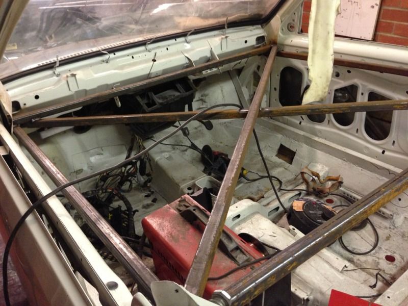

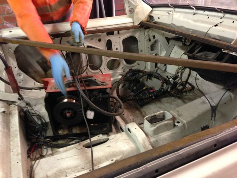

As the car is going to be blasted and put under a small amount of pressure, and then have sections cut out of the strenghtening support I decided it would be best to fit some extra support so that there was no chance of the shell folding in half. Due to my lack of welding skills I got my mate roped in to help....
Harness needs to come backout but it'll do for now..
http://i15.photobucket.com/albums/a3...284ED50998.jpg

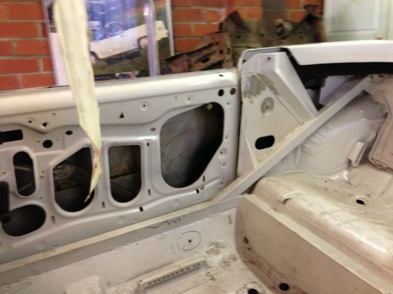

Cleaned up where its to be welded onto
http://i15.photobucket.com/albums/a3...285524FDE6.jpg

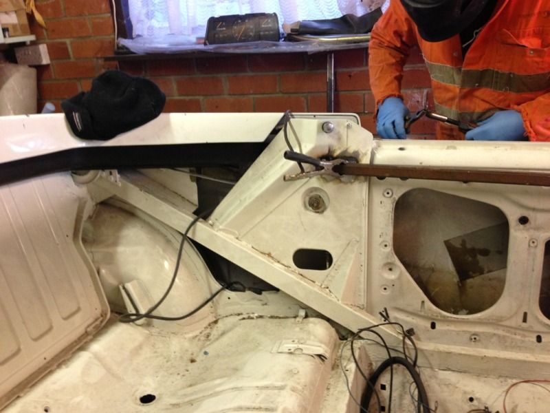

First bar tacked in

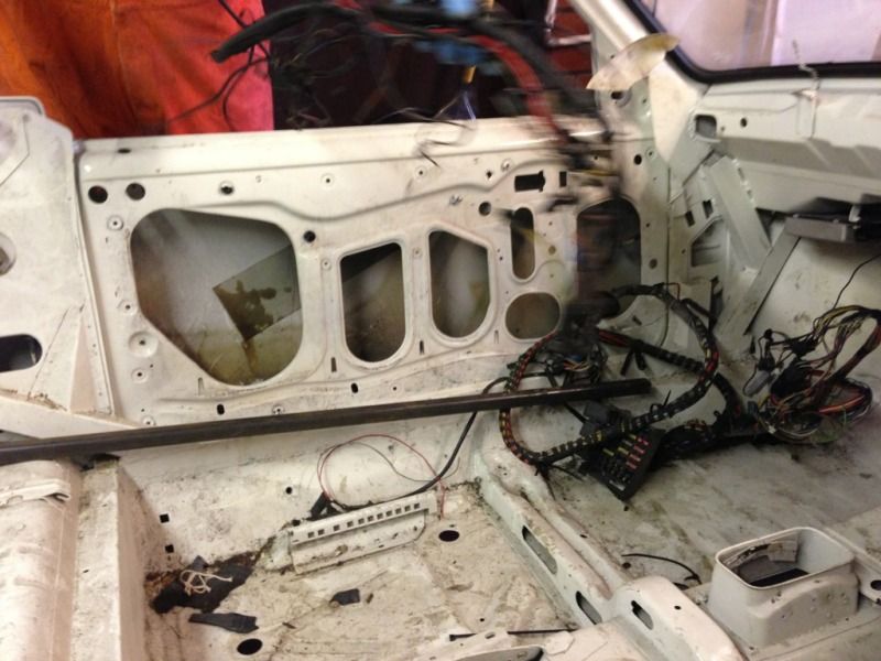

http://i15.photobucket.com/albums/a3...285D39F1C1.jpg

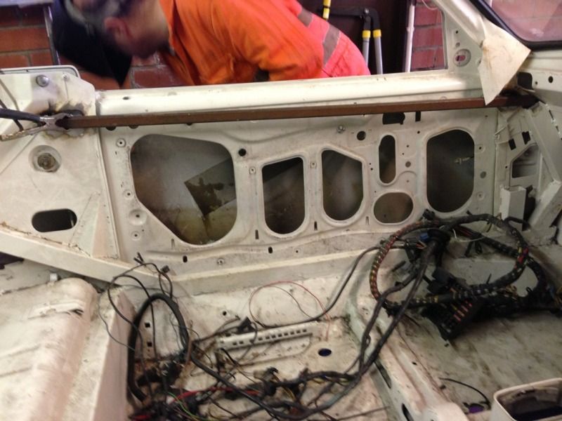

http://i15.photobucket.com/albums/a3...2865CC06E8.jpg
missed about 3 more bars going in, but this is the first diagnal

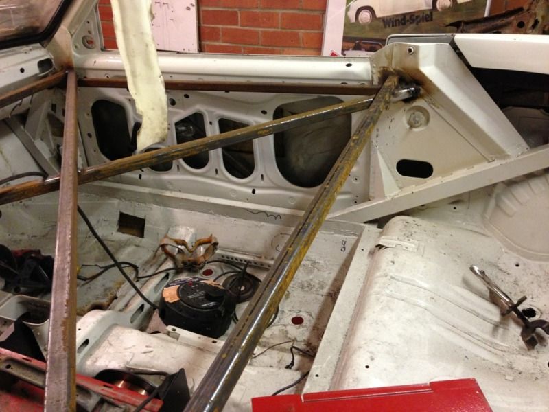

http://i15.photobucket.com/albums/a3...287186CB05.jpg

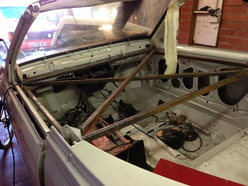

finished
http://i15.photobucket.com/albums/a3...28777D8F64.jpg
http://i15.photobucket.com/albums/a3...288C497C39.jpg
It's not exactly exactly the preatiest job but its coming back out in a few months

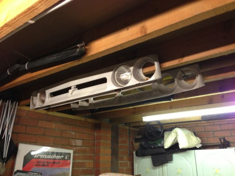

And a few bits put up high out the way
http://i15.photobucket.com/albums/a3...289AA900F7.jpg
