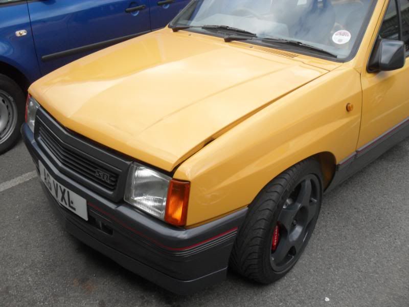

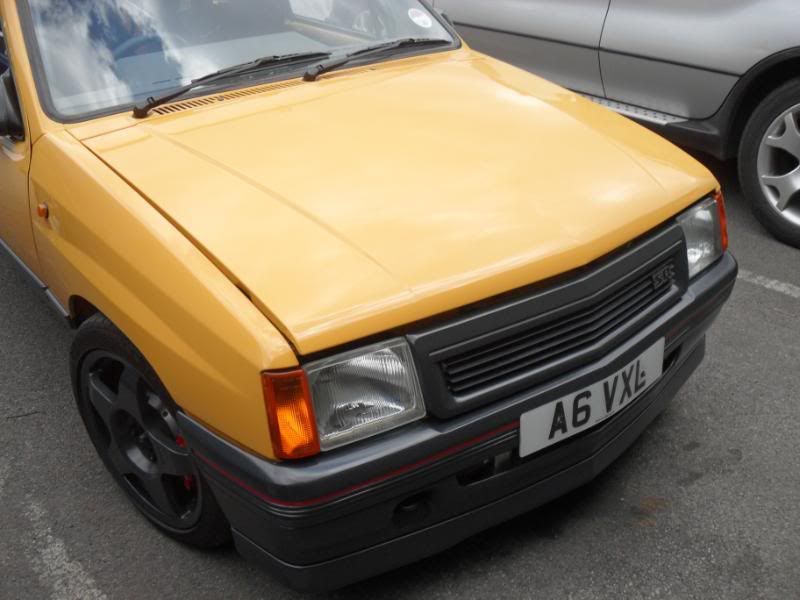

Unfortunatly not a great deal of work has got done on the nova this week. New injectors turned up and were fitted which did sort the issue it had. Car now runs fine and most of the work is done. The wideband gauge just need wiring up to the sensor which is already in place so they can look at what information its showing etc. Apart from that the linkage also needs setting up but that shouldnt cause any bother. I dropped by after work friday and fitted the front bumper,headlights and grill then placed the new tax disc in the window so when they test drive which will be pretty soon its all legal to do so etc. Few pics of how it now stands........
http://i84.photobucket.com/albums/k2...bowip197-1.jpg
http://i84.photobucket.com/albums/k2...bowip198-1.jpg

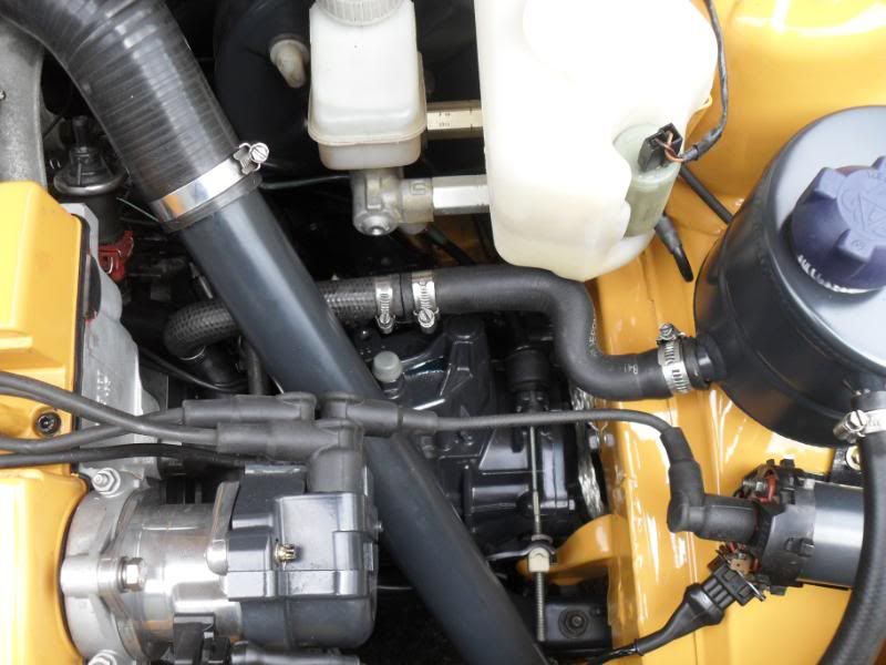

I also got a quick shot to show how subtle the box looks in position. (Note fresh new earth strap too!)........
http://i84.photobucket.com/albums/k2...bowip199-1.jpg

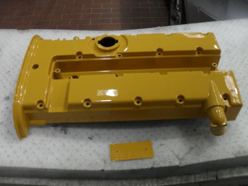

Apart from the above I havent done much as Im waiting on the cars return. I did however paint a few more bits.......
http://i84.photobucket.com/albums/k2...bowip195-1.jpg

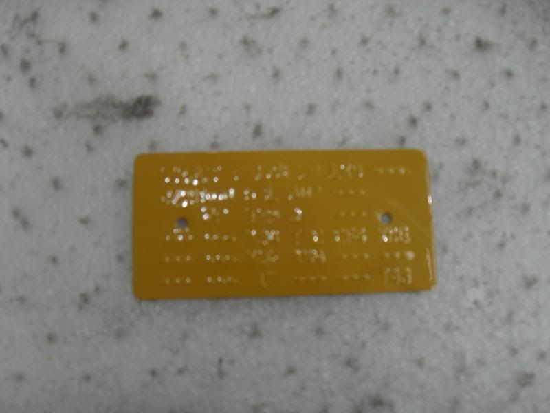

My other rocker cover had cracked its paint around the bolt holes which was strange as with the way I prep that doesnt usually happen but Im pretty sure I painted the previous one twice which means their was probably double the amount of material on their than they should have been which is why it may have happened. Either way the above one was stripped to the bare bones and only painted once so fingers crossed it wont happen this time! As for the chassis info tag you could hardly make out the lettering due to also having too much paint on. Again this was fixed by stripping all the paint off and starting a fresh. You cant make it out very well from this picture but you can actually read it now! lol

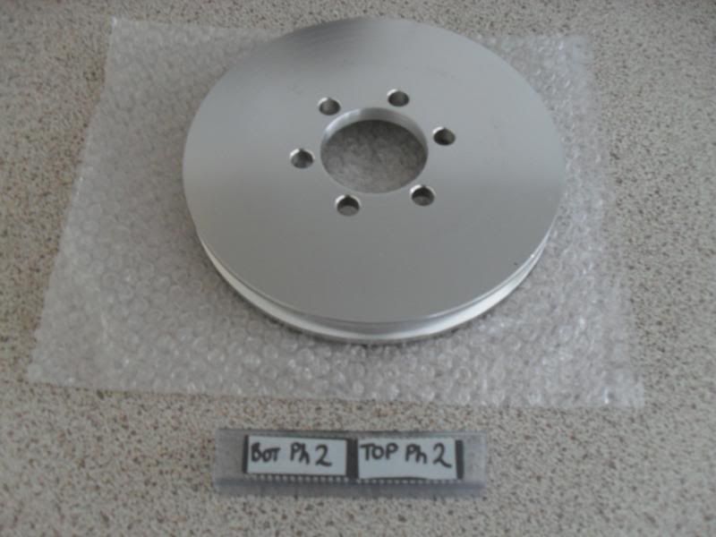

Lastly it was noticed my bottom pulley was wobbling around a bit more than it should so I ordered a new billet one to sort this. I also got in touch with beardy for some of his phase two chips as a back up plan. Just in case the map shows to be poor and I have no time to source anything else before billing etc. Keith has ran them without issues for some time now so they seem a safe bet. If my current ones turn out to be ok however I can always just sell them on. ........

Your coil lead is very short, why is that? Everything looks fantastic, nice work.
