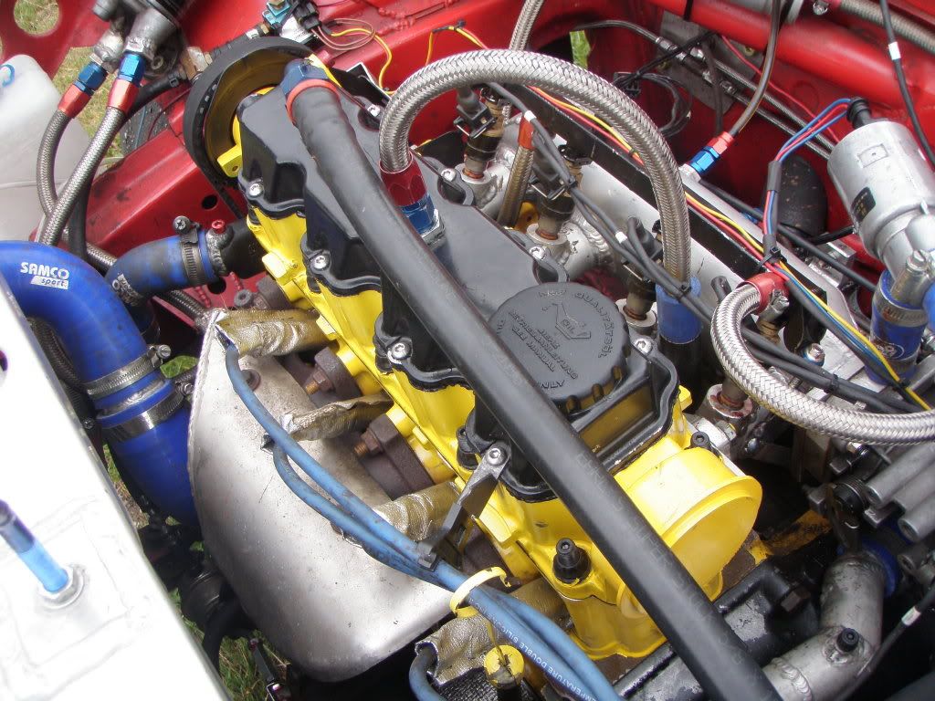

Just got my Nova back after the engine rebuild;
http://i285.photobucket.com/albums/l...ort/001-16.jpg
http://i285.photobucket.com/albums/l...ort/002-49.jpg
It's had a new set of rockers, new valves and guides, new valve springs.
And as you can see it also now has a new vernier pulley, and a stud/nut conversion in place of the normal head bolts.
All seems to be running well, but the proof will be when I use it in anger at the end of the month.

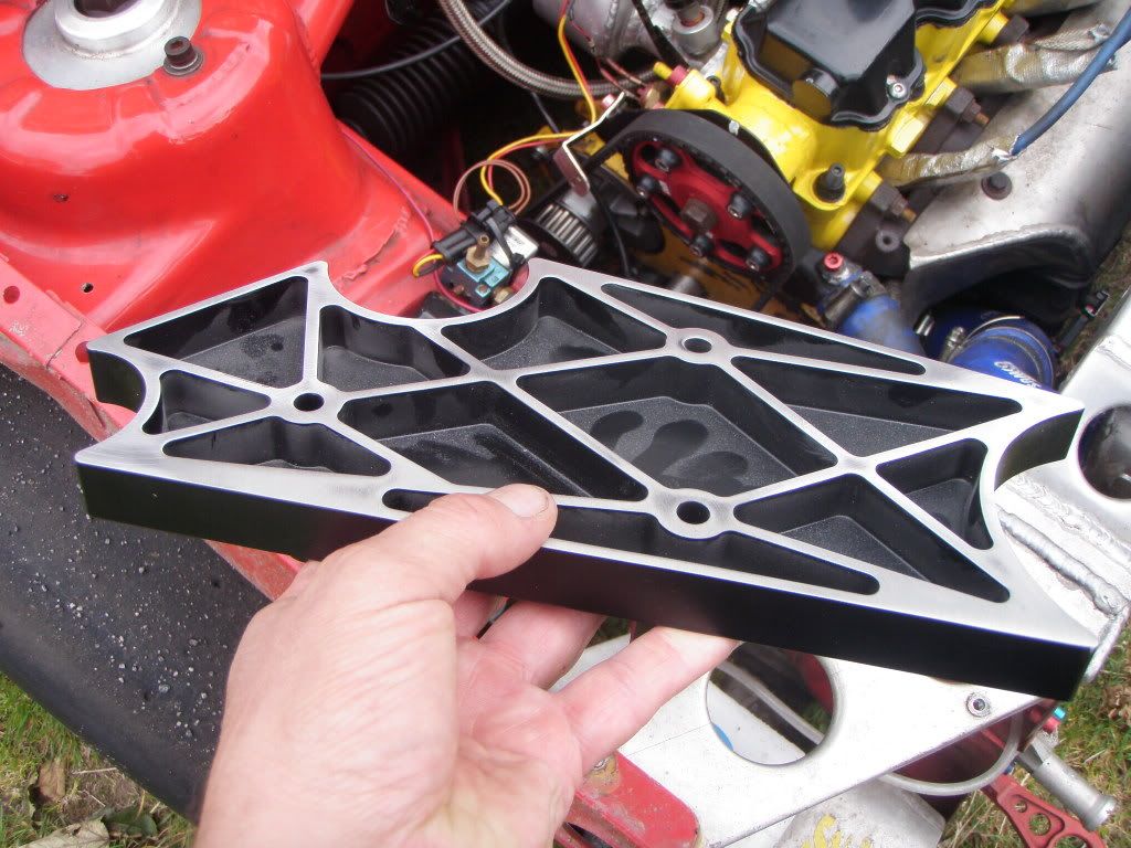

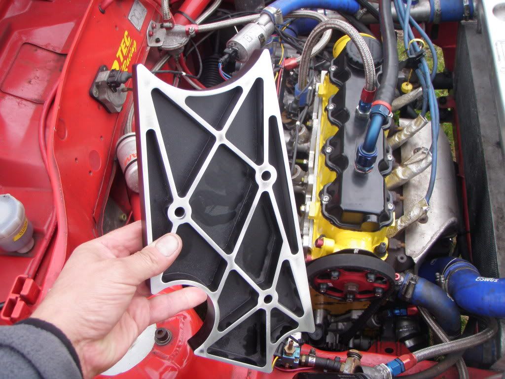

I also got hold of a rather nice looking 'insert' that sits inside the cambelt to stop any foreign bodies getting in there (Swindon used to make a similar thing for the XE engine in the Supertourers);
http://i285.photobucket.com/albums/l...ort/004-43.jpg
http://i285.photobucket.com/albums/l...ort/003-52.jpg
Unfortunately it won't be easily fitted to my engine, as I have a crank sensor in the way! It's also a bit on the heavy side being machined out of aluminium, so I think if I pursue this one it will have to be moulded up in plastic.

There's certainly a 13s run in the car as my launches were absolutely awful on the day. But at least it proved that the engine was working OK (although it sounds very rattly with the solid lifters in it, which I'm a little concerned about).

Solid lifters should be reasonably quiet if the clearances are correct, in fact I know of an engine builder that runs about half a mm clearance on really lairy cams and says thats silent. Is it still on the same pistons? Forged pistons tend to make a slightly rattly sound when cold as they expand more than cast, so run bigger clearances.
