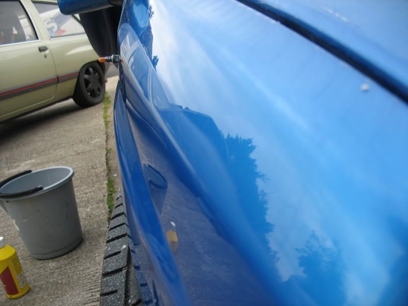

smooth Benn goes more smooth. really like the clean space down the side, wish mine was smooth!
