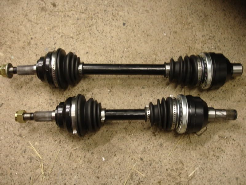

well ive decided to go with eaqual length shaft setup and grp a hubs as im unsure the cvs will cope if i use the 22spline nova gte shafts, knuckles are currentley away being machined for the bigger bearings so hope to have them back soon
also thanks to brucer for the shaft that mates up to the dummy shaft
pic of shafts
http://i127.photobucket.com/albums/p...w172/013-9.jpg
Im still not convinced it make much difference if you have a good clutch and diff, as i see it as another joint means anorther weakness?
But big block/shafts are a better option IMO.
I found it took almost all sideways pull away when booting it.
well ive got shafts painted and built up now
http://i127.photobucket.com/albums/p...172/001-46.jpg

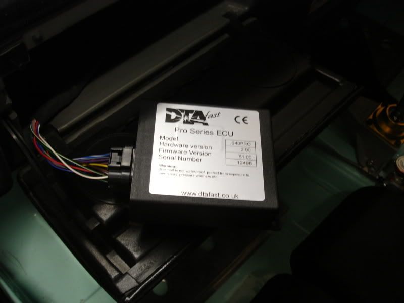

ecu has arrived too
http://i127.photobucket.com/albums/p...172/002-46.jpg

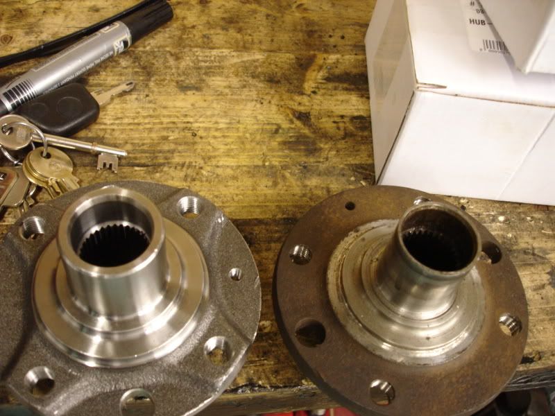

and my new hubs have also arrived, so much stronger when there un machined, pictured beside a machined one that was on the car previously
http://i127.photobucket.com/albums/p...172/003-43.jpg

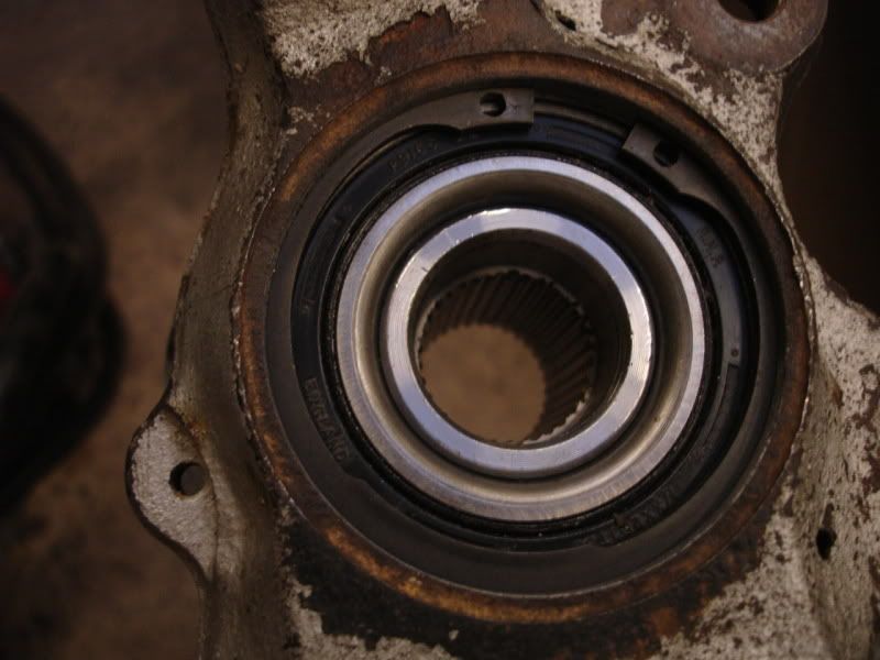

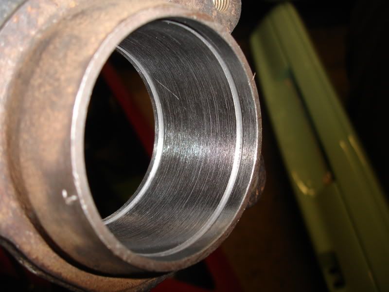

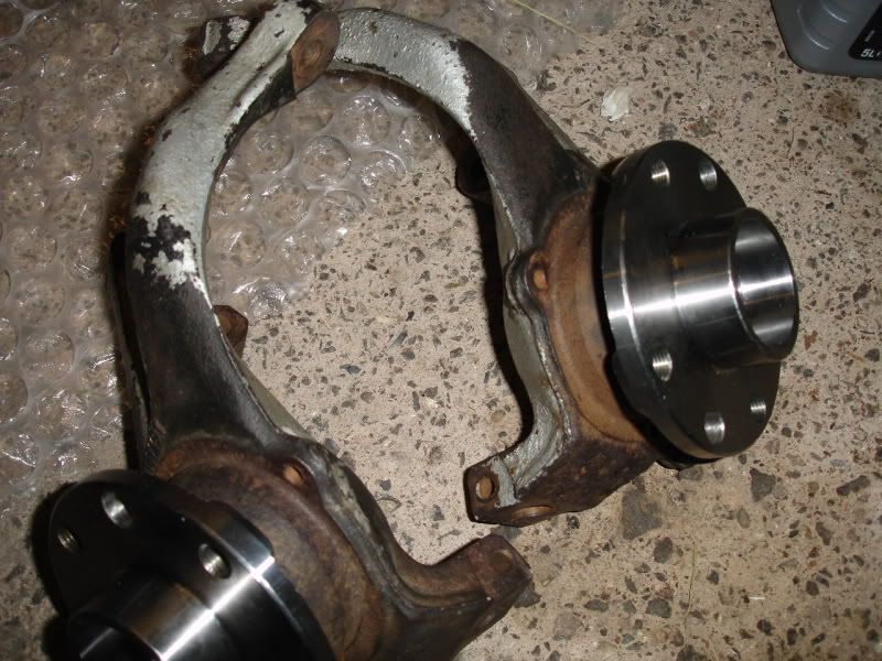

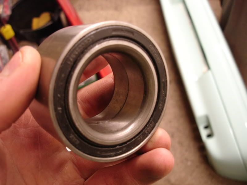

got my knuckles and new hubs back, well happy with them
http://i127.photobucket.com/albums/p...172/002-47.jpg
http://i127.photobucket.com/albums/p...172/005-31.jpg
nice new bearings

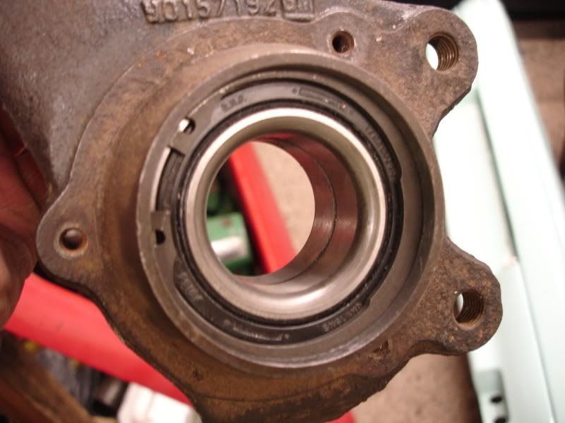

http://i127.photobucket.com/albums/p...172/006-35.jpg
and pressed in

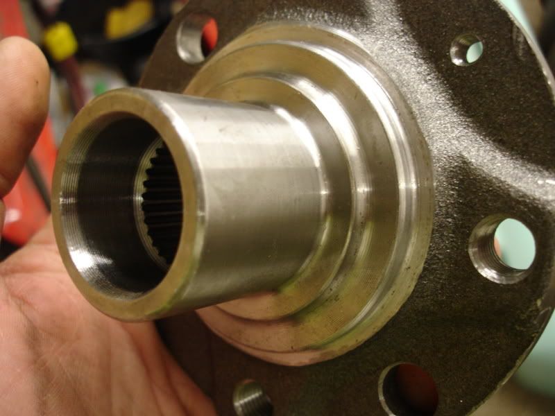

http://i127.photobucket.com/albums/p...172/007-25.jpg
and hub pressed in
http://i127.photobucket.com/albums/p...172/010-17.jpg
http://i127.photobucket.com/albums/p...172/013-10.jpg
thats the full setup ready to be bolted up to the nova

If hubs are machined correctly, you shouldn't have a prob. But again good work Matt, really wanna see this car in the flesh.
I have first hand, very scarey. My mates Corsa broke one in about 500miles(Mtec stuff) mine which are machined the right way have been fine for 4/5 years...
