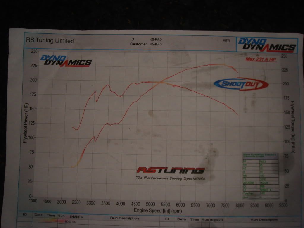

How was the dyno calibrated for the run, any ideas? as if the torque is correct, but BHP massively down it points towards the RPM calibration being out, unless it's seeing a large enough air restriction to strangle the flow for top end, but that's fairly unlikely.
Is there a pic of your bay with filter etc in here somewhere? I've not seen one but I tend to be a bit erratic on here the last year, I'll trawl through if there is one lol Main tell tale on your dyno printout is if the redline is a bit early, it's probably been calibrated a bit out.
Power = Torque x RPM, so if it thinks you're revving a bit slower than you are, the torque will be spot on, but it will calc your power a bit down on what it actually is.

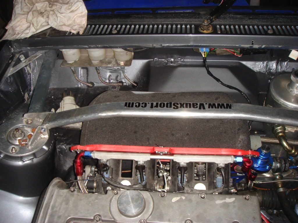

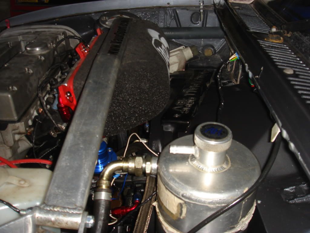

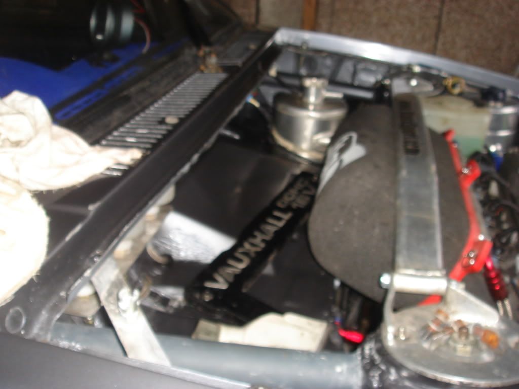

Pics of filter sorry if there a bit crap ive just braved the garage to take them.
http://i761.photobucket.com/albums/x...0/DSC04278.jpg
http://i761.photobucket.com/albums/x...0/DSC04282.jpg
http://i761.photobucket.com/albums/x...0/DSC04279.jpg
Also pics of the power graph sorry again if its a crap pic ill try and scan it if people dont get the idea
http://i761.photobucket.com/albums/x...0/DSC04285.jpg

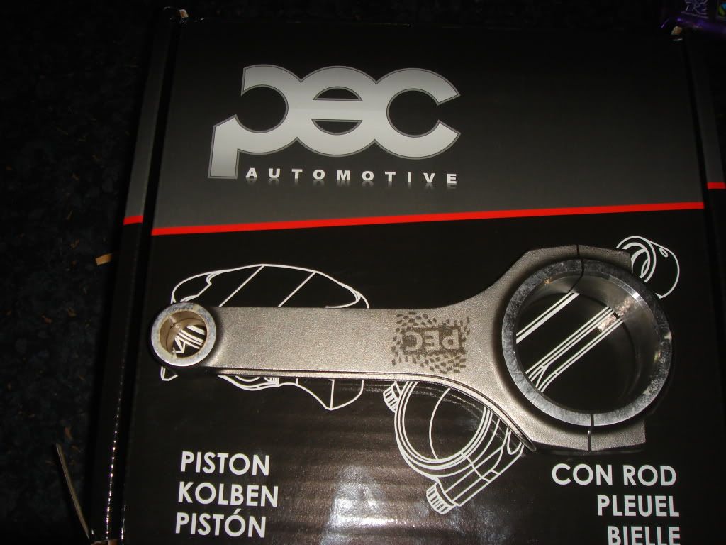

Also I must say a HUGE thanks to Dave at PEC (performance engine components) i phoned him and told him what id done over the weekend and he gave me a really good discount on another set of rods, its nice to see some companys will still help you when your luck is ****.
So these came in the post
http://i761.photobucket.com/albums/x...0/DSC04286.jpg

Shouldn't have too much issue with your filter setup, used by plenty of people. It may well be pulling a lot of hot air straight off the exhaust though, that will definitely drop the power a surprising amount.
On the power graph, any idea where your usual redline is? it doesn't seem quite as much as 20-30% out though tbh.
