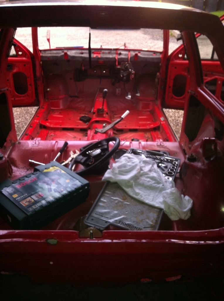

Yep straight at it to make a dent then angle to undo it so on pass side then hit it towardsthe front
Once it's lose use mole grips
Doors are a pain if you keeping them give them a good coat of wd40 then hit them with the heat
You will prob burn the outer part of the door and just heat the door hinge not the shell make sure ure new pin is in and wack it while hot. If u heat the hinge on the shell you may distort it as there a pain to get goig. If ure scraping the door open it up and grind the outer skin. To get. To the pin better and start it with a punch from above as once thefe moveing will go easy
bout
Eventually got it off! I drilled a hole in it do the chisel would sit at piece then it moved with 1 hit :)
Yeah I'm keeping the doors there in great condition, I'll have to get the doors off another day though I made my pin slightly too big. I threw the original one out so just had to guess the size.
So looms free now? Trust me cutting is a pain as proven last night trying to wire up a bay after years of bodge
I've not done it but have seen people list useing the bonnet stay as a long punch but 8mm bar would do the same and if you turn a nipple on the end even bettersas it will hold it in the centre of the door pin.
If ure keeping them I would try not to use any heat its never the same door after you burn them
Yeah all wiring is out the car and none of it had to be cut :d

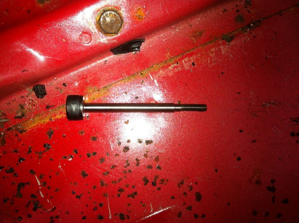

Heres the pin I made today aswell, I'll take a .02" skim from it tomorrow and it will go in, fingers crossed it can get them out.
http://i660.photobucket.com/albums/u...ps8f30bfe8.jpg
My we pin remover done the job :) got the buggers out just now!

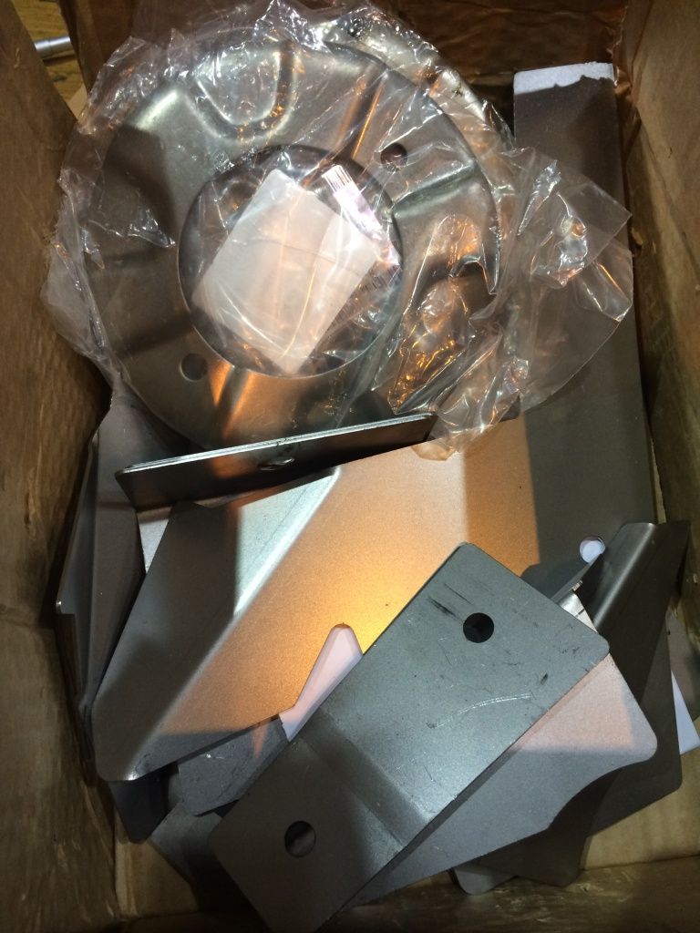

i got this 14 piece plating kit today, I don't need the strut plates but came with the kit, also got an f28 gearbox mount today.
the bodyshop my car was supposed to be going in still haven't phoned me, so Scorge spoke to a guy he knows for me and it's going into his shop instead now. I think the car is getting picked up from my lockup this weekend :)
Sherm will buy strut plates off you bud as his don't have them ;)

Why not fit them Bazza?
What the strut plates? It's a gsi bud already has them :)
The new ones ure not useing on it the ones in the box

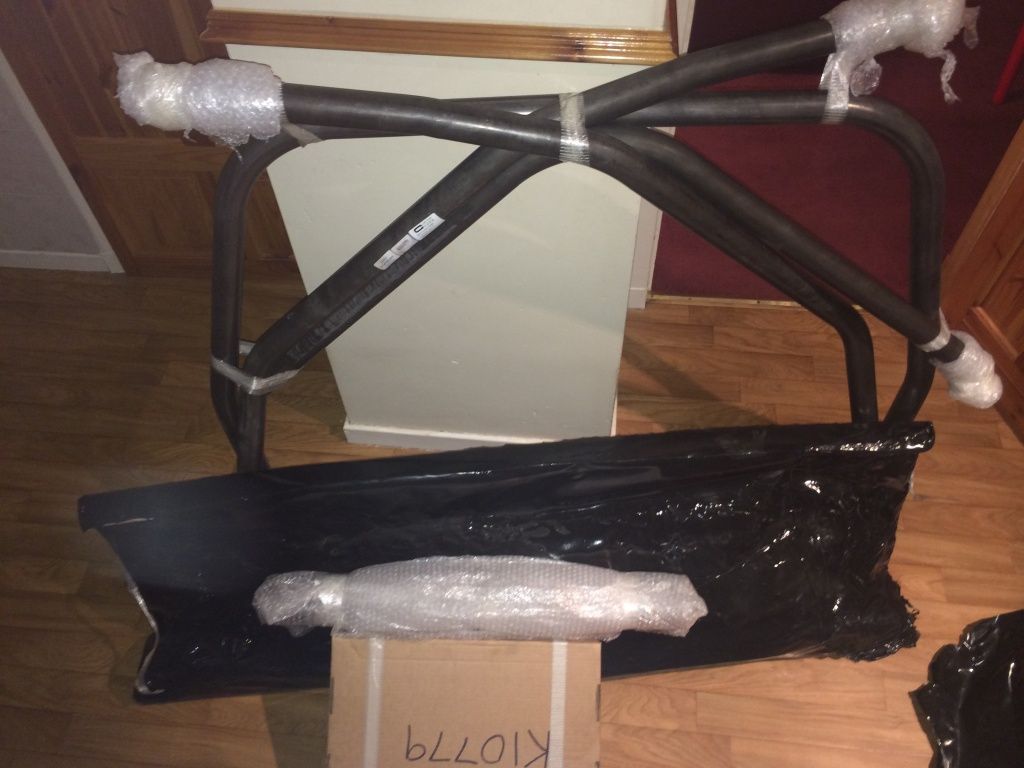

My new cage turned up today :) it's a t45 multi point one all the other bars are in the black bag which I couldn't be bothered to open lol
http://i660.photobucket.com/albums/u...ps43a90035.jpg
How heavy does it feel?
Mmmmm t45 :thumb:
Nice one mate :)
its 38kg excluding the seat rails so prob around 40kg or so

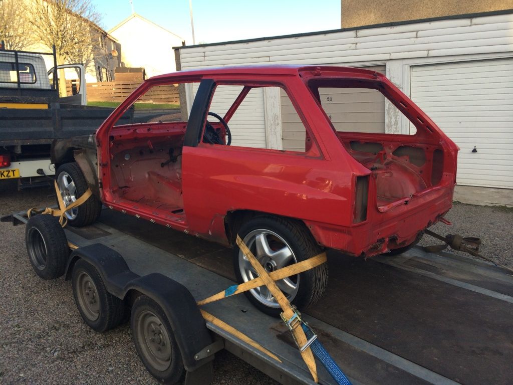

That's her finally away, thanks to scorge for picking it up for me!
http://i660.photobucket.com/albums/u...ps227e0d30.jpg
http://i660.photobucket.com/albums/u...ps4da50489.jpg
Progress! Yay! :thumb:
I cant wait iam waching :)
Looking forward to it mate :)
Is that her off to get painted mate? About f***ing time lol
Thanks Dave and dc :)
lol nope painting ain't happening yet, I've got a new front panel, rear panel, sills, plating kit to be welded on and get it all seam welded and cage welded in and fix the rotten bits etc then it will be getting painted lol I think the roof and quarters will be getting cut off before paint as well, I'll have to have a word with them about that.
