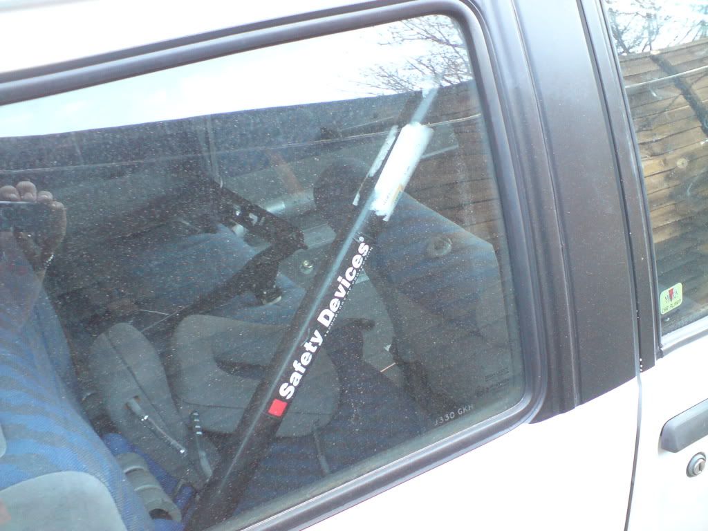

    Had this car since november and been doing this for a while now, but thought i would put up a thread.
    when i bought it it looked like this (with no tax or MOT)

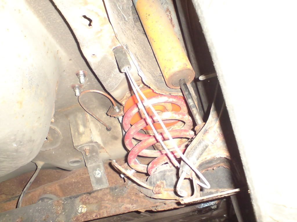

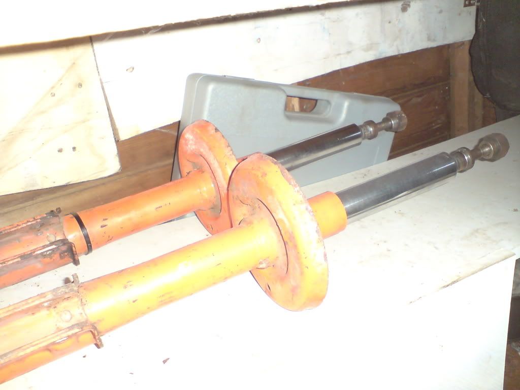

    it already had the cage installed and the front panel has been completely replaced. The only rust was a bit in the engine bay and just on the drivers door just showing through on the pic. It also had the rear beam chained, upside down billes & gravel springs on the rear, Mk2 forest springs on the front and a full set of polybushes fitted.

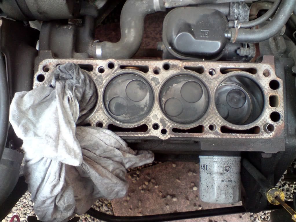

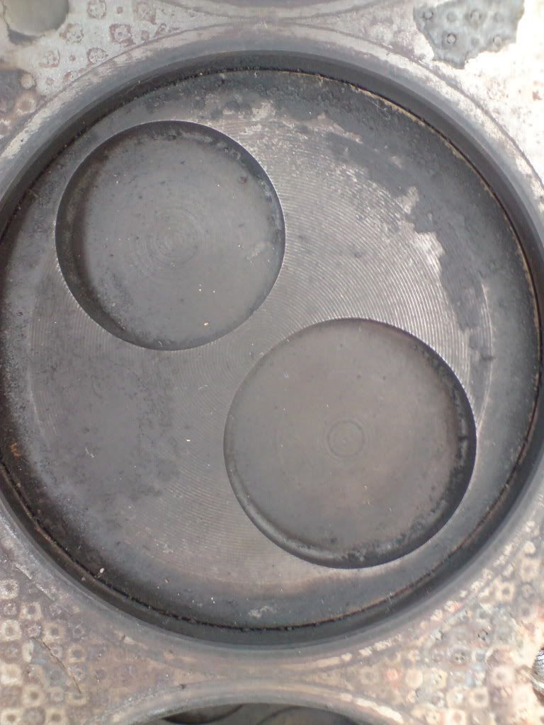

    it just scraped through on emissions and brakes(see above) and kept dropping a cylinder or two. it was diagnosed as a possible head gasket or just crap in the engine. ran it for a while as it go better but sure enough a month or so later this happened
    damn...
    time for a new head gasket... oops...

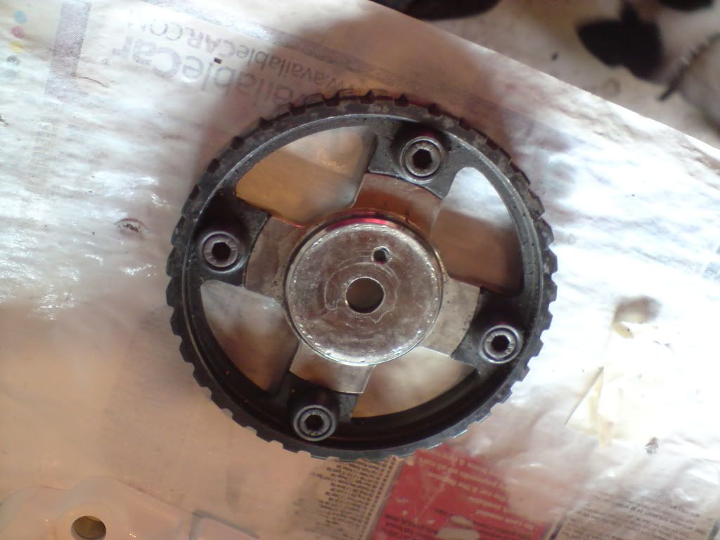

    a vernier pulley,

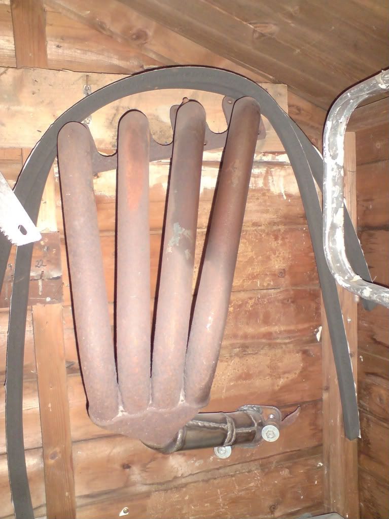

    a 4 branch manifold,

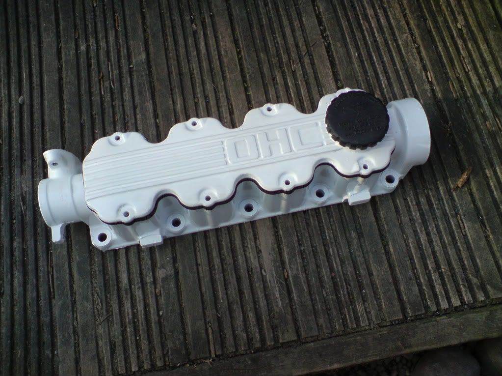

    oh and painted the cam carrier and cover white ( both because i am a bit of a bufty at heart, and it also helps to detect oil leaks)

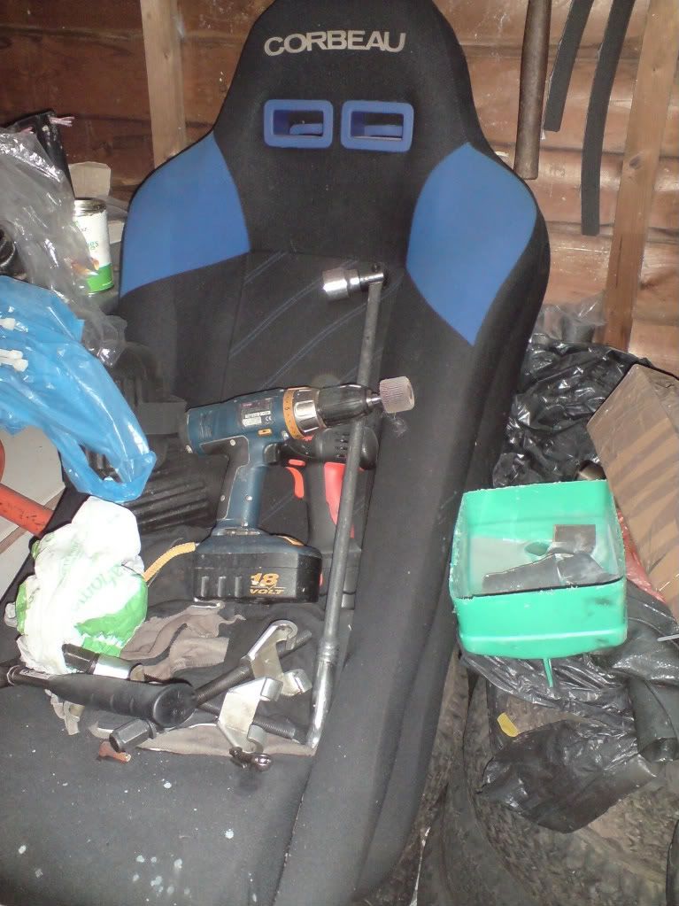

    Bucket Seats & harnesses (excuse the mess but you can also see a set of knobblies down to the right)

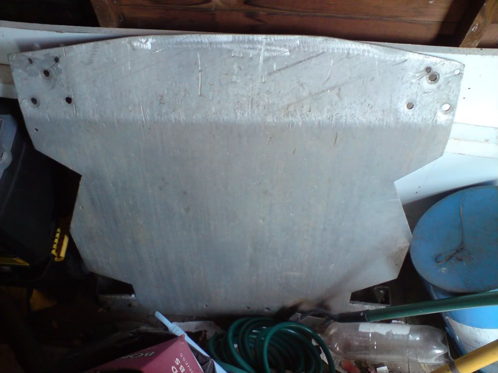

    An 8mm sump guard (derbyshire lanes can be harsh!)
    along with running the fuel lines in the car and then getting a hydraulic h/brake its almost there. and believe it or not i have spent under a grand so far including the car! (although only just) :D

    cheers. you have no idea how much work went into that... . a first set reacted with something and wrinkled up, so it got stripped off, then the next set ran, so was rubbed down and now finally this! phew!

    Im liking the head and cover :D

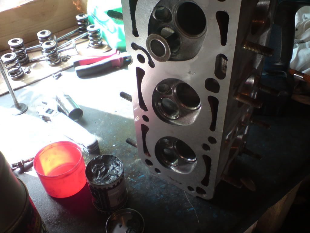

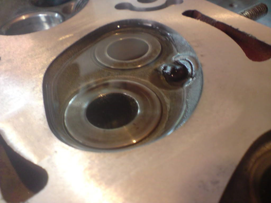

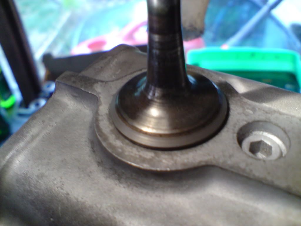

    Have spent most of the day lapping in valves for the head...

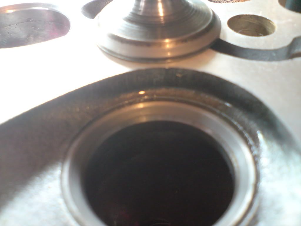

    i did cheat with these and use a drill... as a result they have come out quite dull, with visible score in them... will have to get a new sucker and finish them by hand tomorrow...
    was advised to fill the recess with parafin, as this is thinner than water and will detect the leaks better. none lost any through the valves, but is better to be safe than sorry, so want to finish them for piece of mind.
    if you look closely below, you can see the marks left by using the drill... a really good contact area, but just too ragged for me...

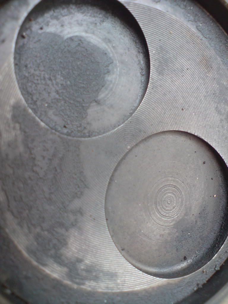

    whilst i was testing the head, i set about cleaning the coke off the top of the pistons - i wiped them off with some thinners and a rag with the intention of wire brushing the tough stuff off, but there was very little, so i am not goint to bother risking damage to the bores.
    more updates soon as work commitments & money have dropped off, so have more spare time to do things with all the parts i have... .

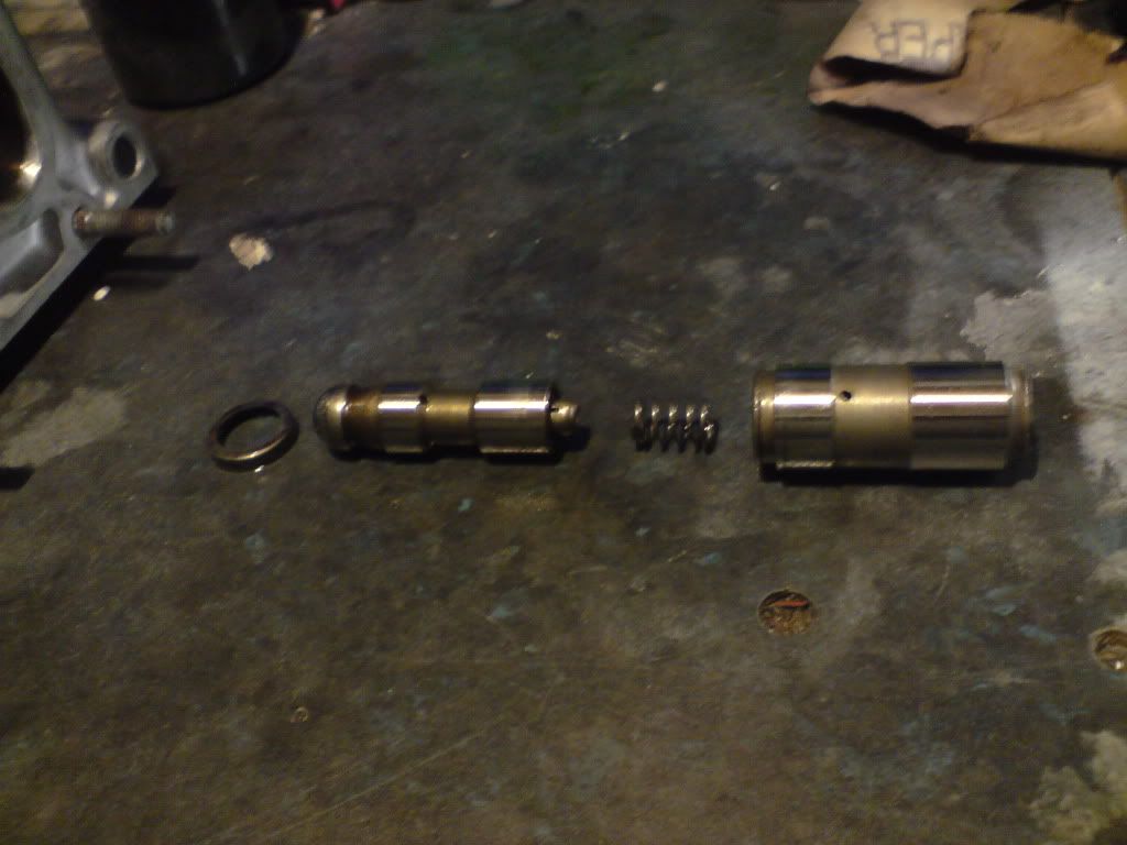

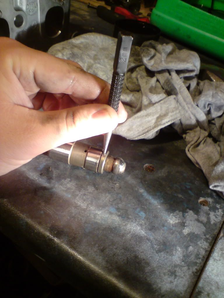

    once i found a spare minute or two, i stripped the lifters out and cleaned all the gunk out of them.
    i then re-punched the retaining collar to ensure they wouldstay on!
    However... i have come up against one problem.
    i did originally think that the scores round the valve were just the way i had lapped them in, i.e. with a drill. However i got a firend on the case who knows 8v engines inside out, and he thinks that the hardness has worn away from them - basically they are scrap... GUTTED! and to top it off im skint...
    so Anyone with a 12st complete head or valve set - would you mind donating the valves to a worthy cause??
