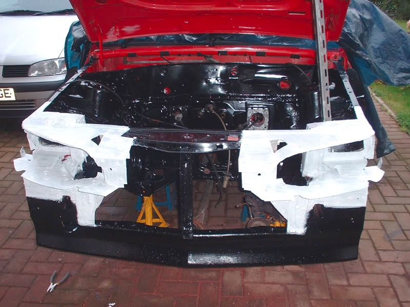

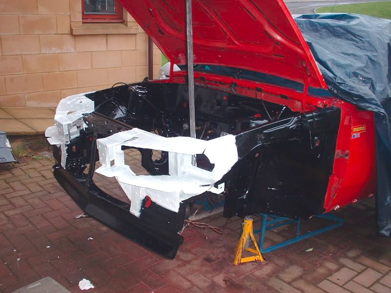

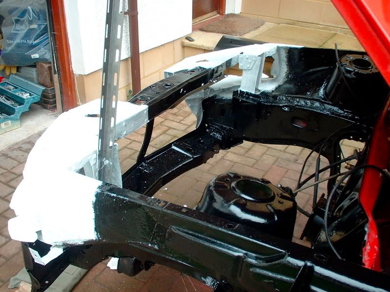

    So - armed with one gammy ear, I headed back to the garage. Weather a little overcast but not raining - yet - so decide to start by applying another coat of paint to the engine bay. This takes a couple of hours and I give it a thorough covering using a stippling motion to ensure it settles flat. Once done I then paint the light housings with special metals primer.
    The black area has come out really well - I just need to do the battery area however need to treat the drainage holes before I can do this so will leave till another day. The special metals paint takes about an hour to go off and can be repainted over after 4 hours - leaving me plenty of time to get on with other stuff - such as my boot.

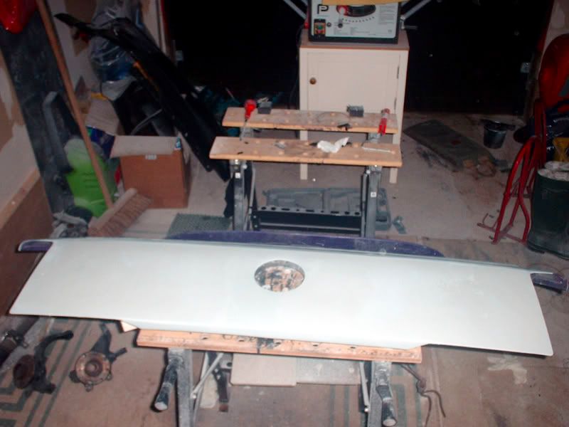

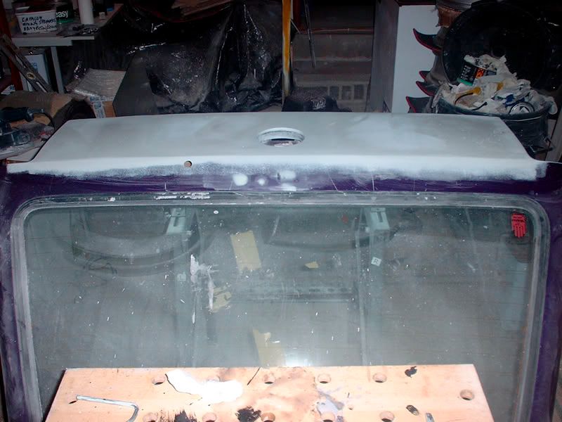

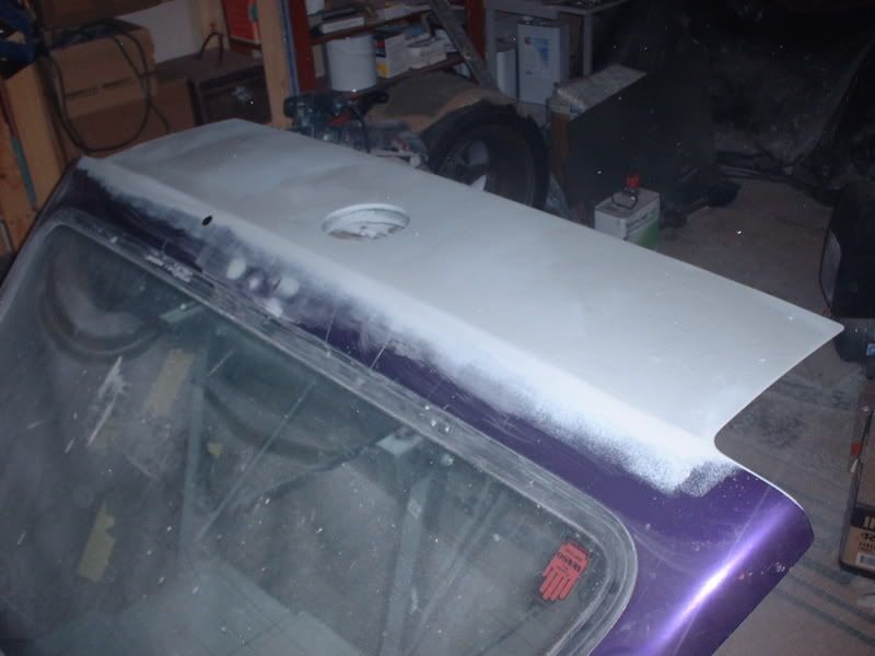

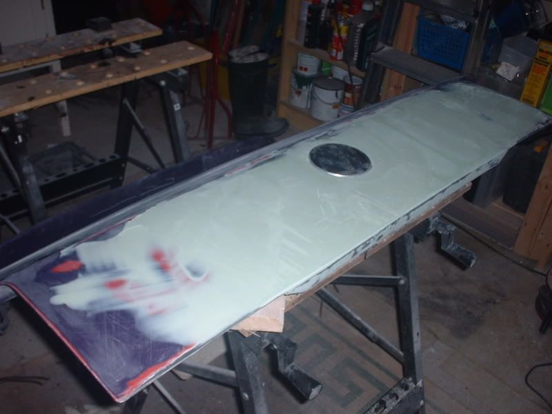

    I gave it another couple of coats of filler sanding down in between coats and after a few hours hard sanding, its starting to level off. This pic shows the badg mechanism in place - its very tight but thats okay as it can be sanded back later -
    After a really good sanding back and smoothing with finer paper, I applied the 1st coat of primer to get a better idea of how it looked -
    This looked really good and seemed to be very level however if you run the flat of your hand over it (using a jay cloth between palm and surface), you can been rises and falls in the filler - not many but enough to warrant further work.

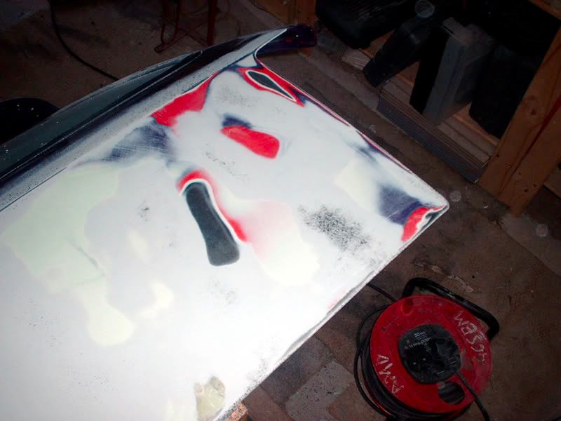

    Once the primer has cured (overnight), I'll coat the whole area in a fine "speckle coat" of black paint (like an over spray of paint leaving a fine dotted finish on the area) and then sand this back using a large flat piece of wood with wet n dry on it. The low areas will not be removed and the specks will remain showing me where I need to build up the filler.

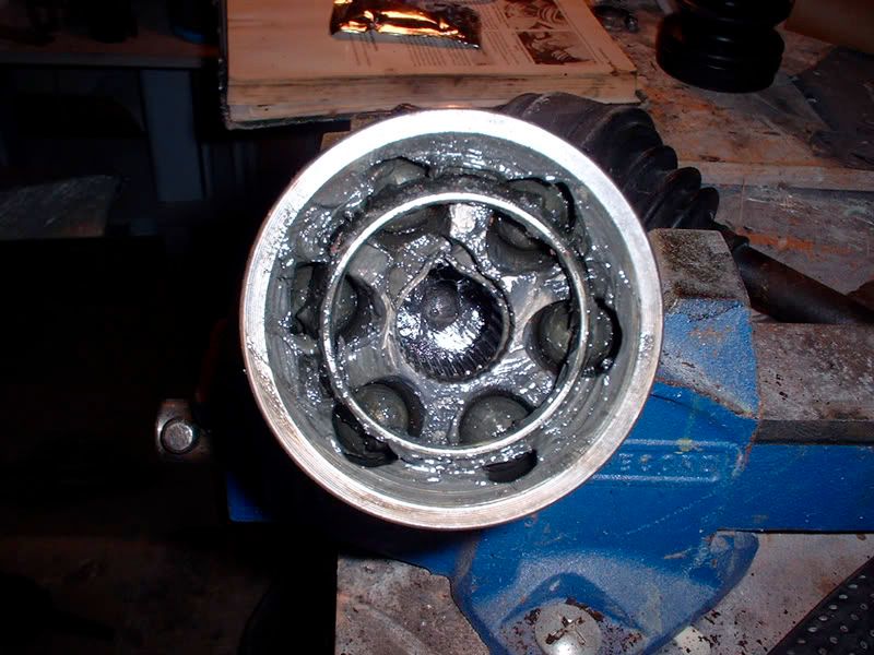

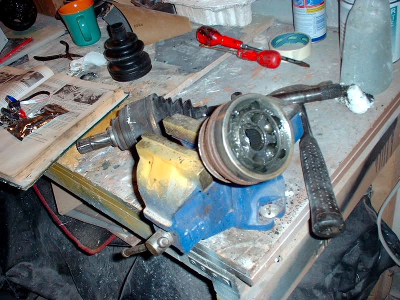

    Whilst the primer was curing, I got on with trying to replace one of the inner cv boots on my replxacement GTE drive shafts.
    I had a replacement boot and using the haynes manual successfully separated the cv joint allowing me to slide the old boot off. The boot itself wasnt worn or torn, it had just popped off the fat end and was spewing grease everywhere. I'd actually like to reuse this boot if I can (see post in technical re whether this is possible). Separating is fairly easy - just a c clip holding the 2 in place
    Anyway - once apart I slipped the new boot on and then had to leave it because I dont have the metal securing rings (theres some in the post from a fellow Novaloader that will hopefully arrive tomorrow).

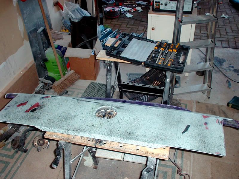

    Started by applying the speckle coat to the boot -

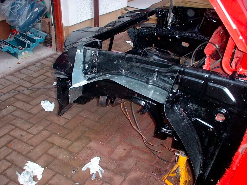

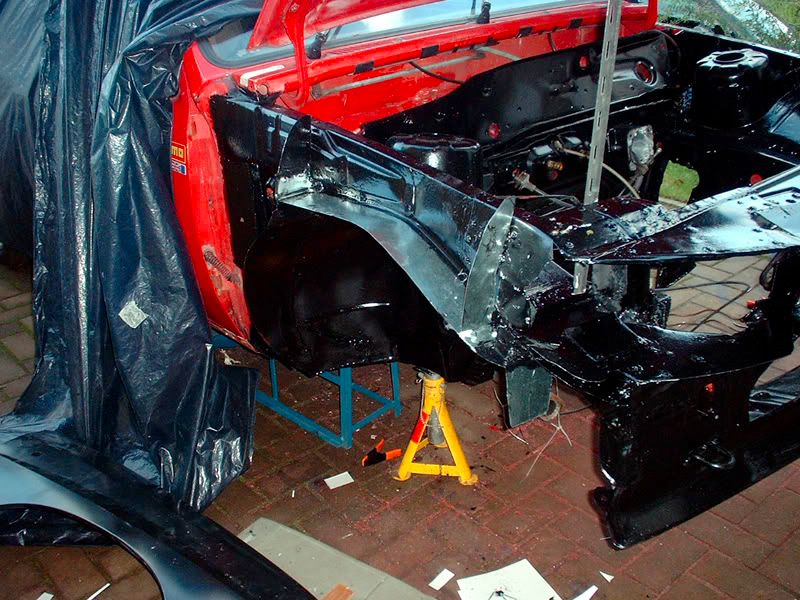

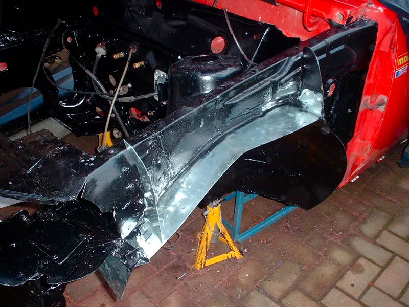

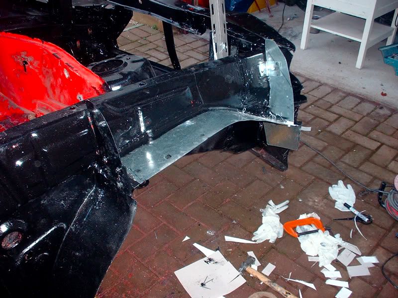

    Whilst this dried I painted up the other light housing I couldnt get done yesterday due to the misty rain and then started work on making some inner mud guards for the front wings.
    The idea is that behind the nova front wings is nothing except inner wing - and this leaves them prone to the elements from the wheels, mud, dirt getting behind the lights etc. So I decided to try and limit the amount of build up by fitting some splash guards. most modern cars have them now (usually great big plastic cowlings that hide all the moving parts).
    I started by making a card template - the template can be used on both sides - I just need to reverse it. The splach guards will be rivetted to the underside of the inner wings and joined to the new inner guards at the back of the arch I had welded in a while ago. The front of the guard will bend downwards but not all the way - just enough to act as a drainage channel for water etc. At the top I'll then make a replacement guard that usually sits behind the lights on the nova. This will be attached to the front and attached the the inner wing at the front - efffectively making a box.
    Heres some pics of both sides -
    from underneath (looking up at the strut turret from underneath)
    Theyre a nice snug fit at the front with about a 10mm gap between the wing and the edge to allow for air circulation, drainage etc.
    I've used galvanised steel so theres no problems with rusting and the whole thing is sealed with sikaflex which is used on marine crafts so very water resistant.

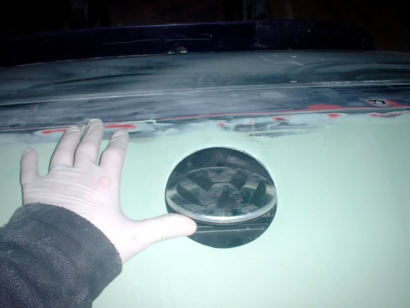

    Once I'd finished this, I then moved on to the boot (again) - started by sanding down until the flat spots were shown like the one below -
    Then skimmed these areas with filler and repeated the process again.
    The boot is almost complete in terms of smoothing the rear panel - next task is to tidy up the area where the badge will go.
