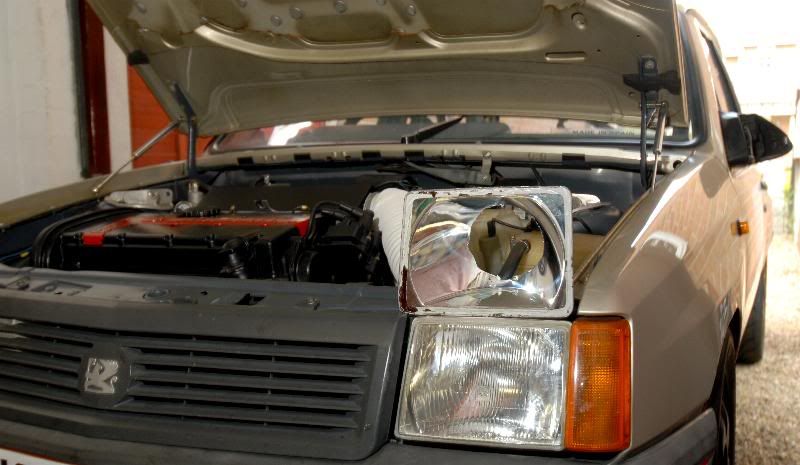

First off, after giving airbox several coats of good ole; satin black, i fitted it, loving how it looks, and I nabbed our tumble dryer ducting which is a perfect fit @ 102mm ID, considering "special air ducting" is £25 per metre, in which I'd need 1.5 metres, which means paying for 2metres lol
http://i136.photobucket.com/albums/q...ure/nc0785.jpg

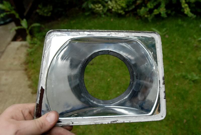

So, I finally got to mash up my passenger headlight I bought from Craig Green ages ago (ta again), so I cut a 100mm hole in the back of that
http://i136.photobucket.com/albums/q...ure/nc0787.jpg

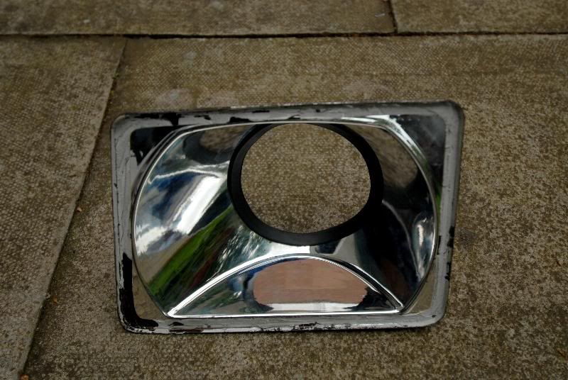

Ran some of my favourite rubber edging around it
http://i136.photobucket.com/albums/q...ure/nc0788.jpg
http://i136.photobucket.com/albums/q...ure/nc0789.jpg

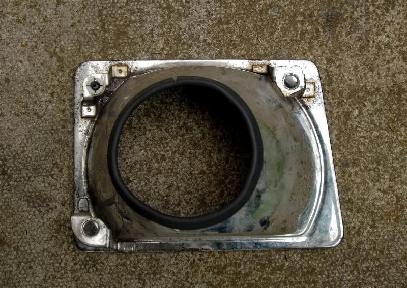

In risk of it coming off, I applied a small bead of clear silicone under the flaps and secured them with clips for an hour
http://i136.photobucket.com/albums/q...ure/nc0790.jpg
All done!
http://i136.photobucket.com/albums/q...ure/nc0791.jpg

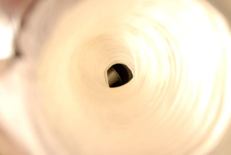

Love this pic looking through the headlight I've made, up the tubing, might make a small sticker for the base of the headlight saying "AIR THIS WAY" and an arrow lol
http://i136.photobucket.com/albums/q...ure/nc0801.jpg

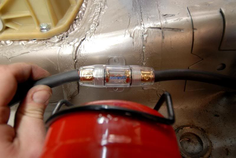

Next up, not many pics as it's just wiring, but this is the said junction block I bought from Halfrauds to extend my 35mm2 wiring to my battery after going to my FIA switch, now runs down the passenger side of the exhaust tunnel instead of the drivers sill

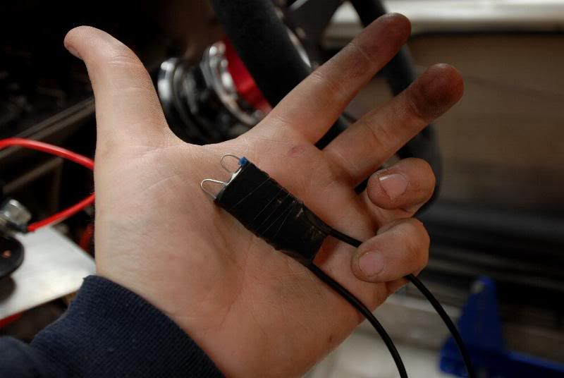

The resistor looked quite dainty and didn't want the wire snapping, so I added bullet connectors and wrapped it black tape so it doesn't get caught on anything
http://i136.photobucket.com/albums/q...ure/nc0793.jpg

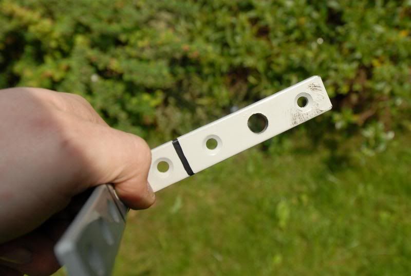

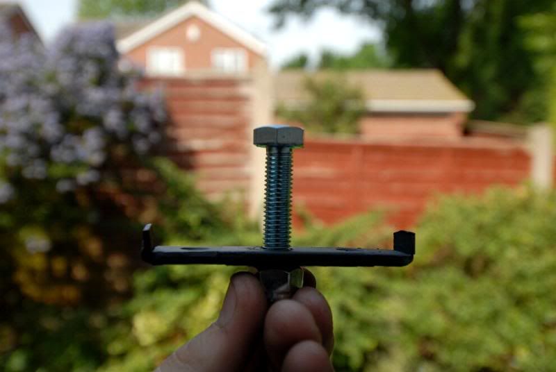

Then onto my rear spring retainers, take a 4mm thick steal right angle 'heavy duty shelf bracket' from B&Q (0.79p), and mark out the OD of the spring (82mm)
http://i136.photobucket.com/albums/q...ure/nc0794.jpg
Drill out the centre hole to 10mm, to accomodate a M10 bolt
http://i136.photobucket.com/albums/q...ure/nc0795.jpg

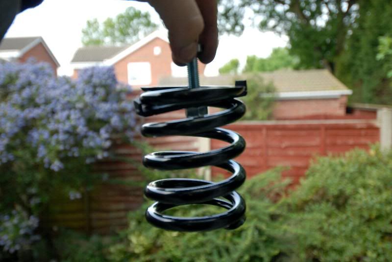

Weld on some 4mm sides to "hug" the spring, so it's seated correctly and cannot slide side to side, and spray matt black, of course
http://i136.photobucket.com/albums/q...ure/nc0796.jpg
Now if you think where my fingers are, on the head of the bolt, this is going to be welded to my chassis and then the nut will be tightened thus holding the spring up to the bottom of my car, I'm aware the Nova rear beam pivots, which is handy because the retainer naturally sits on an angle on the spring, which will allow me to position it correctly
http://i136.photobucket.com/albums/q...ure/nc0797.jpg

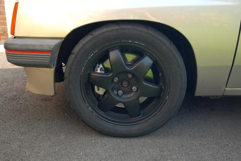

Castor shots
Just some pics of front wheels with castor added
http://i136.photobucket.com/albums/q...ure/nc0798.jpg
http://i136.photobucket.com/albums/q...ure/nc0799.jpg

Nice to see a different approach to retaining the rear springs -
The method I use (And a lot of the rally boys !!) - Cut a section of seat belt webbing - one end secured with a bolt/large washer through the hole in the bottom of the rear beam near the shock mount, the other end bolted via the lip on the rear chassis leg - this restricts the rear beam from dropping too far causing the spring to drop out !!!
