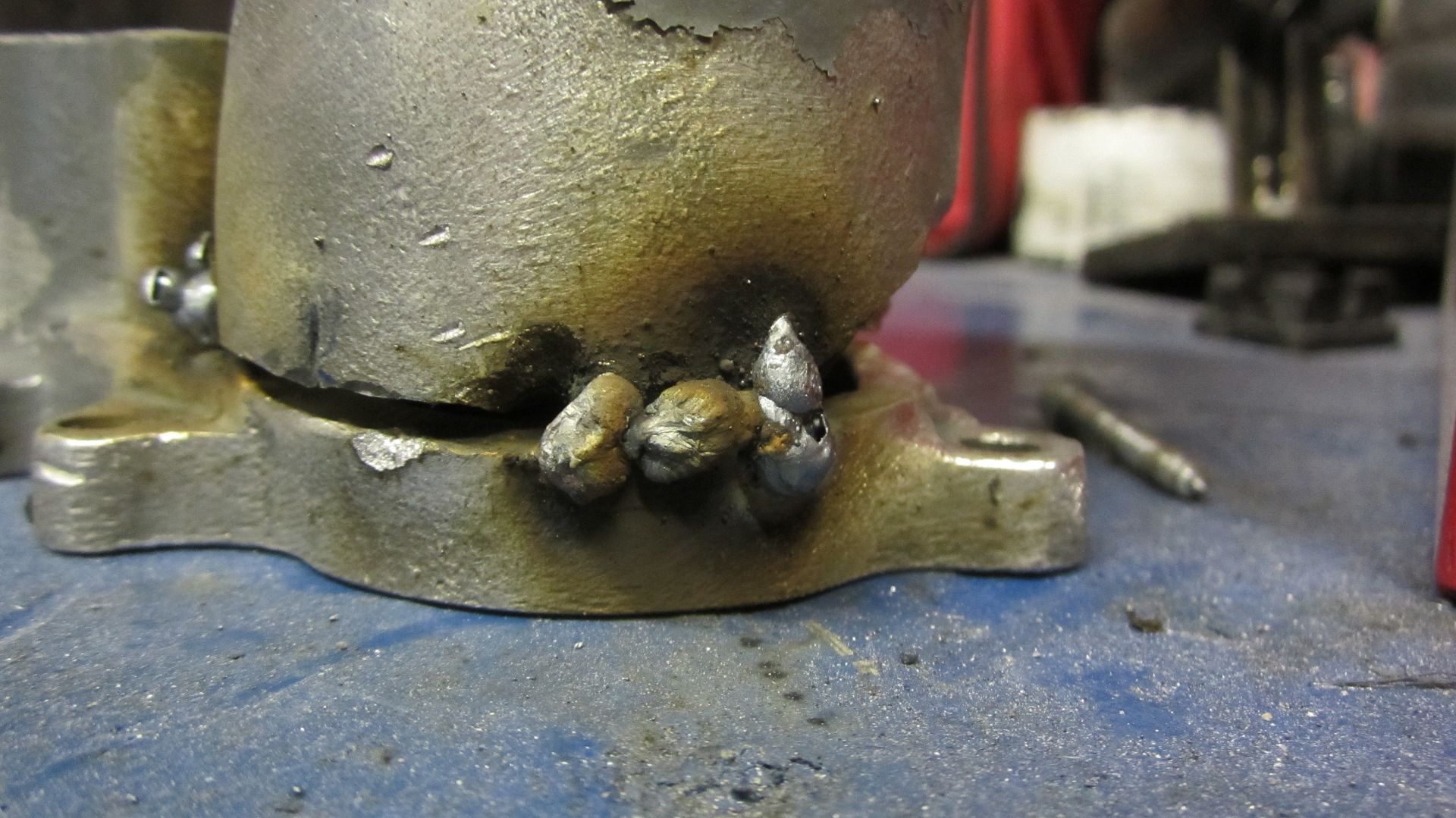

So, my last pics of a inlet tube and new new awesome hole saw! Add them together and you get...
So that fits ok. The other end tho... Eek. After a bit of cutting i had this...
Reason being its very hard to cut this off straight as they are angled up so much and i need it to point down.
Got it to where i wanted it after some messing about, but now i need to get it to stay together so i can go get it alloy welded.
I tried glue.. Wouldn't hold. So i could only try and Mig weld it. Now i know you can't mig weld alloy, but needs a must. I now know why you can't weld alloy with a mig..
After alot of sparks and smoke and a very bad head ache. I ended up with this.
Oh it's not pretty.
But it was holding. Took it to see the man that does all my alloy/tig welding. So did two small welds then flicked off the mig and got it all Tigged.
Tis much better. Temp fitted.
