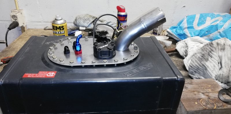

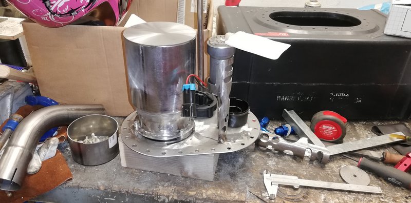

The Nuke CFC and the Radium Engineering FCST are quite expensive for what you get( iirc. 1000 pound for a basic unit with fuel cell but without fuellpumps/ levelsender/ fillerneck-flappervalve etc.).
I have made one myself and the total cost for the parts is around 100pound for the topplate, fullpump mounts, swirlpot, 6pin fuel resistent bulkhead connector, Viton flapper valve and the fillerneck
The (used) ATL fuel cell was around 180 pounds.
It saves quite some money and it is an straightforward job..
https://i.postimg.cc/05Lc9qBk/IMG-20210403-171922.jpg
https://i.postimg.cc/jjmRM5M0/IMG-20210424-170317-1.jpg
Good job on building one yourself, looks good!
