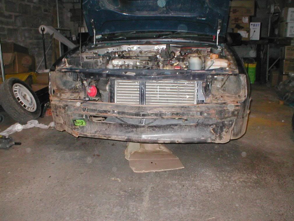

pick her up, get her back to my yard
http://i46.photobucket.com/albums/f1...x/Image008.jpg
when you look closely they painted her a minging purple colour, but when you look under bonnet at turrets it was originally Grey

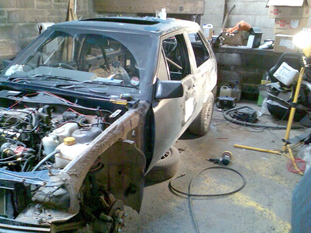

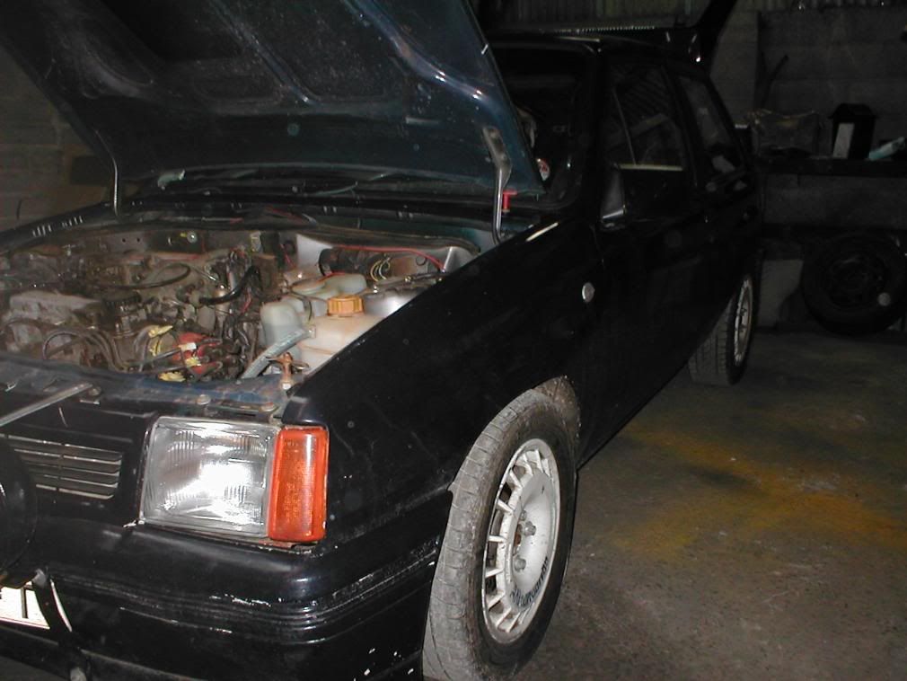

Anyway Time to start stripping her down so into the workshop she goes (sorry **** pics)
http://i46.photobucket.com/albums/f1...x/P1010082.jpghttp://i46.photobucket.com/albums/f1...x/P1010083.jpg
http://i46.photobucket.com/albums/f1...x/P1010084.jpg

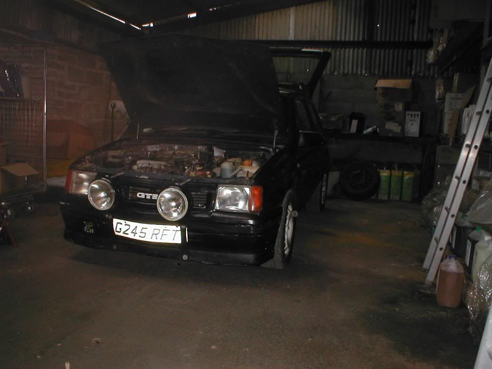

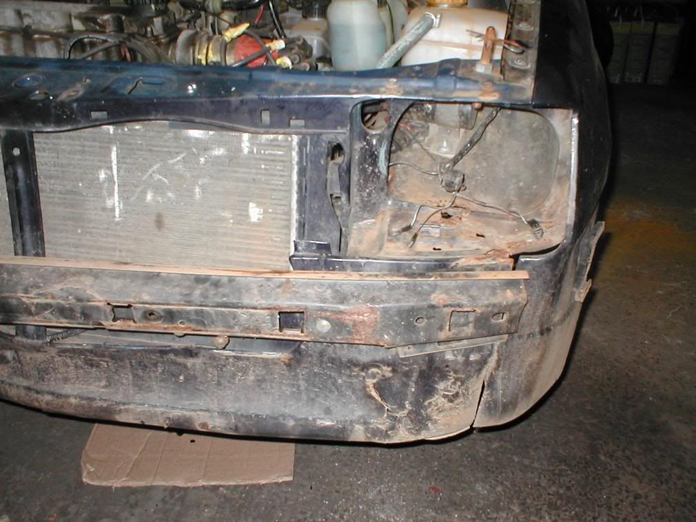

Fog lights lol think of the weight they are carrying, waste of time, rip it all off http://i46.photobucket.com/albums/f1...x/P1010087.jpg
http://i46.photobucket.com/albums/f1...x/P1010088.jpg
Its a fairly solid shell, few bits of welding need doing but nothing major

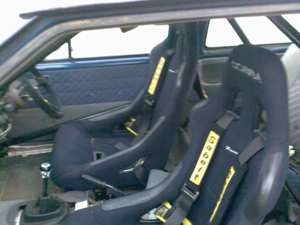

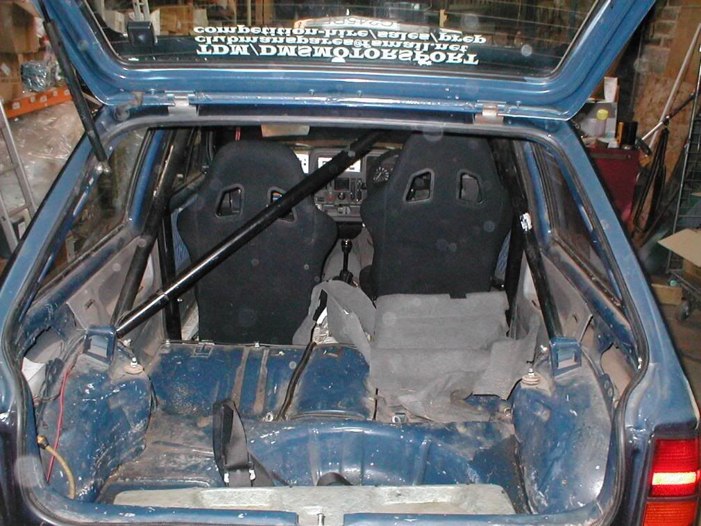

Now inside the car
http://i46.photobucket.com/albums/f1...x/Image003.jpg
http://i46.photobucket.com/albums/f1...x/P1010085.jpg
Get it all out http://i46.photobucket.com/albums/f1...x/Image012.jpg

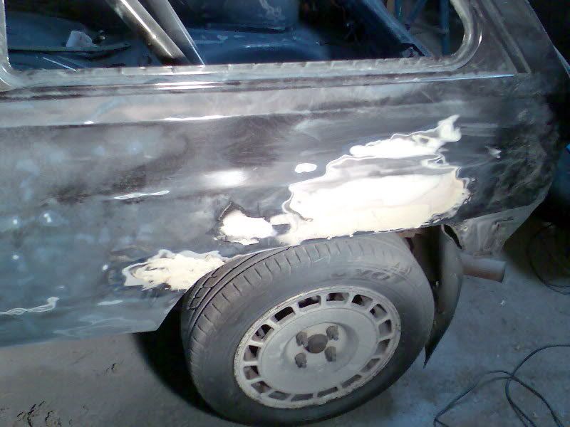

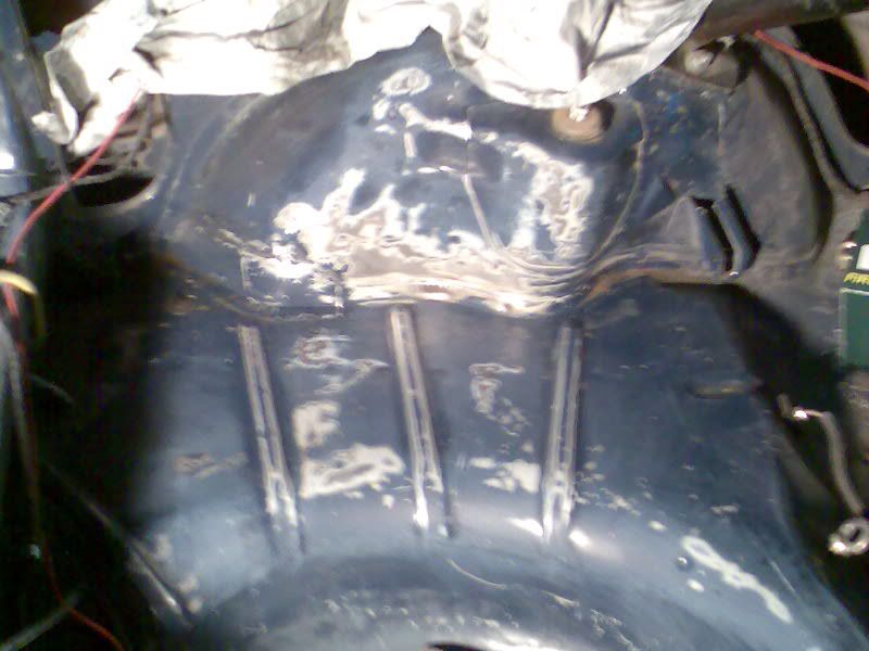

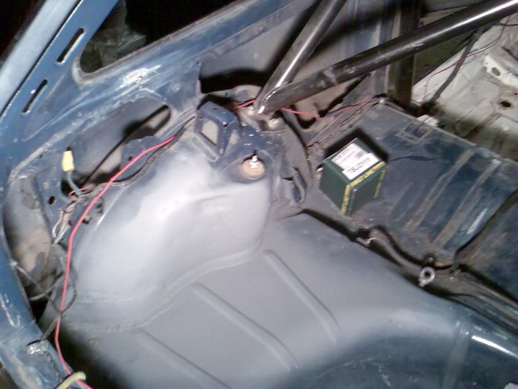

So while we wait i started prepping inside the car, started on rear arch
http://i46.photobucket.com/albums/f1...x/Image018.jpg#
Then primered it to see what looked like and was feeling bored
http://i46.photobucket.com/albums/f1...x/Image019.jpg
and thats where i stopped, plans next are to weld sun roof and all holes inside car, paint everything inside (metal of course not dash etc etc) Bright White and the roof black, obviously only painting places that dont need welding!!!

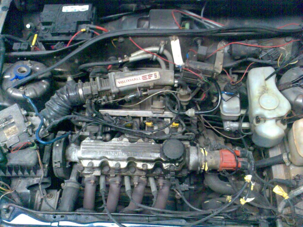

and set about tidying the bay up
here what it looks like at the moment
http://i46.photobucket.com/albums/f1...y/Image028.jpg
big mess at the moment, bosch injection system....lovely, cant decide what want to do with the engine, everywhere seem to read everyone goes on about twin 40's, so i might be going down that road, leave that til the end though
Looks well, engine wise, if I was building again, I'd probably stick with the standard injection. Have a search for -bruce- on here, he ran a group A 150bhp 1.6 8v :thumb:
What are the pipes p-cliped to the bulkhead? PAS?
looks like the fuel pipes!?!
yeah fuel lines running inside car, car is a big dusty mess at moment, waiting on mate to take it away to get paint and welding done (inc seat mounts welded in) then i can paint inside, put it all back together and go trash it about, not alot to do really but there still plenty to do (if that makes sense)
