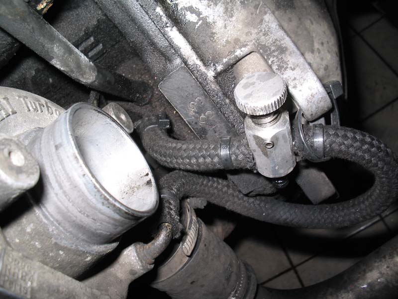

The next picture shows where I put the bleed valve and where to put the pipes linking it in.
To start with there is a strait piece of pipe linking the turbo compressor outlet to the wastegate actuator, remove this. You'll need to get hold of some extra pipe to plumb in the bleed valve, I used some fuel line I had at work, but almost anything will do, as long as its a good fit on the turbo outlet and bleed valve.
Fit the bleed valve in between the turbo outlet and actuator, I suggest fitting it somewhere you can adjust it without having to remove anything, to make it easier to set the boost pressure you want to run.
Sorry about the poor picture, but I didn't have time to remove the inlet hose to show it better, I'll take another one tomorrow when I have time.
When you've got that fitted, keep the bleed valve fully closed and go out for a run. The max boost you should see is about 0.7 bar. Open the bleed valve a bit at a time until you are running 1 bar of boost, then lock the bleed valve off (it should have a little locking grub screw or something to stop it moving.)

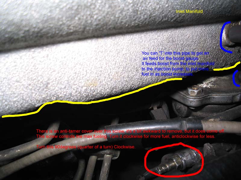

The next picture shows the max fuel screw. To begin with, there is a anti tamper cover over it, remove this, its awkward, side cutters and cut it off is probably best.
Mark the start position of the screw, then undo the lock nut (while hold the screw) now turn the screw 90degress (quarter of a turn) clockwise. This will increase the fuelling. Then nip the locknut backup (while holding the screw in its new position)
Now, start it up, the idle speed will be a bit high due to the extra fuel. Make sure the temp gauge is above 90, locate the accelerator lever (with the accelerator cable attached) At idle, this lever rests against the stop nearest the O/S wing, undo the locknut and undo this stop until you get the idle back down again. Should be idling ~800RPM.
Sorted. Go for a blast and see what you think.

Some images courtesy of Rich C showing where the bleed valve should go
http://www.cemetery.eclipse.co.uk/ri...leedvalve3.jpg
fitting a boost guage and the location of the fuel screw:
http://www.cemetery.eclipse.co.uk/rich/tweak/fig1.jpg
http://www.cemetery.eclipse.co.uk/rich/tweak/fig5.jpg
