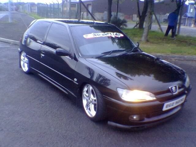

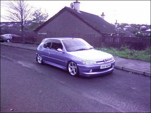

hehe your worried about getting one for 850 lad they sell for 1500 + here lol il wack a few more up with silly strips a FELT SPEC FTW . . .

is the guy in the middle pic having a pi55? lol
lol just noticed that aye he must be lol

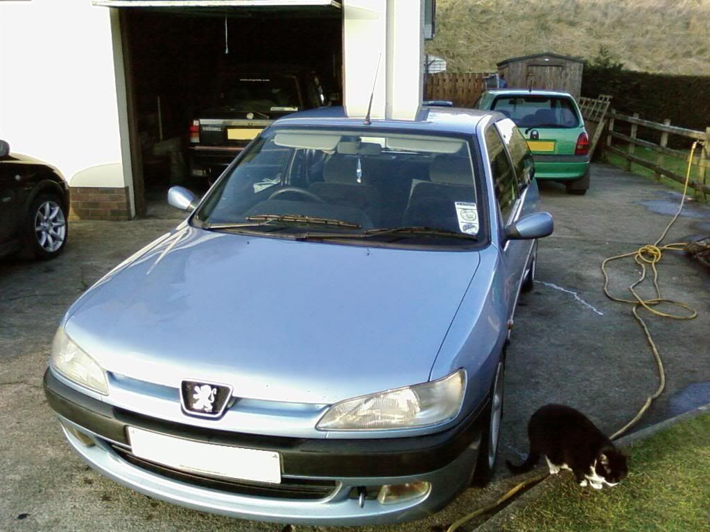

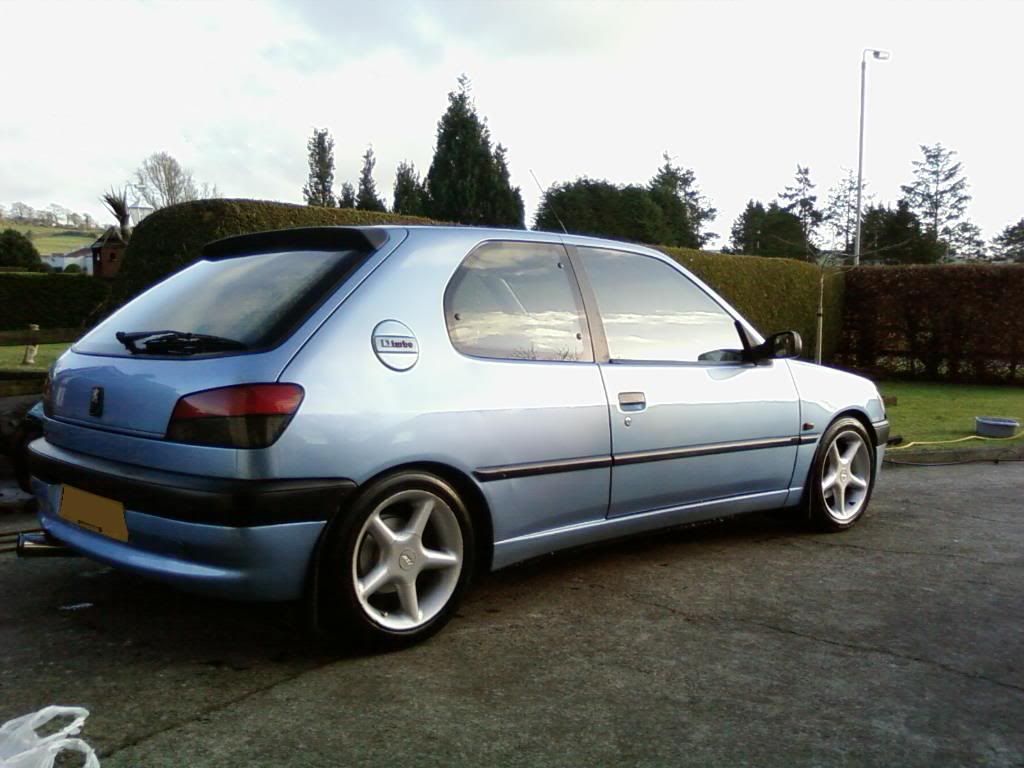

I just bought one a while back as my daily driver, seems a good enough car... as said just check back axle etc and obvious things like temp guage and when timing belt was done etc. Also check passenger footwell for dampness as this could possibly point to knackered heater matrix (dash out job). Can be made to go reasonably well for an old 1.9td. Here's my blue Phase 2:
