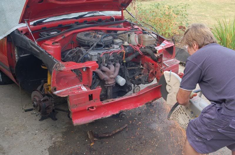

And if you want to do it how we did it, a fat **** petrol saw AKA a paddy saw

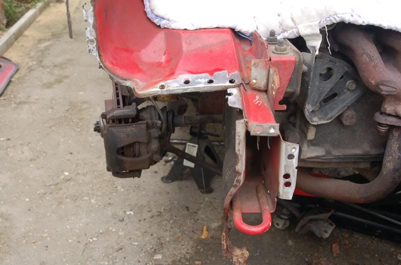

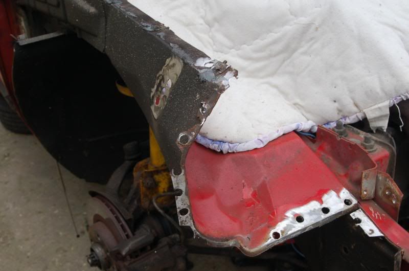

The start
http://i30.photobucket.com/albums/c3...4.jpg~original

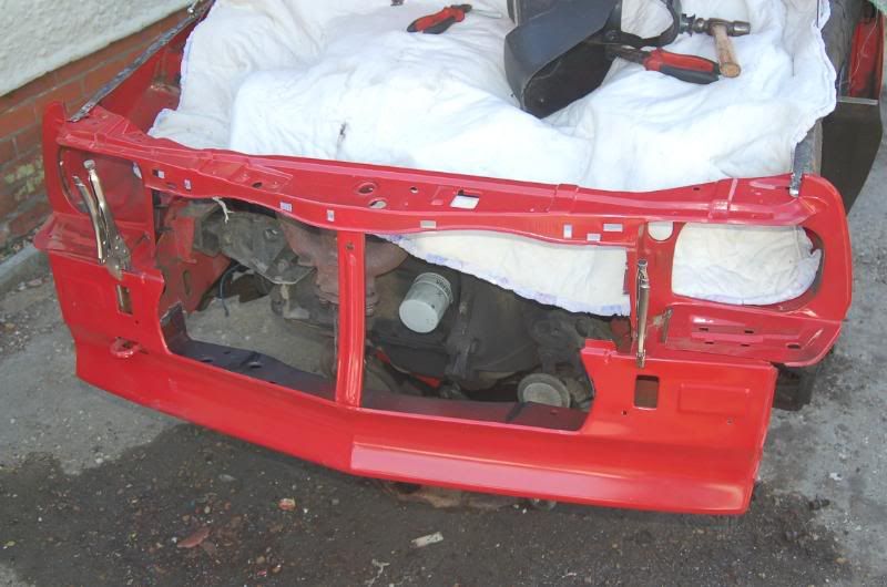

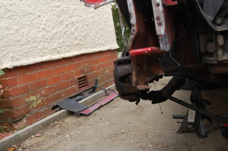

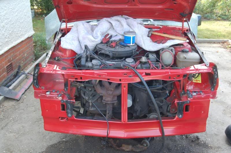

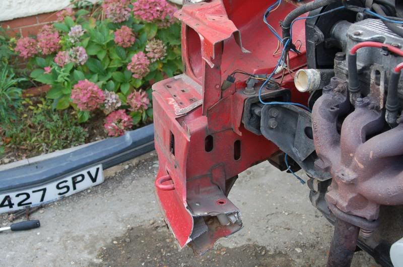

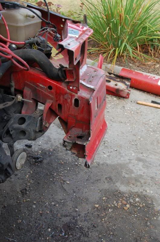

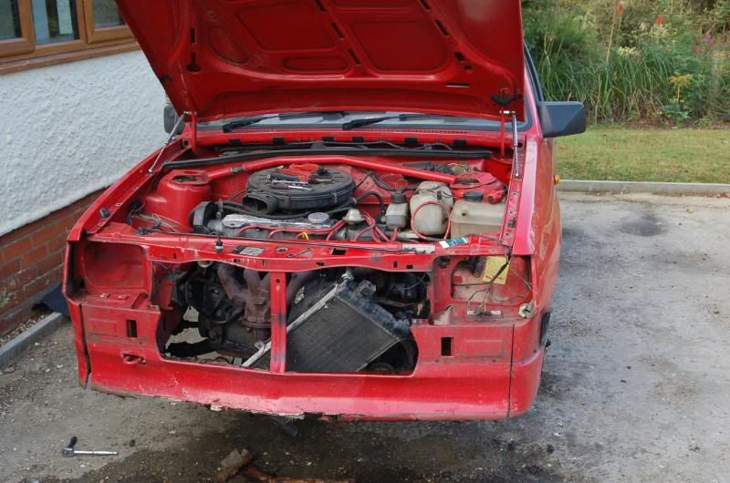

Strip all the bits of the front, including the radiator, bumpers, lights, indicators, wings. I struggled a tiny bit getting the radiator out with the engine in. but managed it.

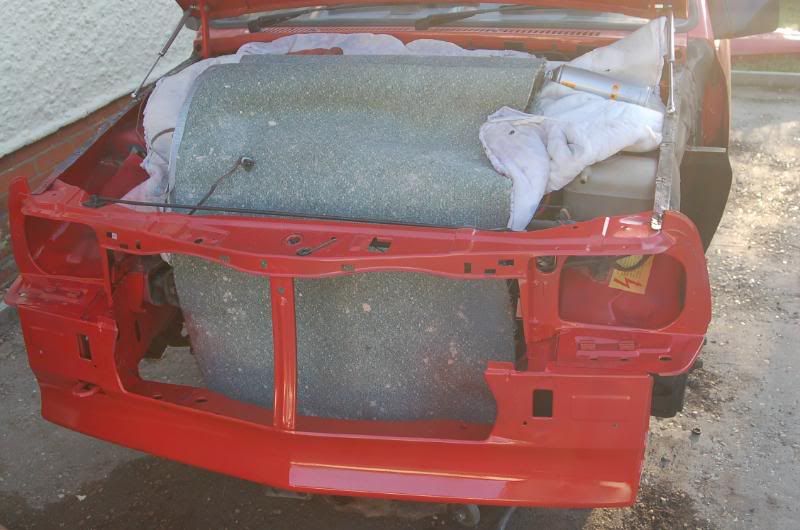

You should be left with something like this
http://i30.photobucket.com/albums/c3...5.jpg~original
Minus the wings. And also that picture shows the way I got the radiator out, coming upwards.

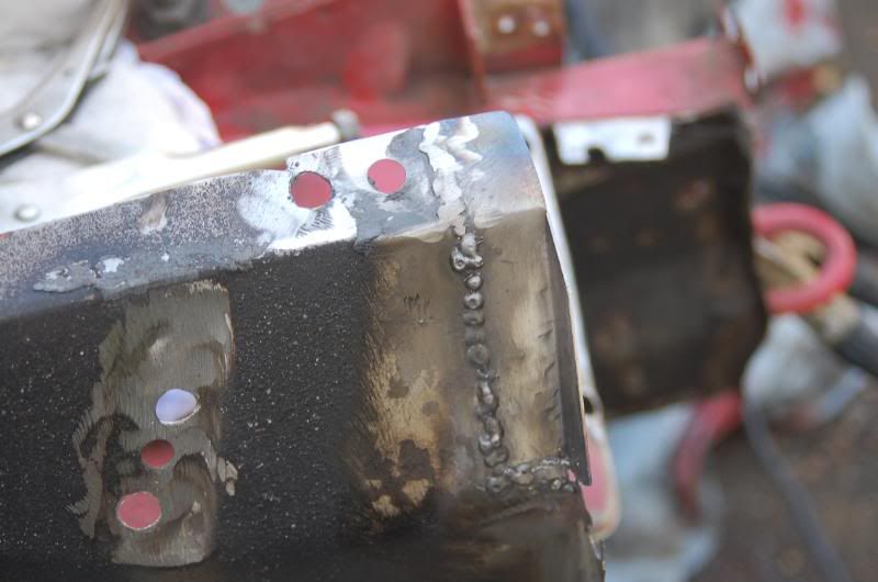

Find a man, with a big saw and cut out the middle bit on the front panel, this aids getting to the spot welds
