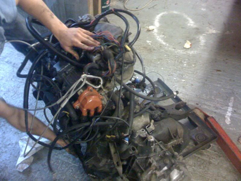

Anyway, a few hours later we got back to the workshop with this:
http://img.photobucket.com/albums/v1...Picture116.jpg

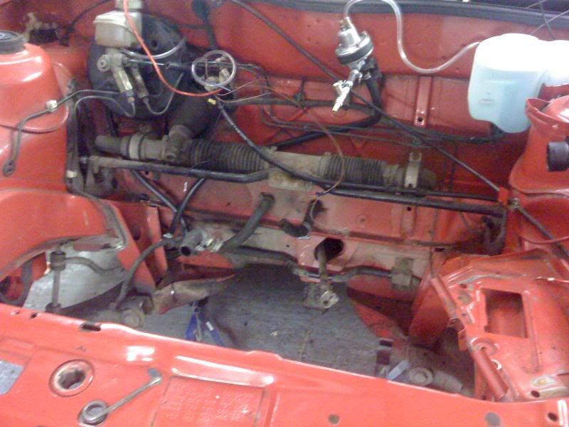

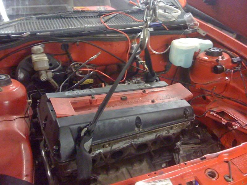

And we had to take this out of his car:
http://img.photobucket.com/albums/v1...Picture050.jpg
And shes out:
http://img.photobucket.com/albums/v1...Picture042.jpg

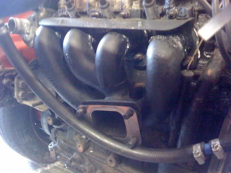

(incidently the 8V turbo manifold will be for sale soon, has a T3 flange on it)
http://img.photobucket.com/albums/v1...Picture077.jpg

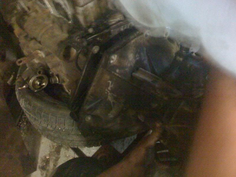

Next up was to change the gearboxes over, so off came the Saab one, and on went the Vaux item. After trying for around 15 mins we realised the tyre that the engine was sitting on was in the fecking way lol :
http://img.photobucket.com/albums/v1...Picture082.jpg

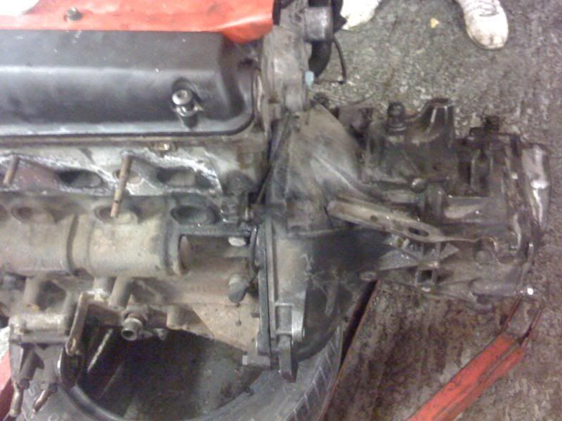

An one Vauxhall gearbox on one Saab Engine:
http://img.photobucket.com/albums/v1...Picture088.jpg

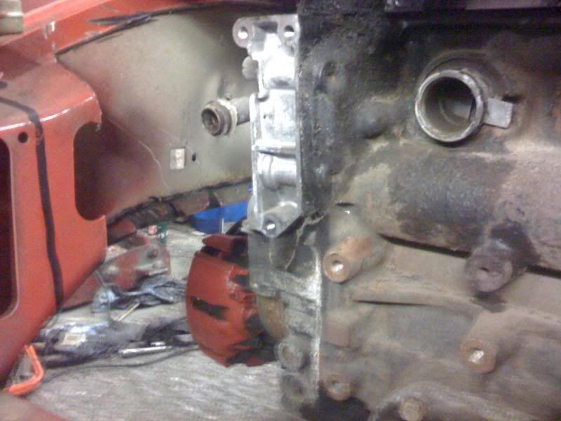

Note you have to grind this off so that yucan get a water hose on the pipe:
http://img.photobucket.com/albums/v1...Picture114.jpg
We chose to use the Vauxhall gearbox so we can retain the standartd mountson it, and alsote standard drieshaft. Ideally the engine could do wth being closer the NS chassis leg, but this would make life moredifficult fr us in the fact that we would have to fabricate three mounts, fancy driveshafts and not be 100% sure that it was sitting straight and true.

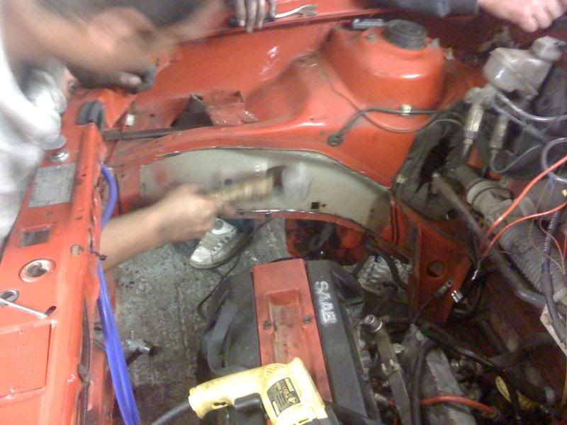

We got the engine up into position and had no hope of even getting the NS front moun on, so back down in went, after a bit of measurement we decided what need to come of the OS chassis leg:
http://img.photobucket.com/albums/v1...Picture038.jpg
http://img.photobucket.com/albums/v1...Picture012.jpg
http://img.photobucket.com/albums/v1...Picture086.jpg
