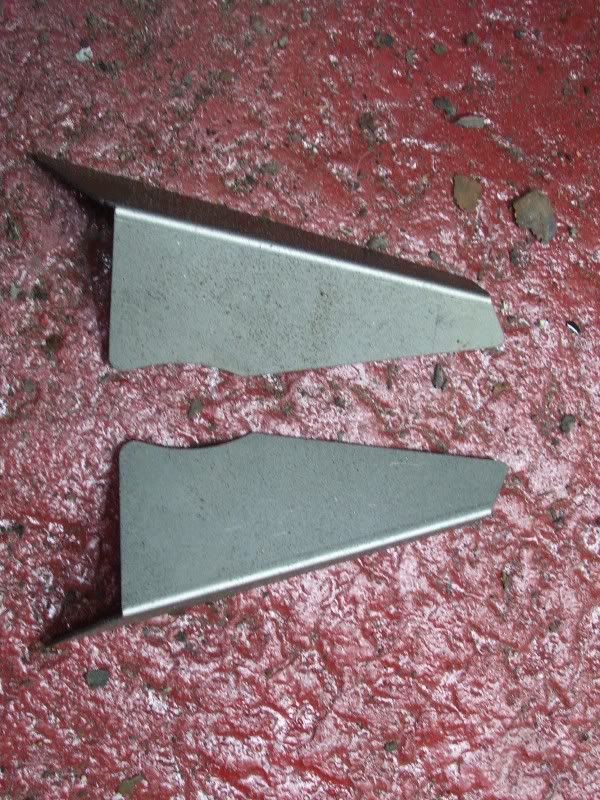

Seems to get asked a fair bit, so here are some pics for pointers for the positions of the welds needed and where the plates go. Hope it is of some use to people!
P.S. i think alot of these pics i copy and pasted when Dave/Bert did his, so hope he doesnt mind me using them! :)
http://img.photobucket.com/albums/v3...1.jpg~original
Alternator mod in chassis leg. Doesnt need to be this much, but can help if work is needed, or engine moves to much!
Bulkhead welds. Be an idea to remove carpets and have someone with a wet cloth sponge on the inside. I did, just as a precaution.
Turret and inner wing welds *note, no strut tops present. I you are putting these on, you can weld these aswell*
N/S HH plate position.
O/S HH plate position
With the HH plates it is also recomended to weld the holes aswell. You may also find you have two plates left over with nuts welded on: these are for if you are using a sump guard IIRC.
I have closed this thread, but if i have made any errors (more than likely, lol) PM me and i will edit accordingly. Thanks.
