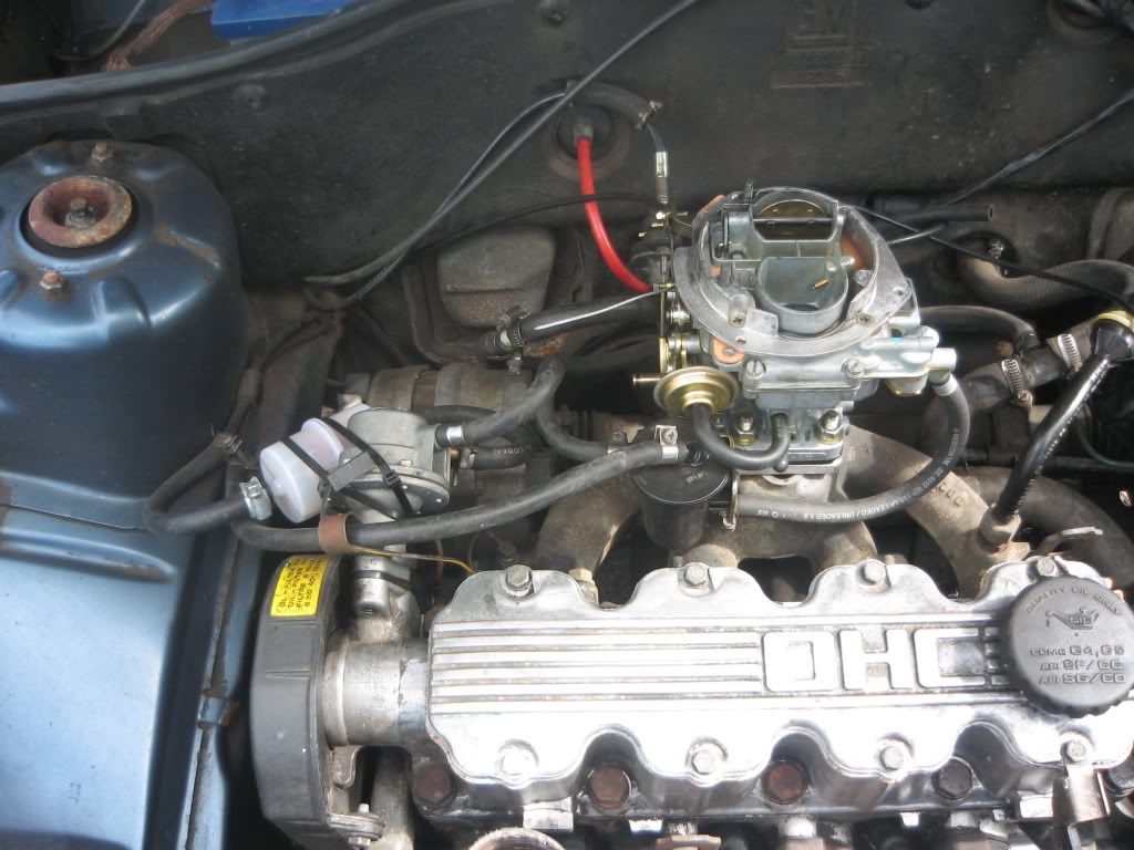

hello..swapped my 1.2 carbed engine for a 1.4sr with weber 32/34 carb. Could do with a few pics on how the fuel feed and cables are run, think i need a different accelerator cable too??

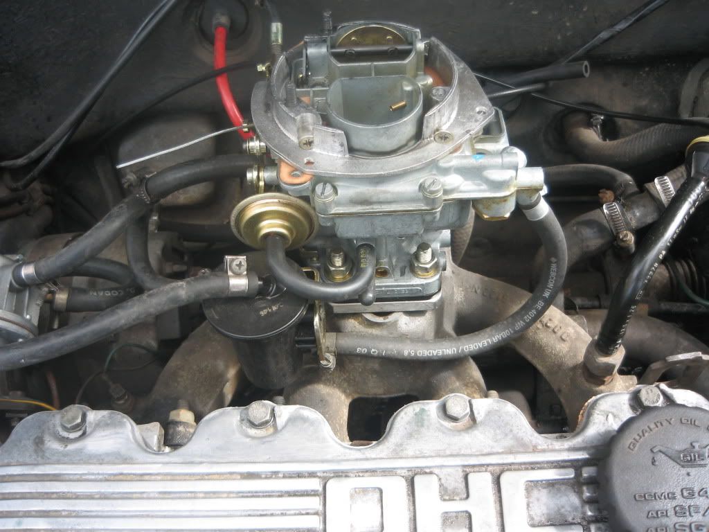

mines a 1.3sr with a weber 32/34 on it

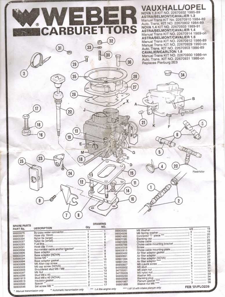

heres the instrucions
http://i1062.photobucket.com/albums/...za93/File1.jpg
and the instructions:- https://rapidshare.com/files/4277849369/File_1.pdf

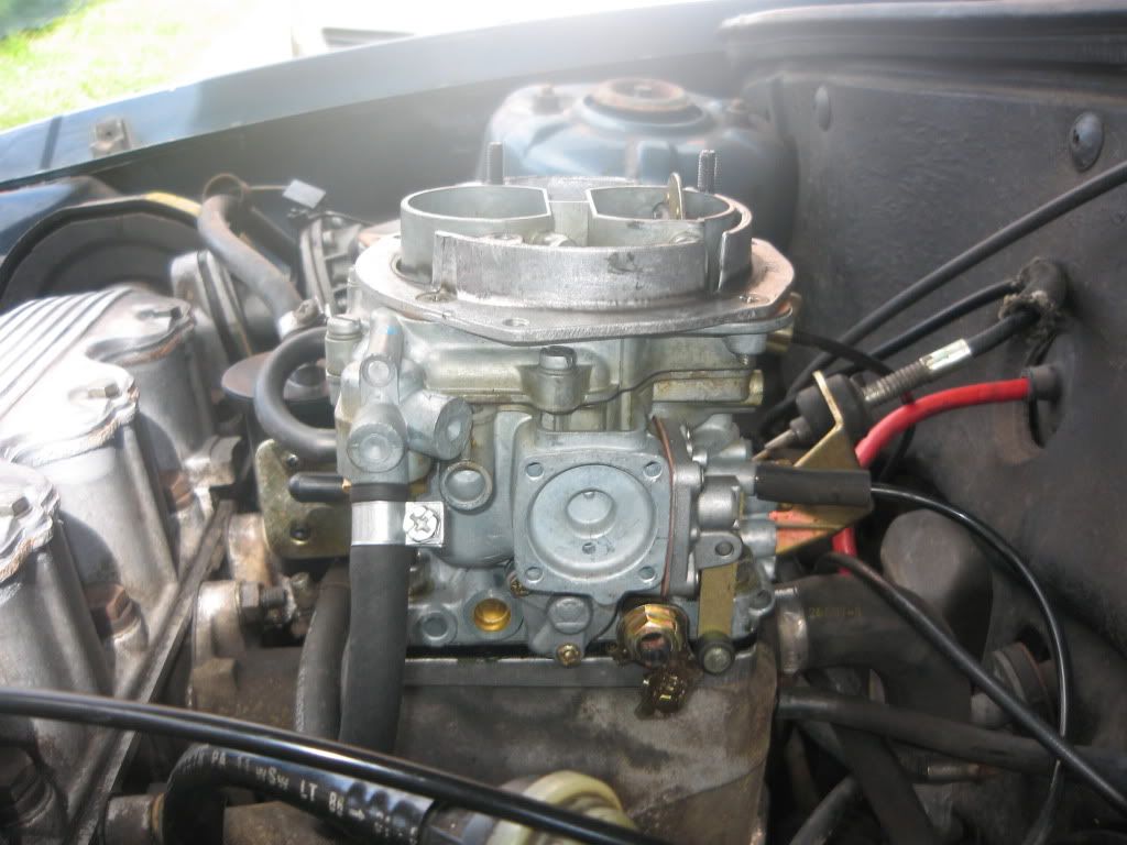

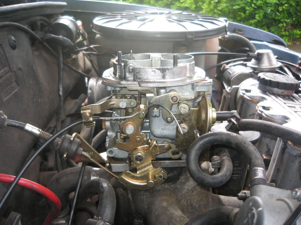

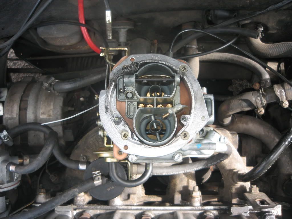

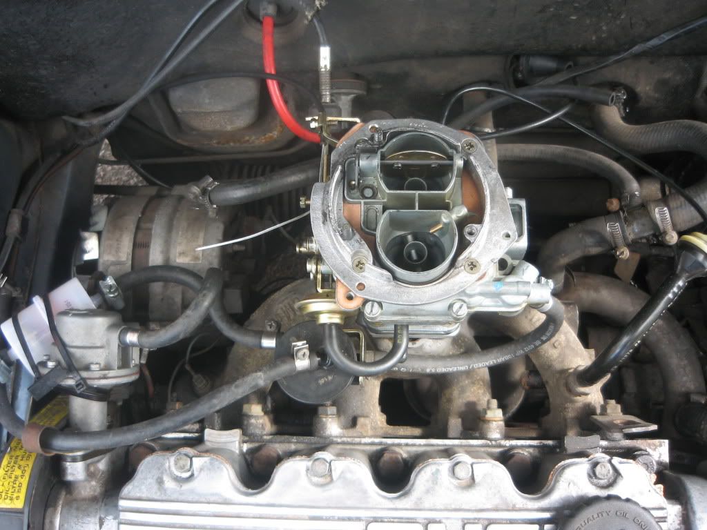

and pics
http://i1062.photobucket.com/albums/...3/IMG_1494.jpg
http://i1062.photobucket.com/albums/...3/IMG_1493.jpg
http://i1062.photobucket.com/albums/...3/IMG_1492.jpg
http://i1062.photobucket.com/albums/...3/IMG_1491.jpg
http://i1062.photobucket.com/albums/...3/IMG_1490.jpg
http://i1062.photobucket.com/albums/...3/IMG_1489.jpg
hope it helps
Just a comment Conza123, I could have sworn that when I had my 32/34 DMTL Weber on my SR (Peter Maiden conversion with manifold), that the throttle cable and choke came in from the front and the fuel came in from the left(as looking from the front of the car), unfortunately I don't have any pictues to hand.
The throttle cable definitely was not up against the bulkhead, are you sure your installation isn't 180 degrees out, My kit came with a longer throttle cable.
This maybe useful to compare
http://img.photobucket.com/albums/v6...0303-00067.jpg
Long one is from my 32/24 Weber conversion, is 700mm long, the short one is a std 1.2 carb.
i remember the choke coming from the left, i had a constantly dodgy choke lol
i didnt get a new throttle cable with my kit but it works so im not bothered but that would mean the throttle cable goes over the rocker cover
and the air box wouldnt fit either
are you sure that aint a peirburg because of the auto choke unit on the side
cheers folks, great help!much appreciated.Ido need a different throttle cable anyway because the ends are different :(
