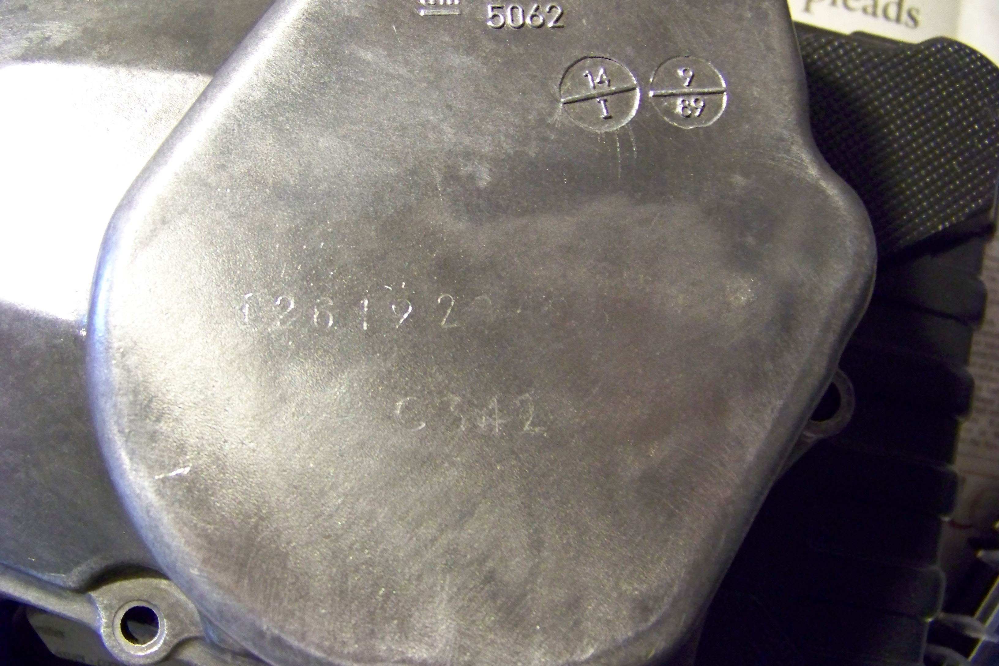

I came across a nice surprise when I started wire brushing it. The stamping was starting to show ( I used an engraving bit to bring up the digits a bit more) and I was finally be able to see what final drive ratio it had - C342 - happy that it is the FD ratio it is as it'll mean slightly longer gears so hopefully motorway driving shouldn't be like driving in 3rd Although I'm not particularly sure what version of F20 this is (CR/W5a/W5b).
https://images2.imgbox.com/f9/93/82taxg1f_o.jpg

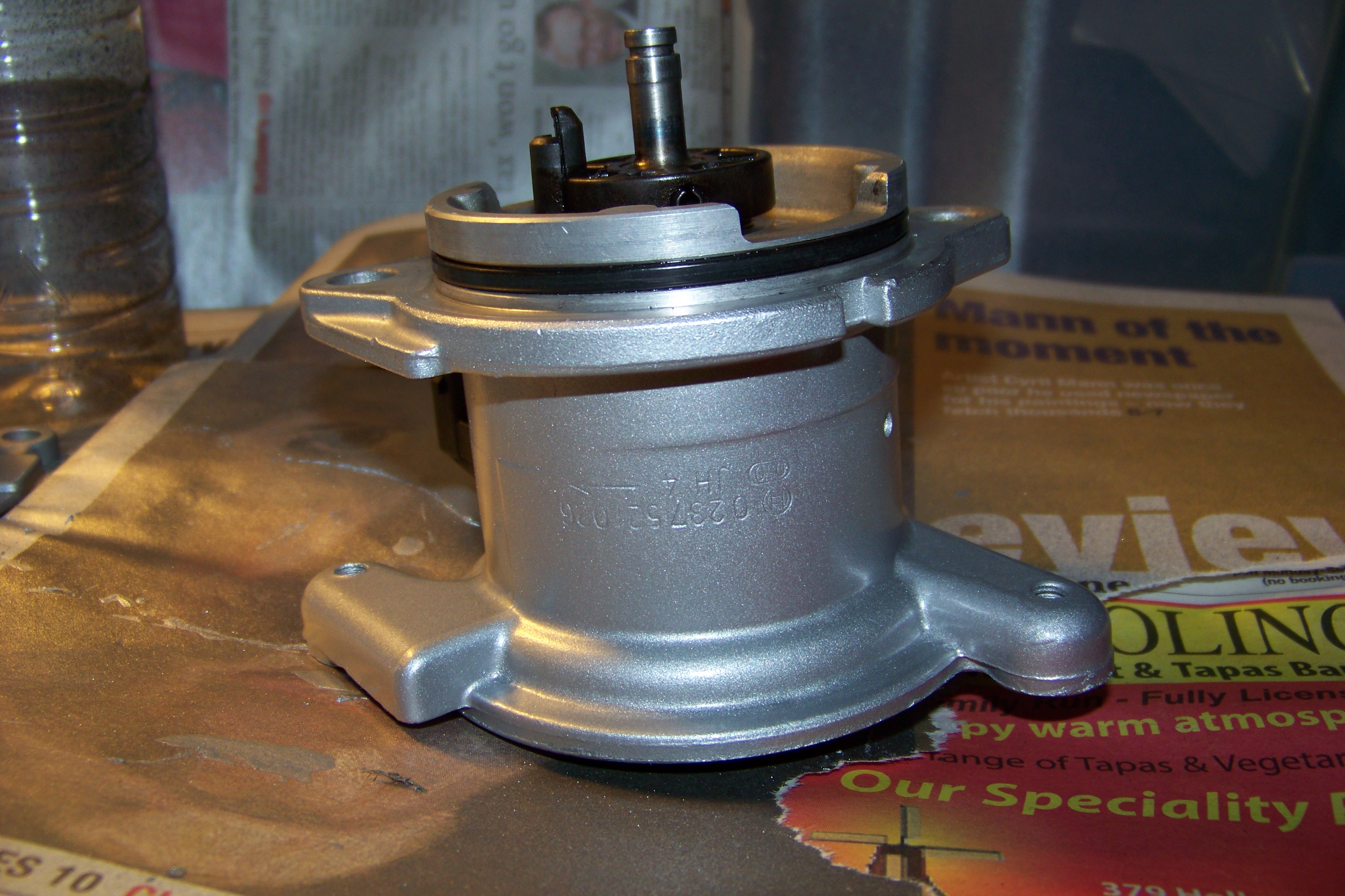

I found the dizzy drive in one of the parts boxes and realised it was the only bit of the engine not to have some paint on it. It looked a right mess, so it got the same treatment.
Gave it a clean and masked it up
https://images2.imgbox.com/3d/7d/a5uilDBY_o.jpg
Gave it a coat of paint too and it's now drying.
https://images2.imgbox.com/09/85/Hamab9ui_o.jpg

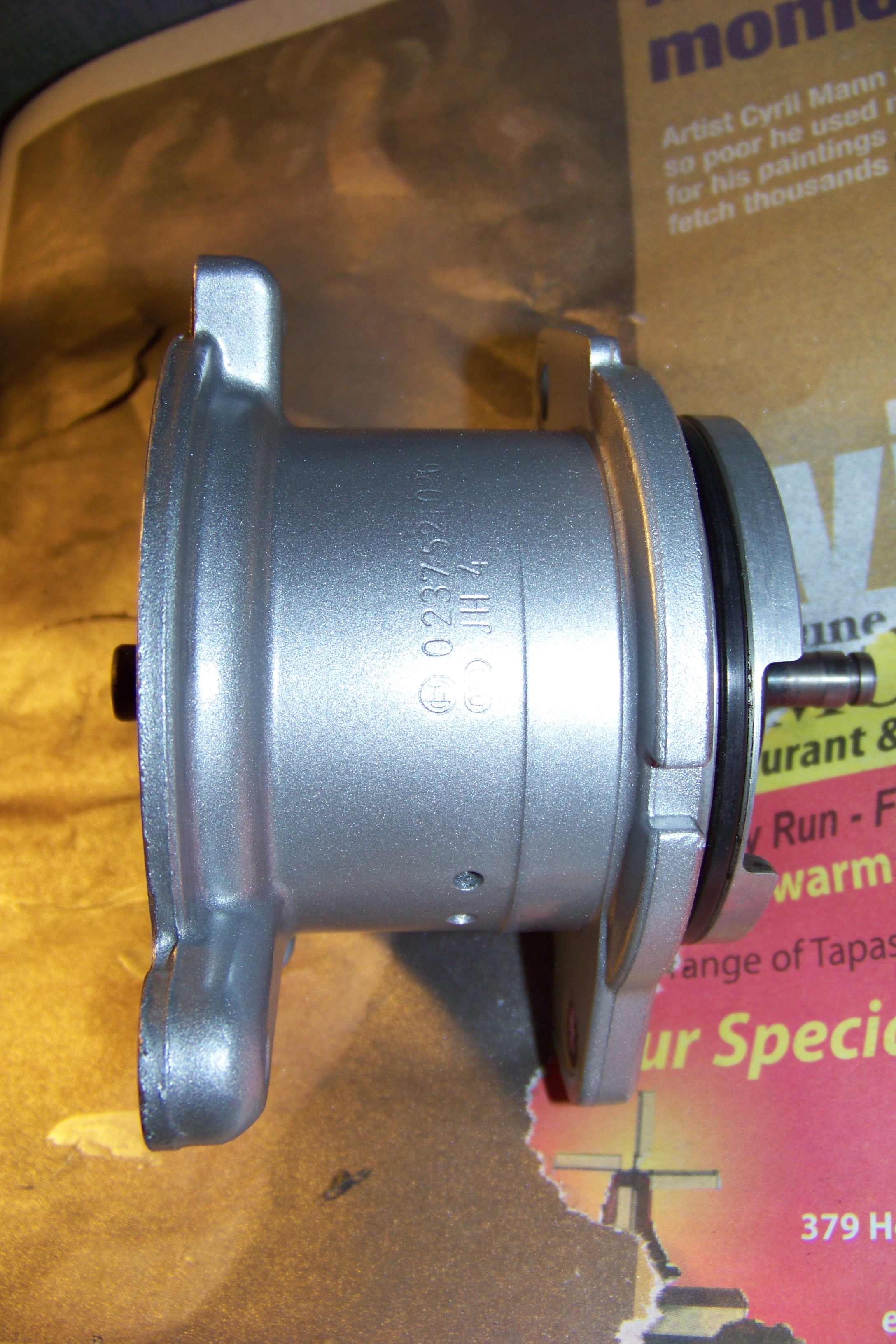

Now that the dizzy has dried, here it is
https://images2.imgbox.com/ec/22/OKsRgic3_o.jpg
http://img840.imageshack.us/img840/8206/1003173cq.jpg

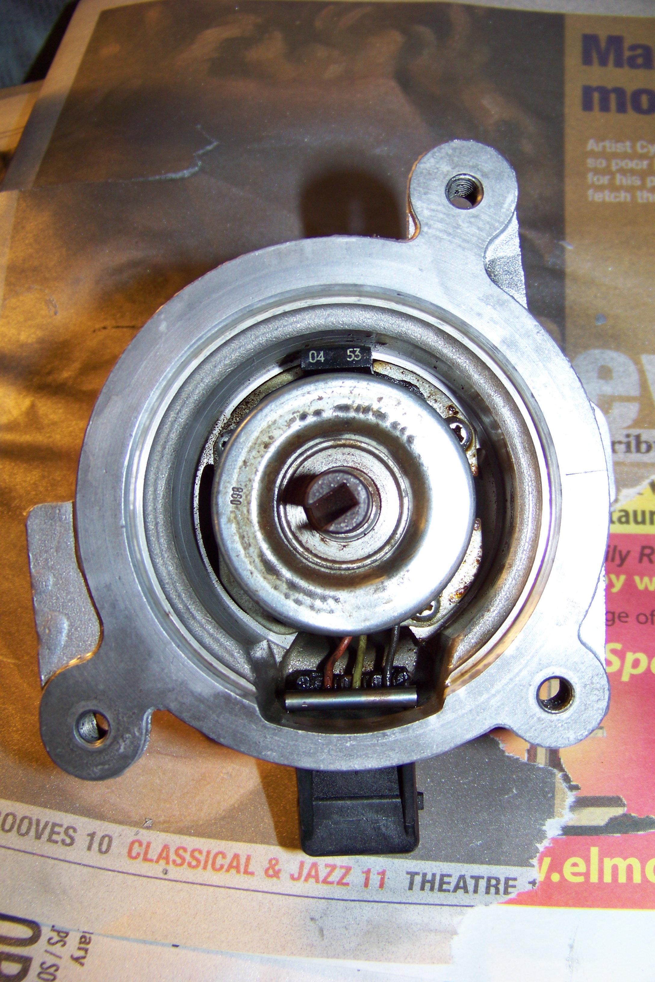

Before painting it I gave it a good clean inside as well as out. But I'm just wondering if the dizzy internals should be this exposed
https://images2.imgbox.com/e0/59/5k5mGi7J_o.jpg
http://img535.imageshack.us/img535/585/1003174z.jpg
Is there something missing from that picture? Any pictures of how they should look?
Parts look nice and fresh, is that standard Hammerite or are you using something that can sustain the heat?
For the block, head & inlet I've used Very Hight Temp aluminum paint as they'll get the hottest (can be seen way back in the thread). The cam cover has been powder coated but the dizzy (pictured) and the gearbox will be painted with silver Hammerite smooth as heat won't be a huge issue - i.e. not enough to worry the Hammerite. Luckily you can't really tell the difference between the two in tint
