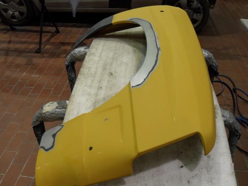

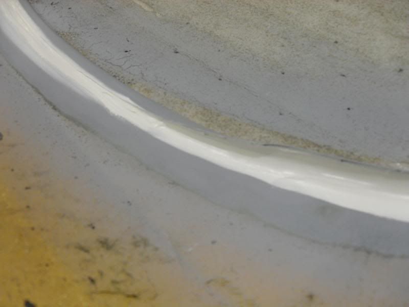

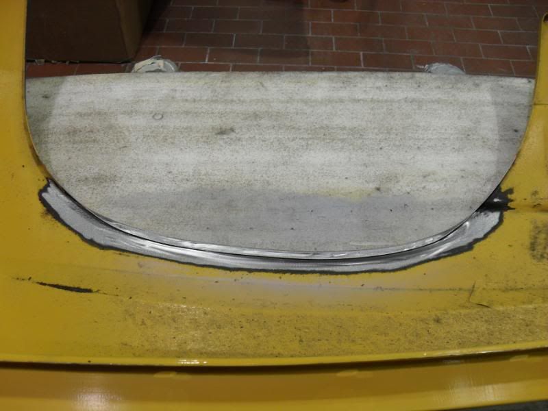

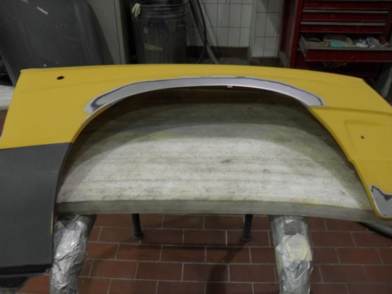

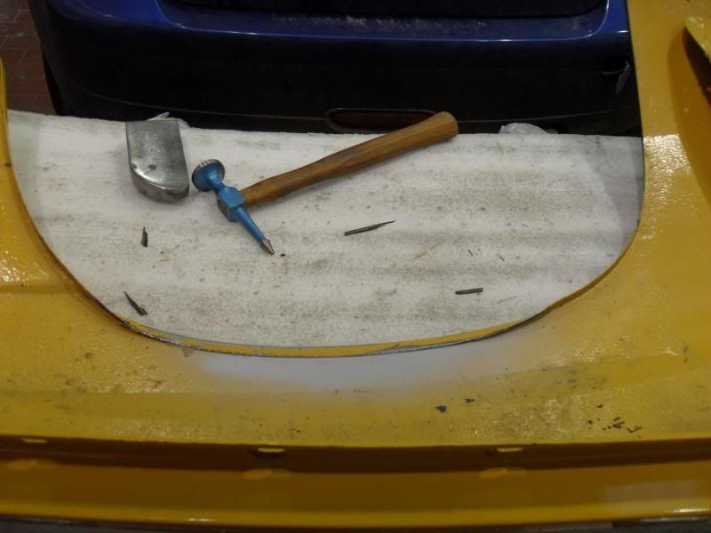

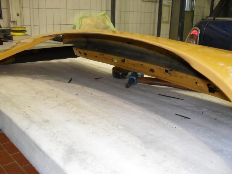

small update this eves then guys. With a little help from one of our panel guys the front arch lips were carefully rolled over yesterday after work. Just like the last set we did for the red one I didnt want any filler in them. A good few coats of high build primer and a block level and I know they will be perfect and retain the panel strength etc. The lips are completely flushed across the majority of the arch tapering off at either side for a standard look.........
http://i84.photobucket.com/albums/k2...g?t=1266430196
http://i84.photobucket.com/albums/k2...g?t=1266430234

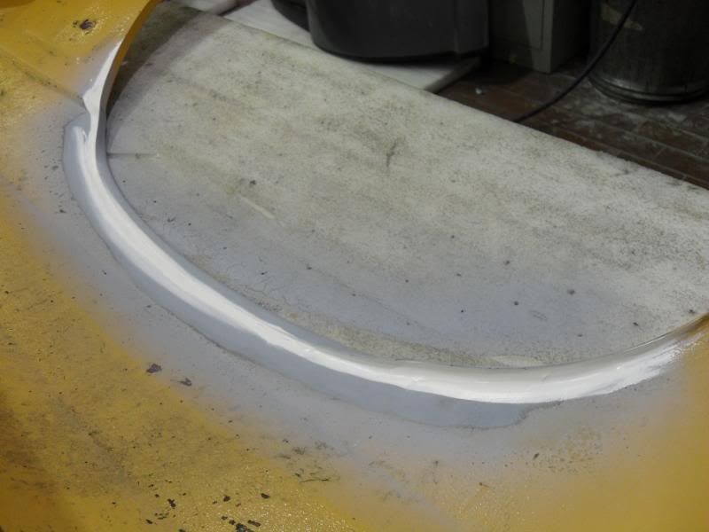

With both wing lips rolled I then dressed both inside and outside of the areas where the lips had been rolled and spent a while sanding the outers so any imperfections were removed before they are primed........
http://i84.photobucket.com/albums/k2...g?t=1266430635
http://i84.photobucket.com/albums/k2...g?t=1266430664
http://i84.photobucket.com/albums/k2...g?t=1266430683
You can see the taper at either end pretty well from this angle.......
http://i84.photobucket.com/albums/k2...g?t=1266430748

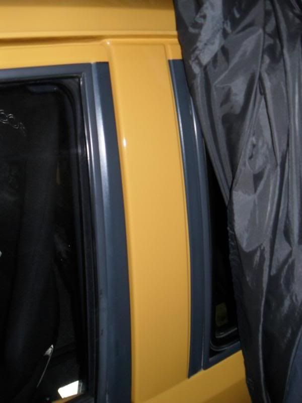

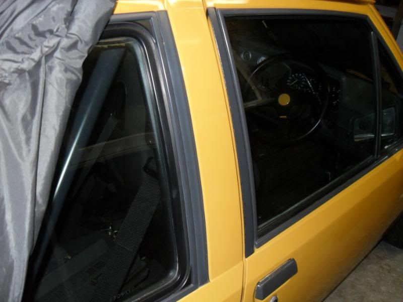

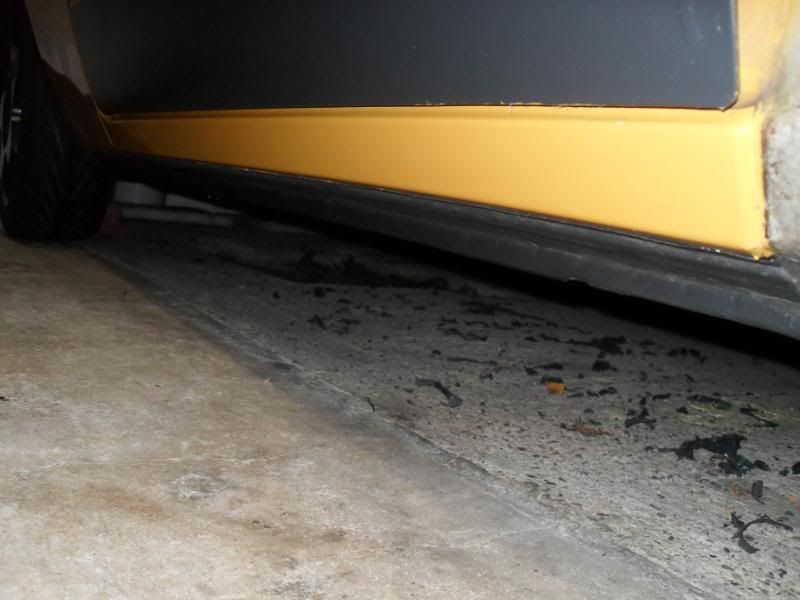

Once the sealer is dry they will be primed and the insides will have a coat of overpaintable stonegaurd on them. I also found the previous shots that I had mislaid of part vinyl removal. Main pillar vinyl off and cleaned up on both sides. Can you see the colour difference of the post to the quarter? The post will be original so I will be using this to colour match from for the best possible match........
http://i84.photobucket.com/albums/k2...g?t=1266431189
http://i84.photobucket.com/albums/k2...g?t=1266431308

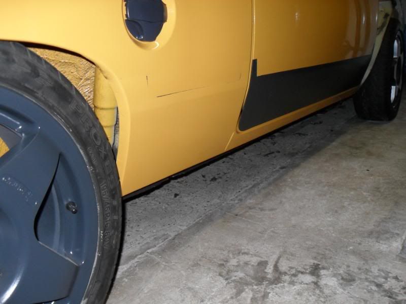

Sills and lower quarters also show excellent condition behind the vinyl.................
http://i84.photobucket.com/albums/k2...g?t=1266431382
http://i84.photobucket.com/albums/k2...g?t=1266431418

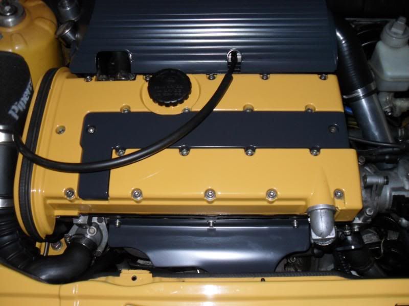

Lastly for this eves is a shot from the engine bay showing the new plug cover fitted and the promotasport heatshield too...........
http://i84.photobucket.com/albums/k2...g?t=1266431493

Cheers Keith! Im unsure on the plug cover at the mo but I have the other with polished lettering too so I can swap if needs be.
Nick.
Plug cover with polished letters would look nicer IMO
Always thought flat/plain plug covers looked a tad boring in the bay.

Thats the thing though Ad........ Boring does equal subtlety most of the time which is how I want this to be. No bling this time round!Quote:

Just think that it will make the bay look a bit more interesting without the plain plug cover.
Only my opinion though obviously :)
