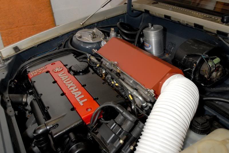

OK, so airbox is underway, and now compelte and sprayed up... decided to make another vid as it's a damn site, easier, and quick than downloading, resizing, renaming, hosting/ uploading, posting photos all the time. lol
To see finished airbox vid, and new track lol click HERE(or right click, save as)

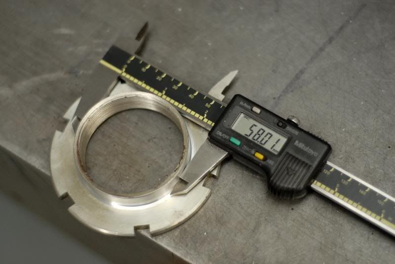

In short, I have a pair of rear height adjustable platforms that sit on the rear beam, that came with an old FK coilover kit that I never used, problem being is the OD of the platform, were 64mm / 2.5", which causes problems with trying to get a good variety of front coilover springs, to fit the rear. As the most common ID of a coilover spring is 2.25" or 58.5mm to be exact.

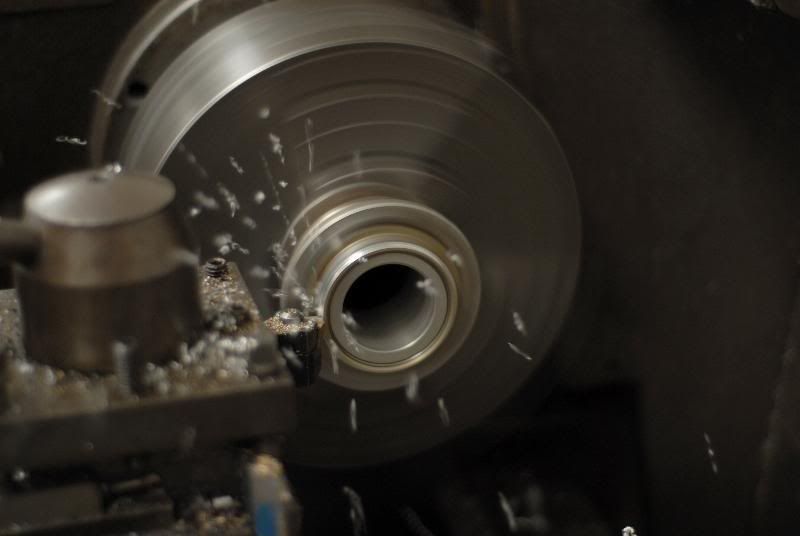

So I took my rear height adjustable platforms to the fabricators to have the OD machined down from 64mm/ 2.5", down to 58mm/ 2.25" so I could have a better choice of rear spring, size, length and poundage.
