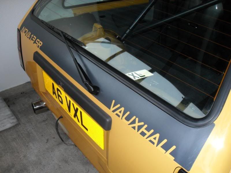

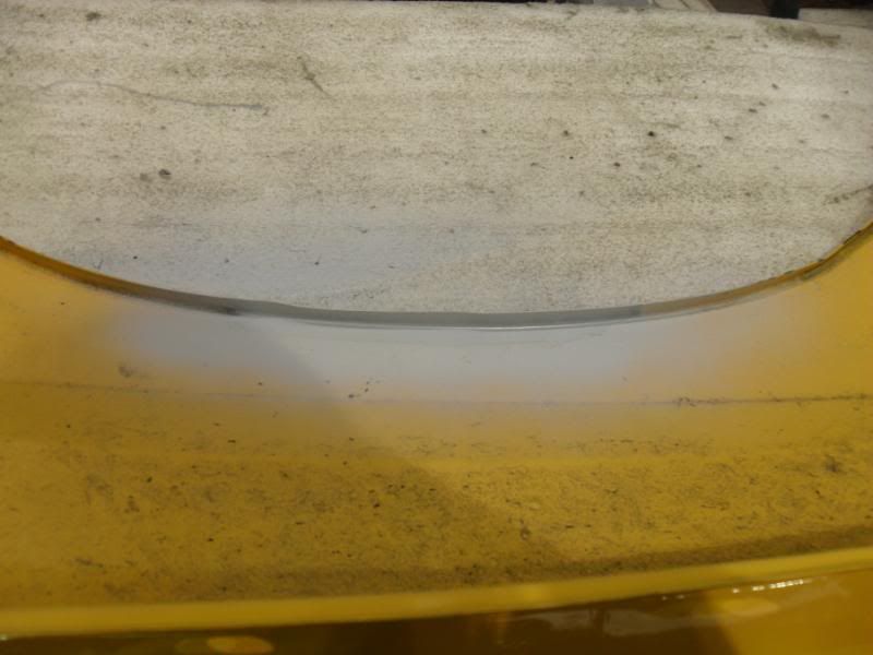

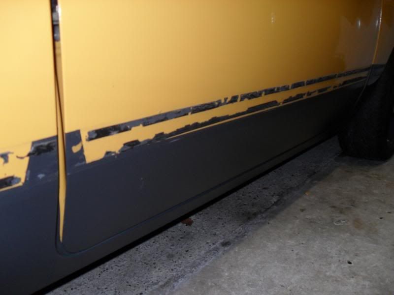

Next up was some trim and vinyl removal which I knew would be a pain but Id rather spend the hours at home doing it than at work to be honest. Its taken a hell of a lot of time to carefully remove it without chipping or scratching the paintwork but it will save me time in the long run. So.......
Rear spoiler off and glue removed..........
http://i84.photobucket.com/albums/k2...g?t=1266265964
http://i84.photobucket.com/albums/k2...g?t=1266265998

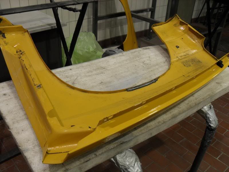

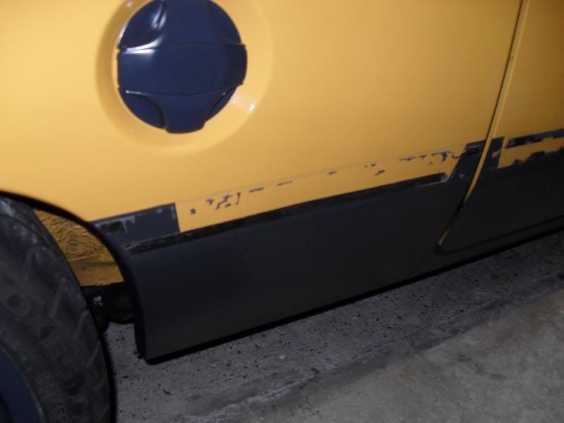

Then mouldings were carefully heated up and removed........
http://i84.photobucket.com/albums/k2...g?t=1266266046
http://i84.photobucket.com/albums/k2...g?t=1266266089
http://i84.photobucket.com/albums/k2...g?t=1266266118

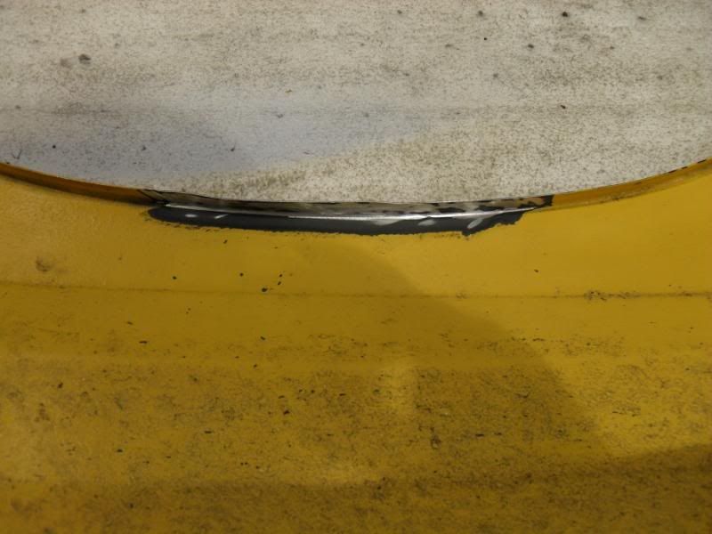

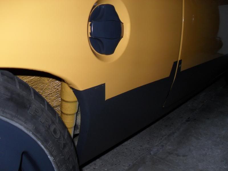

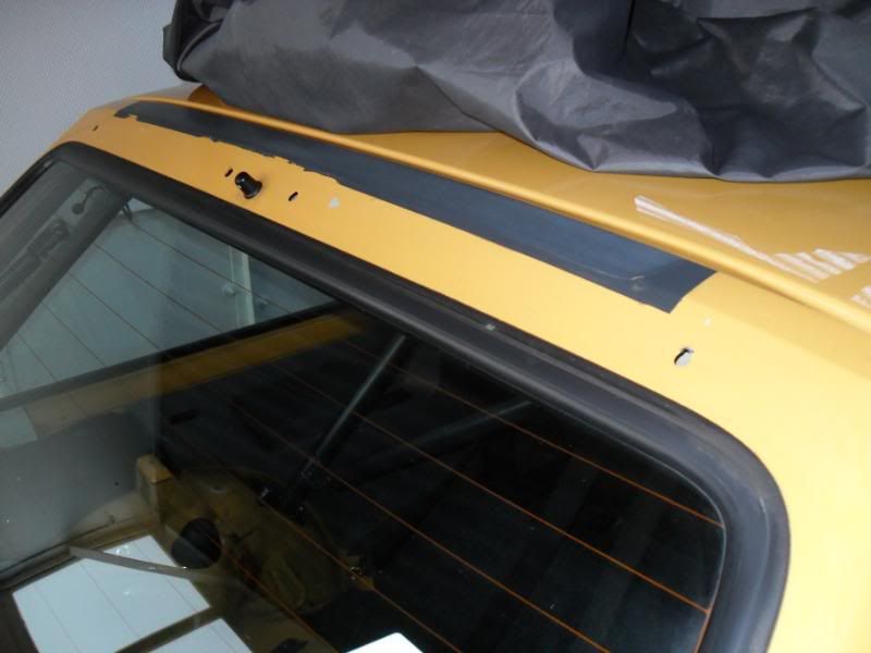

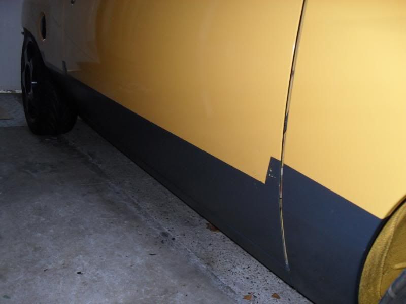

With original vinyls exposed I then carefully removed all the glue to leave it like this.......
http://i84.photobucket.com/albums/k2...g?t=1266266182
http://i84.photobucket.com/albums/k2...g?t=1266266256

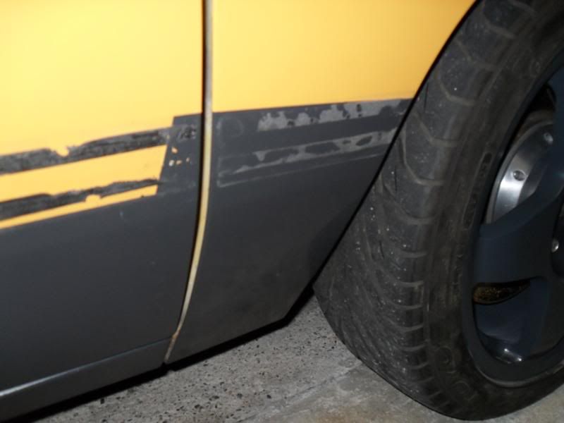

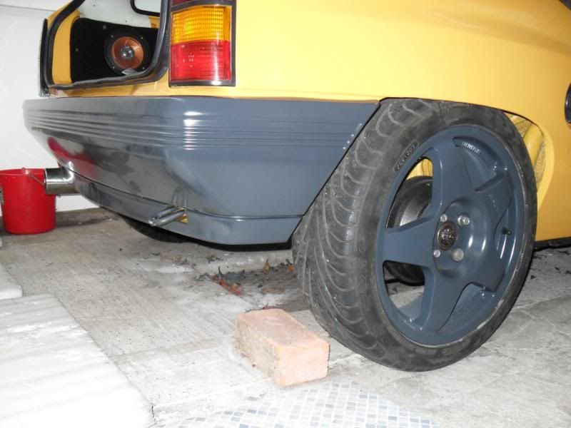

Since then the beady eye'd amongst you will have seen Ive also removed the quarter/sill vinyls along with the higher tailgate one and the main section of the pillar vinyl. However I cant seem to find pics of that at the moment! With the rear bumper home I slotted it back onto the car to see how it looked being the same colour/finish as the wheels etc.......
http://i84.photobucket.com/albums/k2...g?t=1266267247

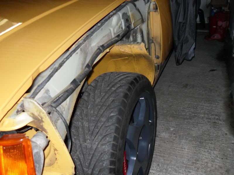

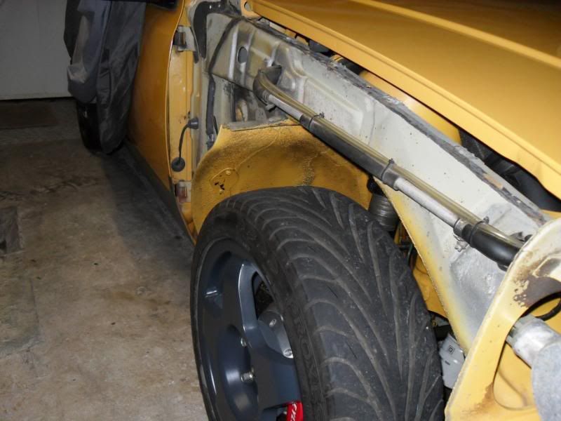

So I went back into the garage and removed the front wings to find the inner wings/splashguards and headlight panels all in mint condition.......
http://i84.photobucket.com/albums/k2...g?t=1266267412
http://i84.photobucket.com/albums/k2...g?t=1266267523
Although I knew it was a good shell to begin with the more I remove the happier I am with it as I havent had a nasty surprises touch wood! The front wings are now at work ready for the lips rolling over. With the allesios having needed 4mm spacers to clear the reyland 4 pots they did occasionally rub on the front wing lip and chipped a little of the paint off the inside of the wing. Today I just sanded back these areas to make sure there was no rust and etch primed and painted the small area on the inside of both wings so when the lips are rolled over the two surfaces that meet are both painted before being sealed together etc........
