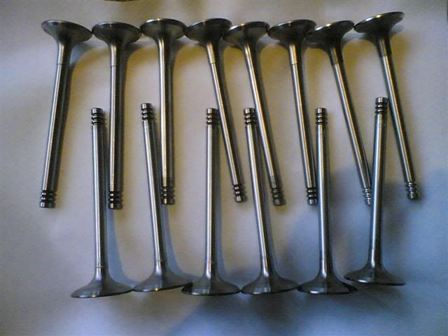

All of them were cleaned and remarked with their location
http://iainel.co.uk/images/forums/NovaWIP2/766.JPG

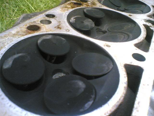

Started to lap them in with paste, anybody got any tips for creating a good seal between the tool and the valve face?
http://iainel.co.uk/images/forums/NovaWIP2/767.JPG
Getting there but needs a bit more work before the valve is perfectly smooth:
http://iainel.co.uk/images/forums/NovaWIP2/768.JPG

Paint work looks good. I hape lapping valves. I normally bribe my old man to do them for me! lol
I've done 2 and a half so far, the suction thing keeps moving around and coming off, grrr.
I feel your pain :( 14 bent
http://i5.photobucket.com/albums/y19...ic431Small.jpg
http://i5.photobucket.com/albums/y19...ic450Small.jpg
These are from my engine blow up in 2004/5 bent valves smashed guides.. whoops.
http://img69.imageshack.us/img69/6747/picture733r.jpg
http://img218.imageshack.us/img218/2451/picture732.jpg
Are you trying to prepare me for when I mash my engine or something? lol All my valves are perfectly straight.
