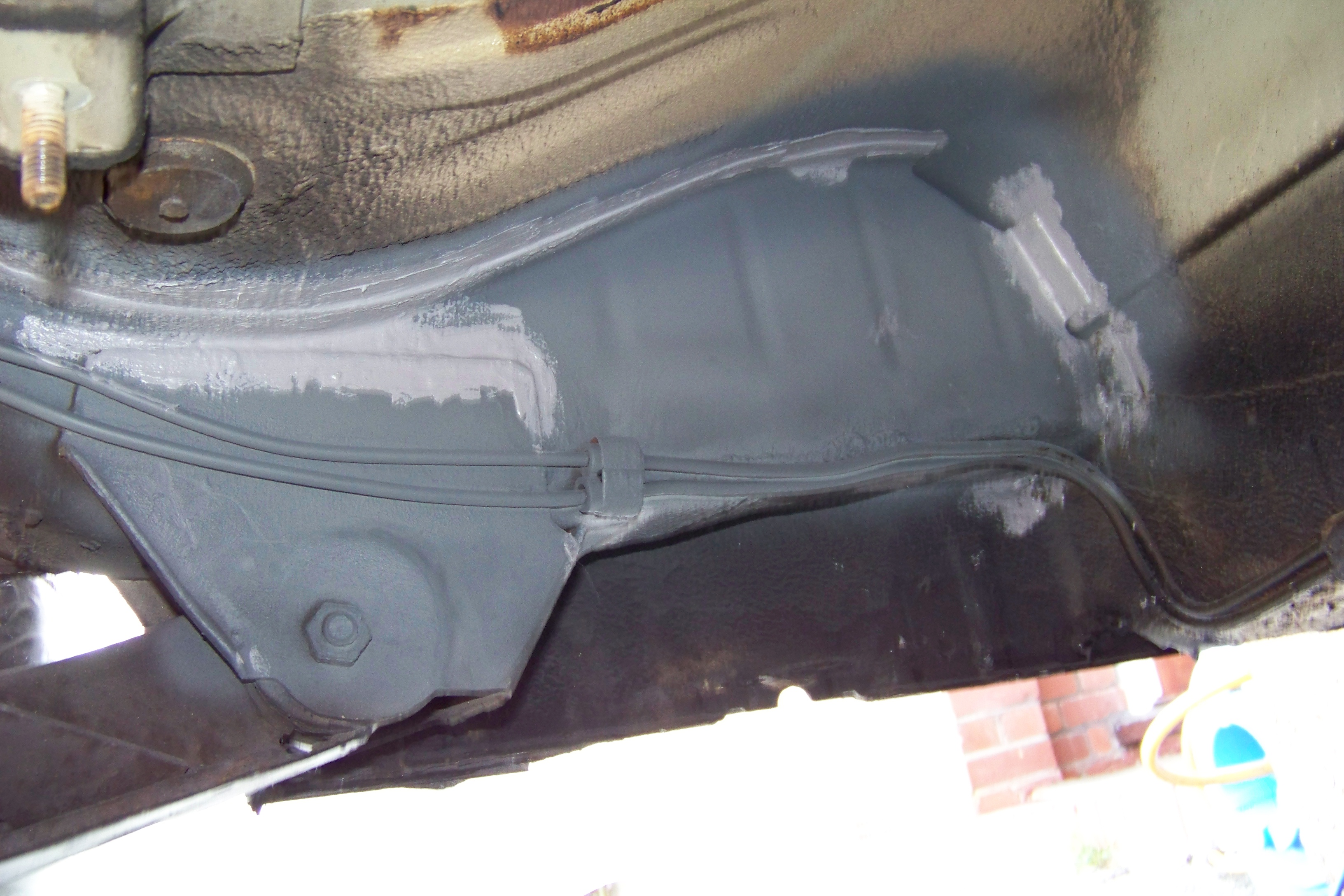

Got the Nova back on the ramps to get the underside sorted before I put the tank back.
Gave the areas in question a few coats with Zinc primer and then went over all the joins with some seam sealer to make sure they won't start rusting again.
https://images2.imgbox.com/e7/5e/ksFxi56u_o.jpg
https://images2.imgbox.com/9f/5e/soqZ0Dqz_o.jpg
https://images2.imgbox.com/e5/00/shHvhOEz_o.jpg

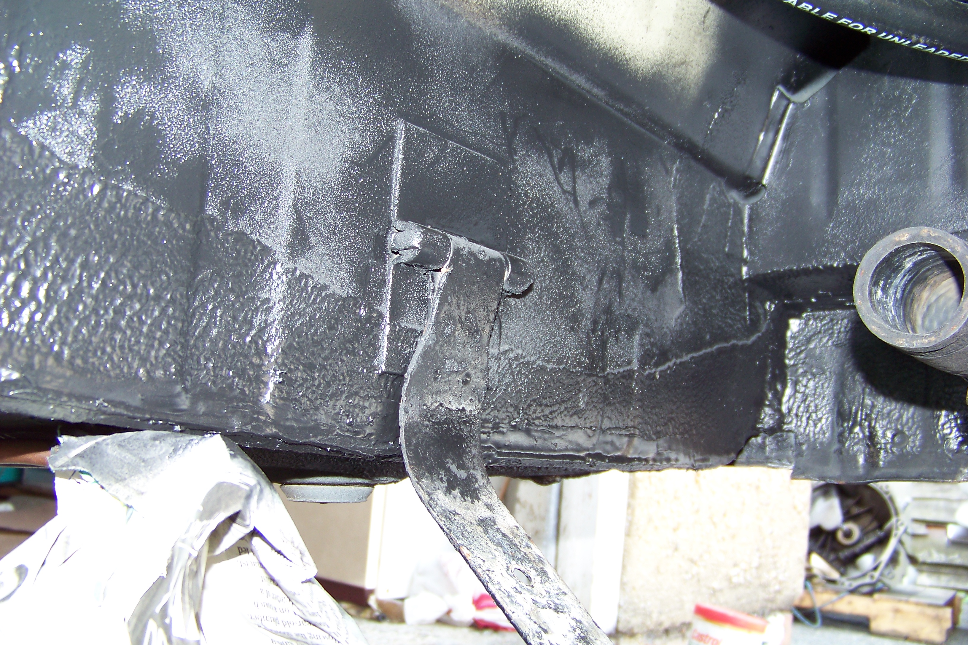

I let it dry for a while then gave the whole area a good clean then applied some stonechip underseal spray
https://images2.imgbox.com/b6/70/3B3XB2mj_o.jpg
https://images2.imgbox.com/a3/e4/HiQlCjWM_o.jpg
https://images2.imgbox.com/3c/c9/ZwVtlfNe_o.jpg
I let that try and gave the tank straps a clean and some paint too. Now came the ball ache of trying to put the tank back. Took ages especially trying to fit the breather hose into position. Eventually got it sorted and the tank looks spanking all hoses mint... nice!
