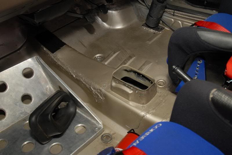

The offending item
http://i136.photobucket.com/albums/q...ure/nc0763.jpg

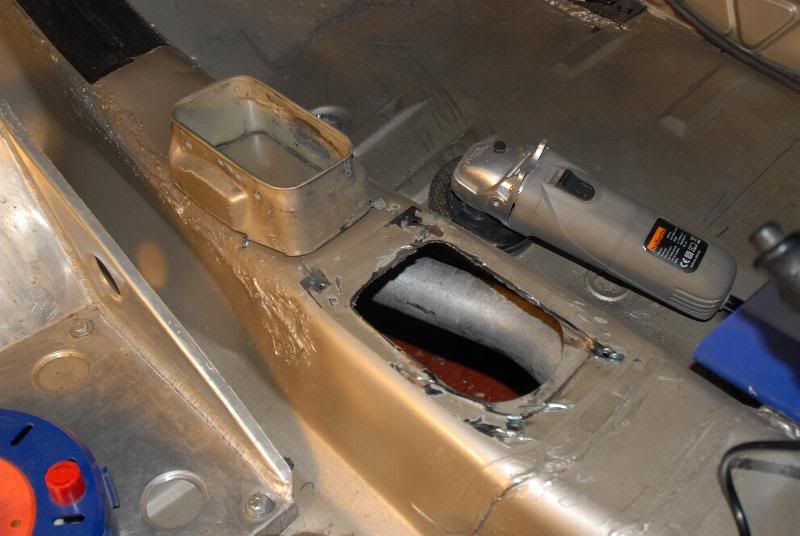

After the ballache of removing seats & harnesses, and masking & papering up windows and polycarbs, due to grindage... we had this
http://i136.photobucket.com/albums/q...ure/nc0764.jpg

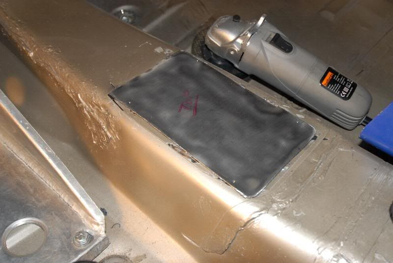

Removed, showing exposed exhaust
http://i136.photobucket.com/albums/q...ure/nc0765.jpg

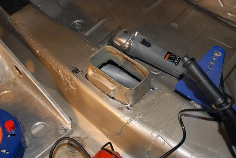

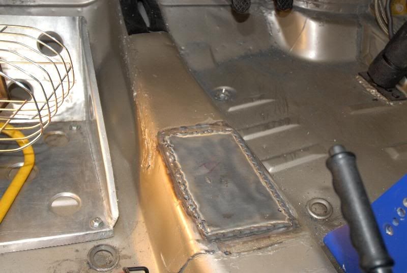

1mm thick steel plate cut to size
http://i136.photobucket.com/albums/q...ure/nc0766.jpg
Not necessary, but I'm getting quite good, so I seam welded it up - tack welds would have done really
http://i136.photobucket.com/albums/q...ure/nc0767.jpg
Then applied seam sealer & some paint, and udnerseal with Waxoyl underneath
http://i136.photobucket.com/albums/q...ure/nc0768.jpg

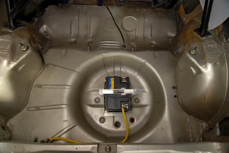

Whilst that was drying, turned my attention to my battery earth that has to be yellow in accordance with the Blue Book
http://i136.photobucket.com/albums/q...ure/nc0769.jpg

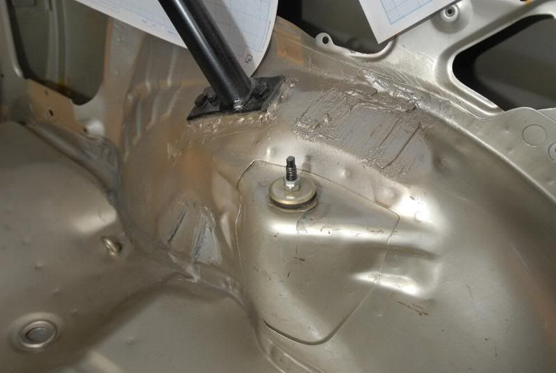

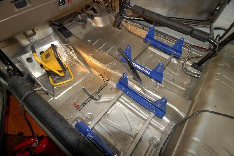

And whilst everything was masked up, and seat & harnesses was removed, I decided to lob out all the excess metal that I didn't get around to doing first time around, back seat brackets etc
http://i136.photobucket.com/albums/q...ure/nc0770.jpg

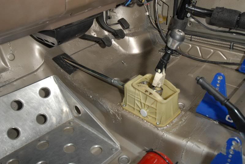

Finally shifter in, linked up - and can get all gears spot on, thanks for my wife for the help!
http://i136.photobucket.com/albums/q...ure/nc0771.jpg
