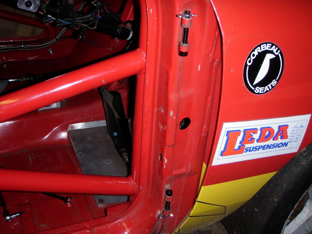

And I made up some quick-release door hinge pins for the drivers side. Naturally they are aluminium to save on weight;
http://i285.photobucket.com/albums/l...ort/022-13.jpg
http://i285.photobucket.com/albums/l...ort/023-10.jpg
