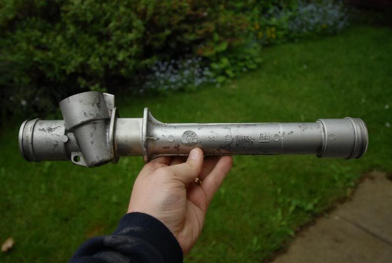

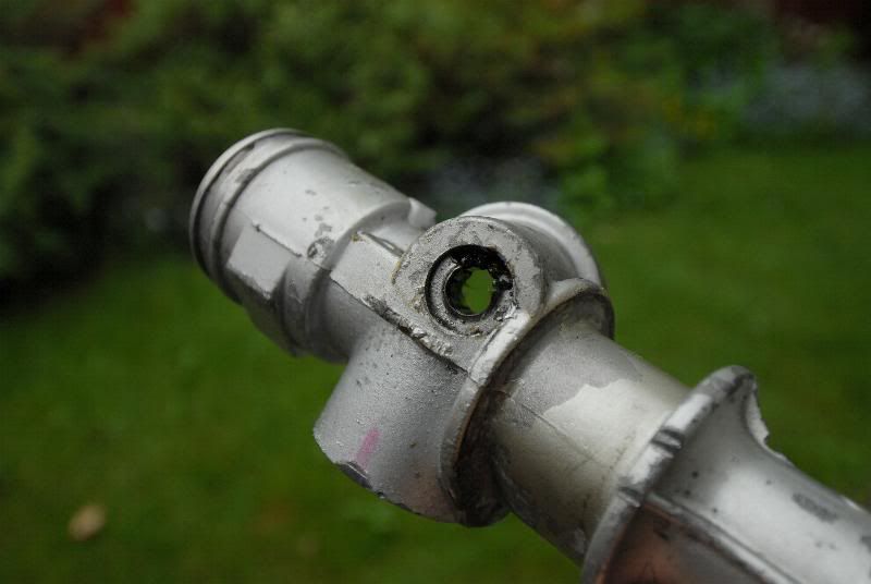

Casing which I'm going to replace now anyway
http://i136.photobucket.com/albums/q...ure/nc0757.jpg
Due to this, probably not alot wrong with it, but I can just see it being somewhere for grease to escape
