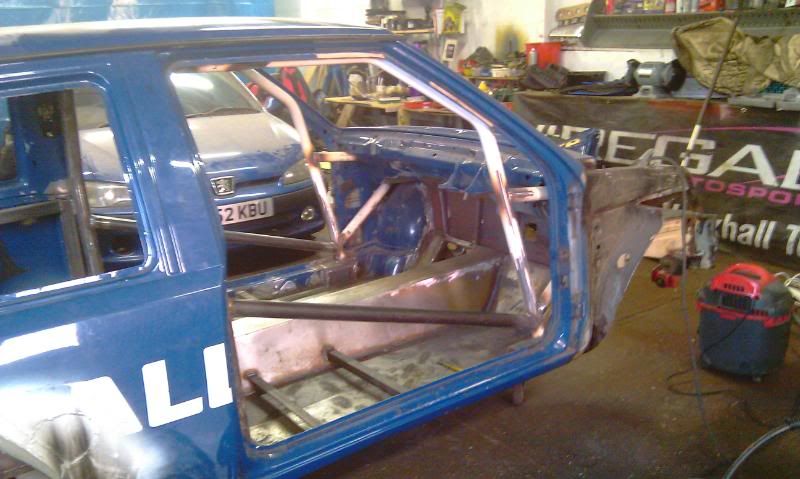

1. im estimating a total weigh in of just shy of a tonne i posted a video some where earlier on of me picking the shell up with som plyers on a tiny bracket to show how light the shell actualy is now in comparison to a standard nova shell BUT bare in mind i have alot of aditional weight that wouldnt normaly be there i.e rear diff prop ect but on the other hand the weight is more even spread and will have the added bonus of actual moving when you drop the clutch rather than just creating tyre smoke.
2.The bulk head is about 10mm further back but its a different shape to standard reason beeing is to mate up to my required shell tie in points no other reason.

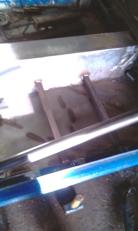

3. oem peddles are well out the window mate so it is and always has been my intention from day one to use floor mounted peddle box with remote res and convert to hydraulic clutch
4.the front end is a little more complicated and hard to exsplain but basicly the wings bumper grill ect will be bolted together on a tubular skelington so to speak and held together with dezus fastners. The skellington will be held to the car by various brackets ect from lower cross member ect out the way and ultimatly the plan is to end up with a normal opening bonnet but a fully removable front end if that makes sense aswell as the added bonus of beeing able to quickly remove individual panels for quick easy access. Theres more to it but all will become obvious when i get there but it will basicly have a lift off (or flip front havent decided yet) front end with the ability to remove pannels individual. The front cross member is not beeing replaced what you see now is the basic outlines of the finished forward chassis but i do mean rought outline
