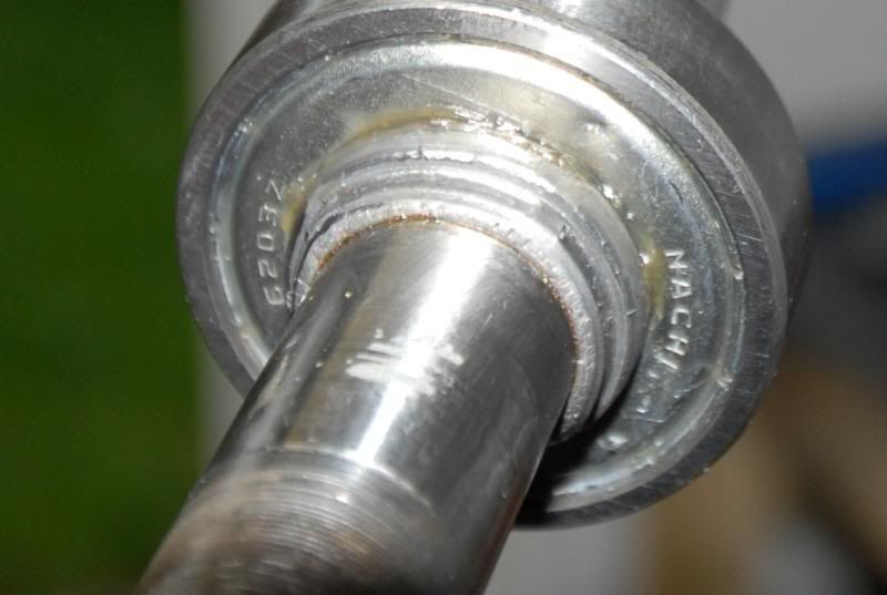

not sure on bearing size but it says on original, 30 something or other i think?

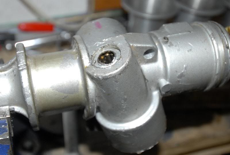

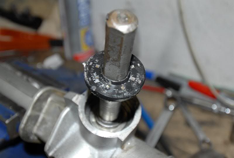

OK, back in the garage again this morning... did as you guys recommended - thanks very much!
So off with the big 26mm preload nut
http://i136.photobucket.com/albums/q...ure/nc0735.jpg
becareful as the spring inside will still be loaded

turn rack 45° to expose bearing cover, jap in a screwdriver in the edge
http://i136.photobucket.com/albums/q...ure/nc0739.jpg
prise the plastic cover off
http://i136.photobucket.com/albums/q...ure/nc0740.jpg
remove circlip, ideally with a circlip remover, not two screwdrivers, twisting and mashing the circlip as it comes out lol
http://i136.photobucket.com/albums/q...ure/nc0741.jpg

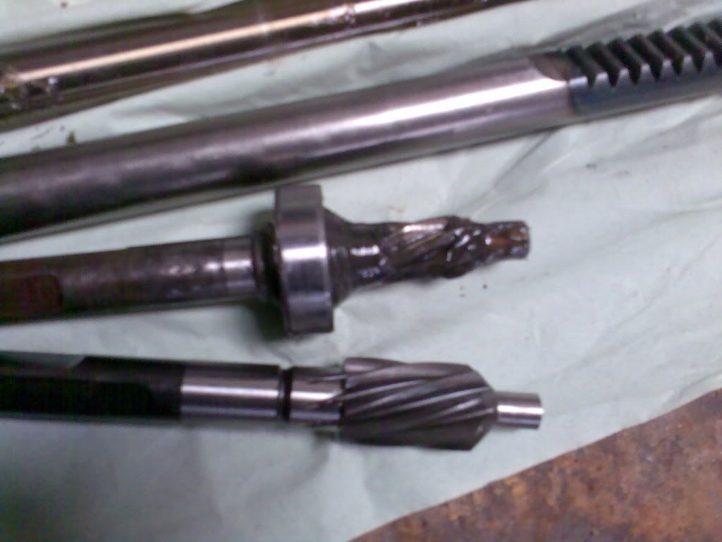

I then used a punch on the underside to punch out the pinion
http://i136.photobucket.com/albums/q...ure/nc0742.jpg
Greased up pinion out
http://i136.photobucket.com/albums/q...ure/nc0743.jpg
However, upon doing so, i've actually knocked out the end of the ally tab - is this gonna cause me problems? if so - shall I just disregard this rack an buy another now?

I presume if I call a bearing place, and give them this number, they'll know what I mean? lol

Old & New
http://i136.photobucket.com/albums/q...ure/nc0746.jpg
Part number for Harry Hockly Motorsport one, should anyone want to buy one £112 delivered

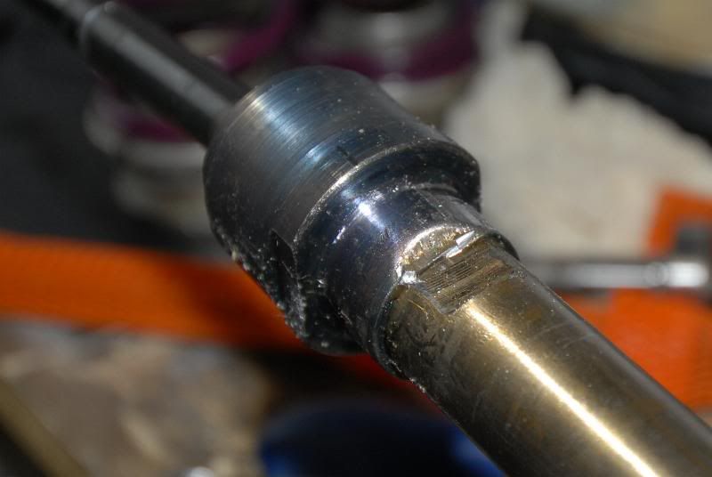

Still struggling getting the steering arms off the old rack, how do you go about knocking these out?
http://i136.photobucket.com/albums/q...ure/nc0748.jpg
Oli sir your Helemt is MASSIVE!
Looks like your having fun mate, cant say i would like to be doing that to the rack my self..
Dont them unscrew rather than knock off ?Quote:
Correct they are to be wound off not hit :o
they do unscrew, have knocked down tabs rather like steering wheel nut ollie
