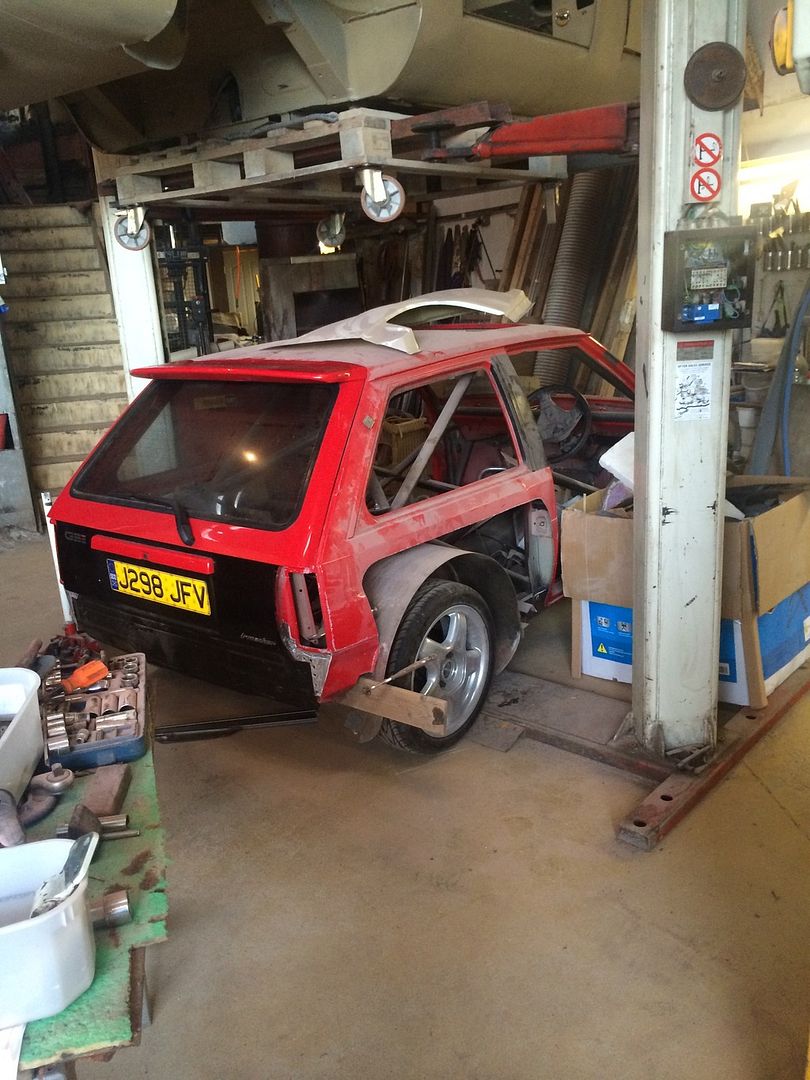

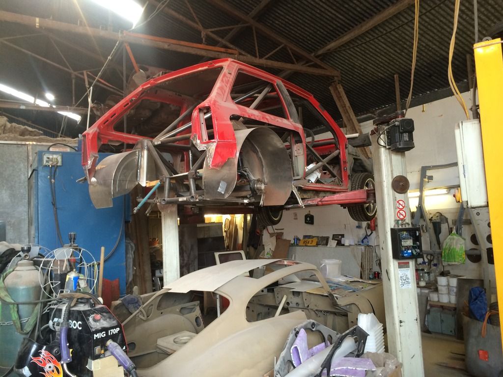

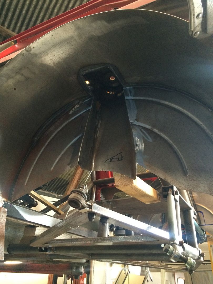

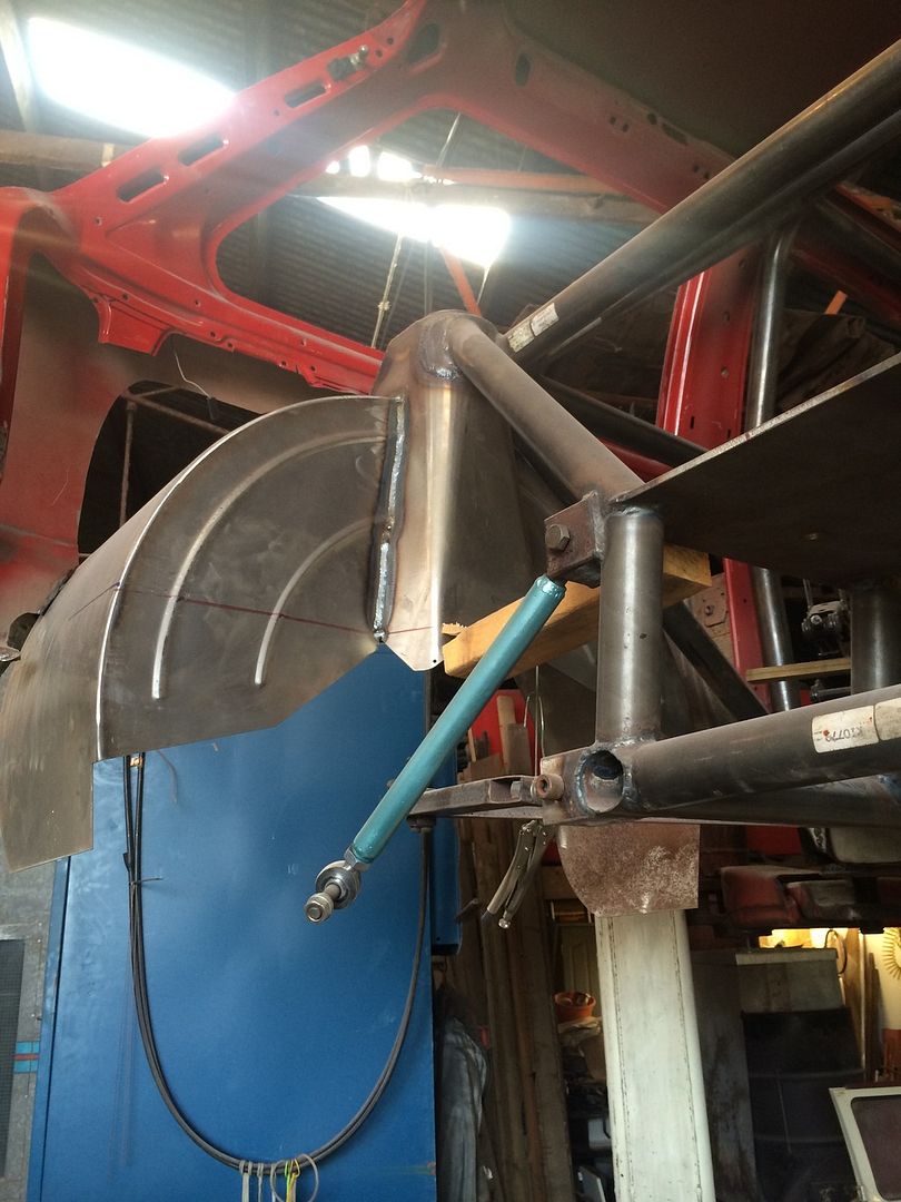

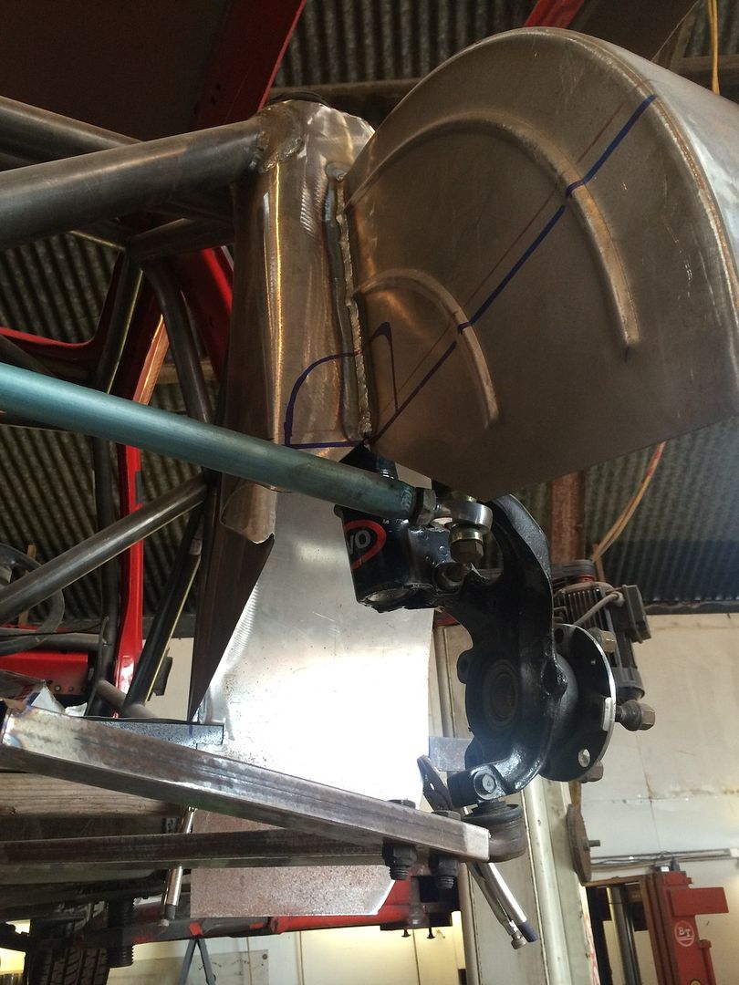

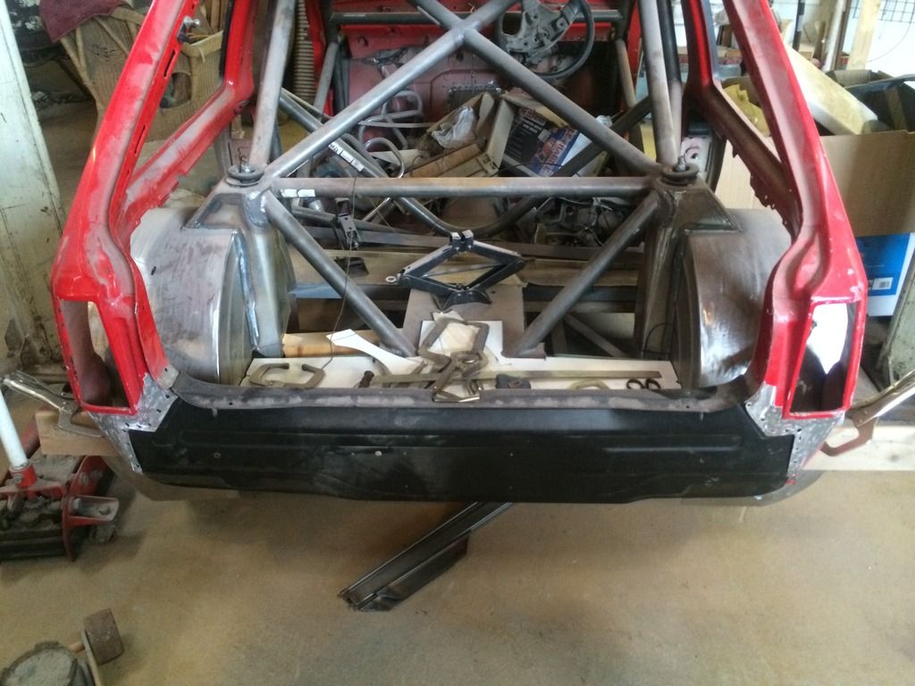

You're in luck. I went over this morning. The tubs have now been welded to the turrets. The floor is defs next.
Oh and your comment a page or 2 back about the tub height i read it wrong lol yes the tub had to be modified as it was fouling on the cage.

Should be alright; if it were mine the tubs would be a little higher & the diff frame a lot higher.
I thought the diff Frame seemed low also. All looks fine with the wheels on though. It's all in like with the tunnel so really couldn't go much higher. I think it'll be all good though. If not it's getting scrapped lol

Diff frame does look low

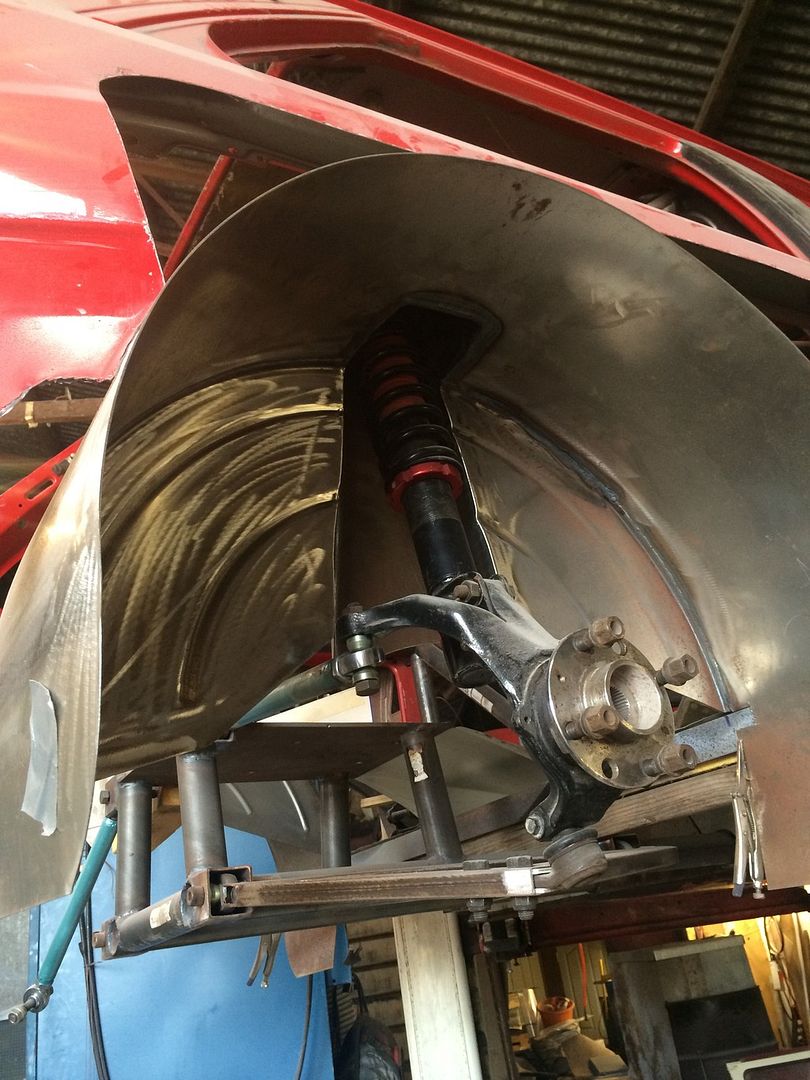

Here's a few pics of the level the diff frame is at. It's at the same level as the floor so really shouldn't be an issue.

If it's level with the floor then you're pretty much sorted then! Think it just looks low with the sills cut off and no rear end.
This should take some proper abuse with the level of work gone into it.
Yeah it defs looks lower than it is. Will be all good.
Hope so as it'll be getting punished lol

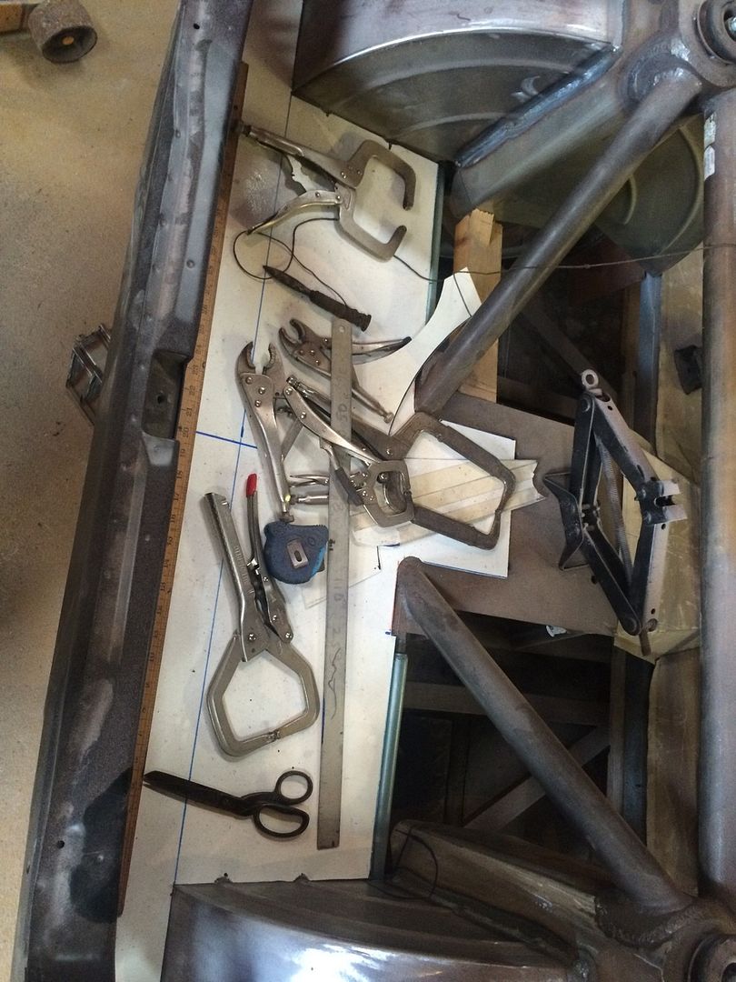

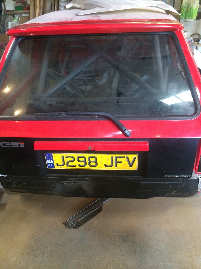

Another little bit done today.
