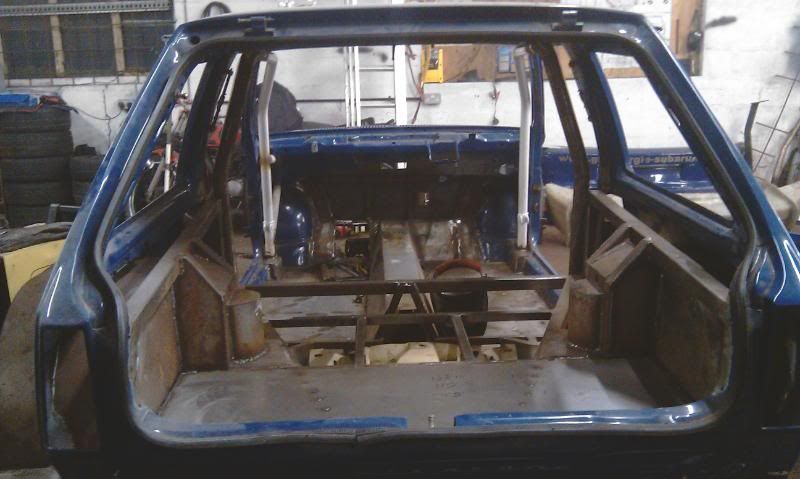

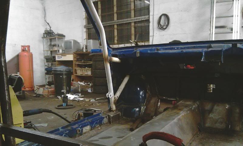

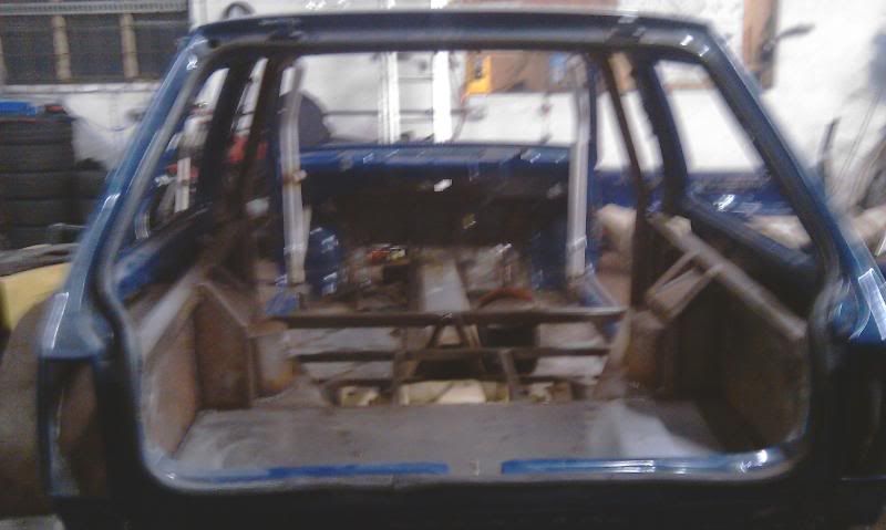

http://img.photobucket.com/albums/v6...r/IMAG1023.jpg
http://img.photobucket.com/albums/v6...r/IMAG1024.jpg
http://img.photobucket.com/albums/v6...r/IMAG1025.jpg
http://img.photobucket.com/albums/v6...r/S7300077.jpg
thats it for now i have actualy done a hell of alot more that what you may realise or what seems obvious but its all been little bits like welding seems closing gaps and patching all the little holes that vauxhall for some reason deemed fit to put in the pannels but its all stuff thats needs doing and takes ages fabing and shaping plates ect but is hardly noticable so i didnt deem it worthy of pics

im hoping to have it blasted final fab done and in epoxy primer before pvs ready to start the body work

i have come to a little bit of a holt on this again today as i am now awaiting roll cage tubeing but wont be long
