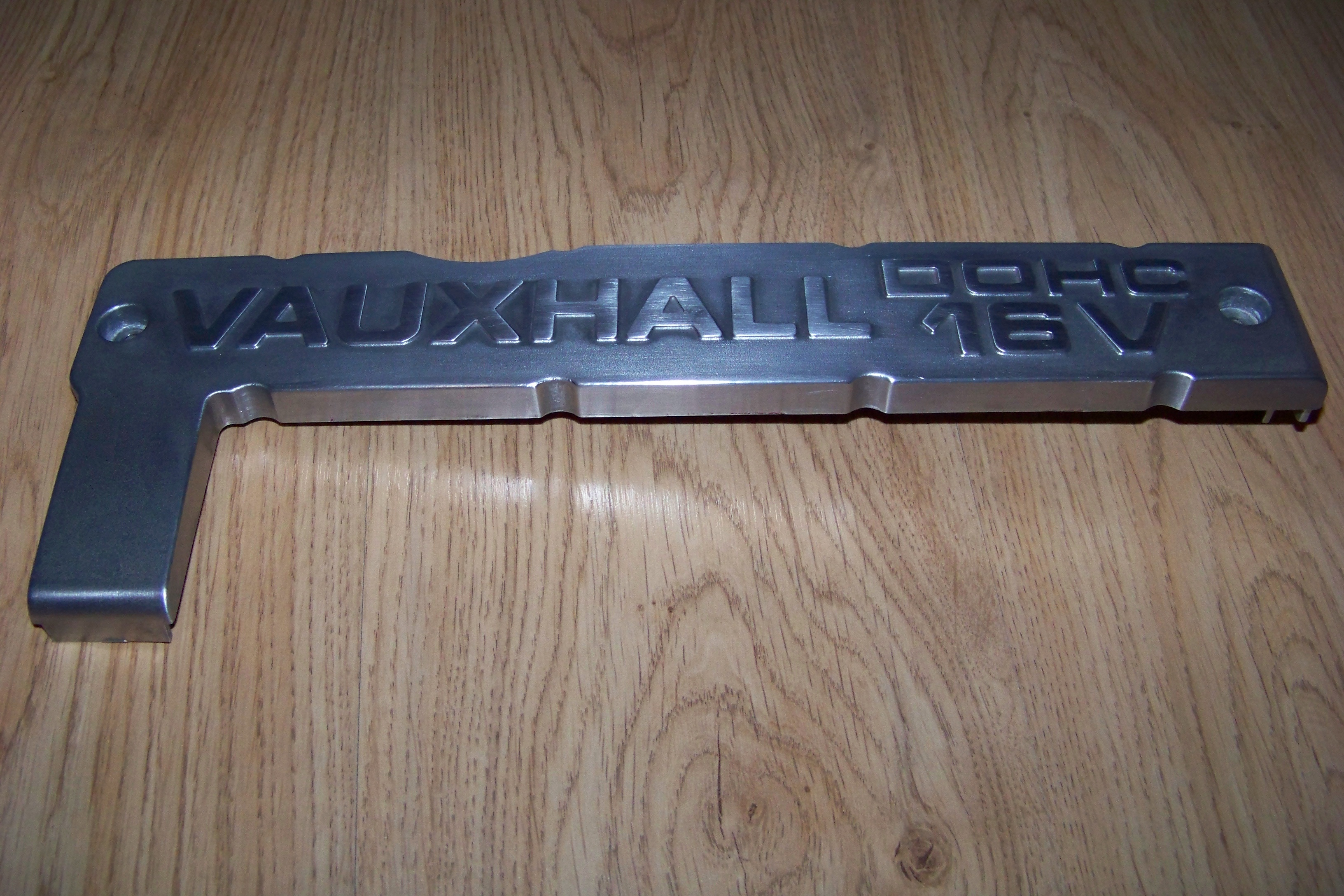

Continued from where I left off... the plug cover was almost fully stripped but there were some hard to reach areas. Left it in some more dissolver solution to get accessible areas stripped and then did the final areas by hand. Areas such as lettering, corners, and anywhere else the solution didn't submerge. I attacked those bits with some Nitromors, wire brush and sanding blocks. After witnessing how quick the dissolver was, Nitromors felt like it took absolute ages to do it's work.
After a good 2 hours or so for those small areas and a good going over with medium grit wet and dry I got the spark plug cover to this stage
https://images2.imgbox.com/43/83/BvVuNZ55_o.jpg
http://img254.imageshack.us/img254/9840/1003057.jpg

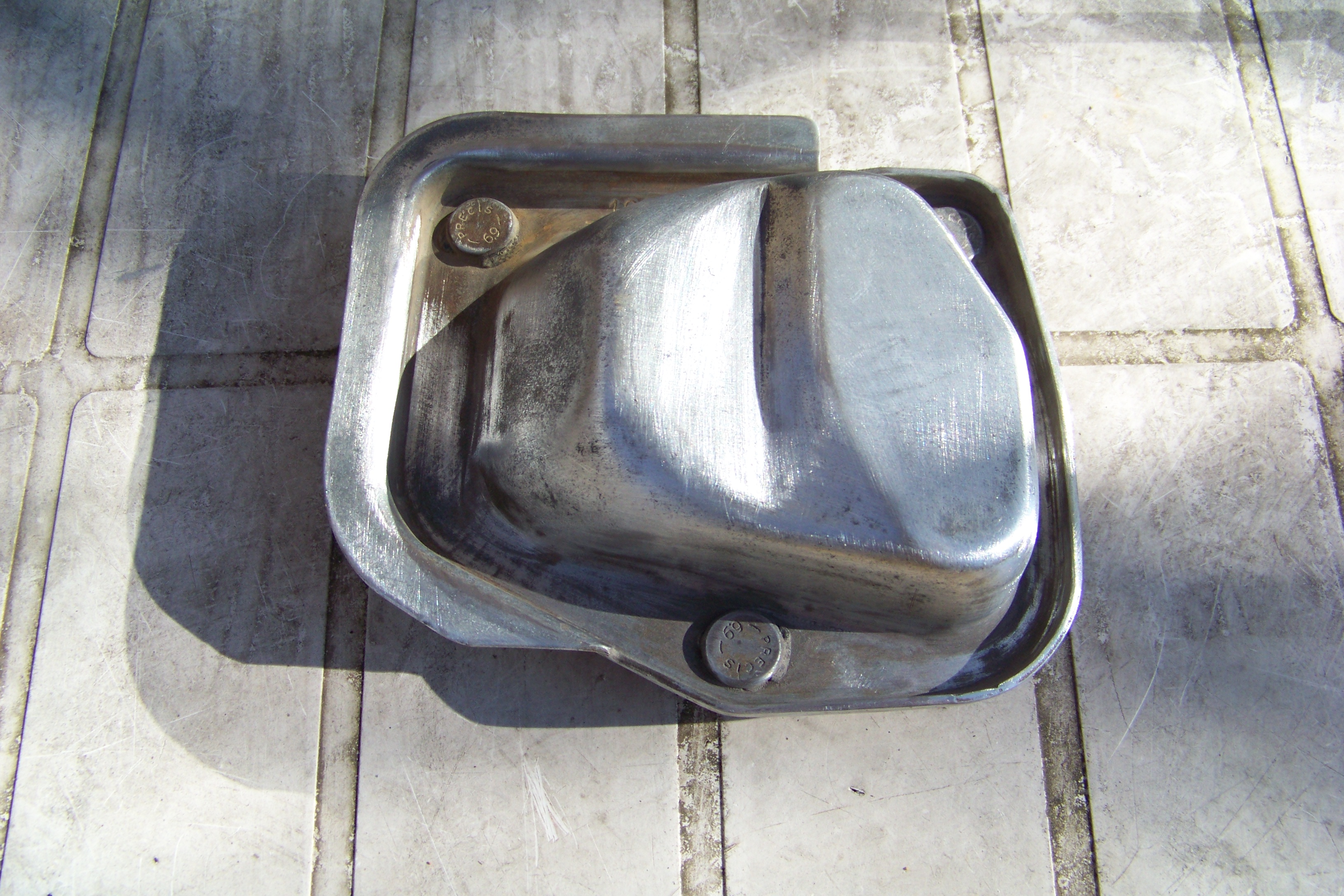

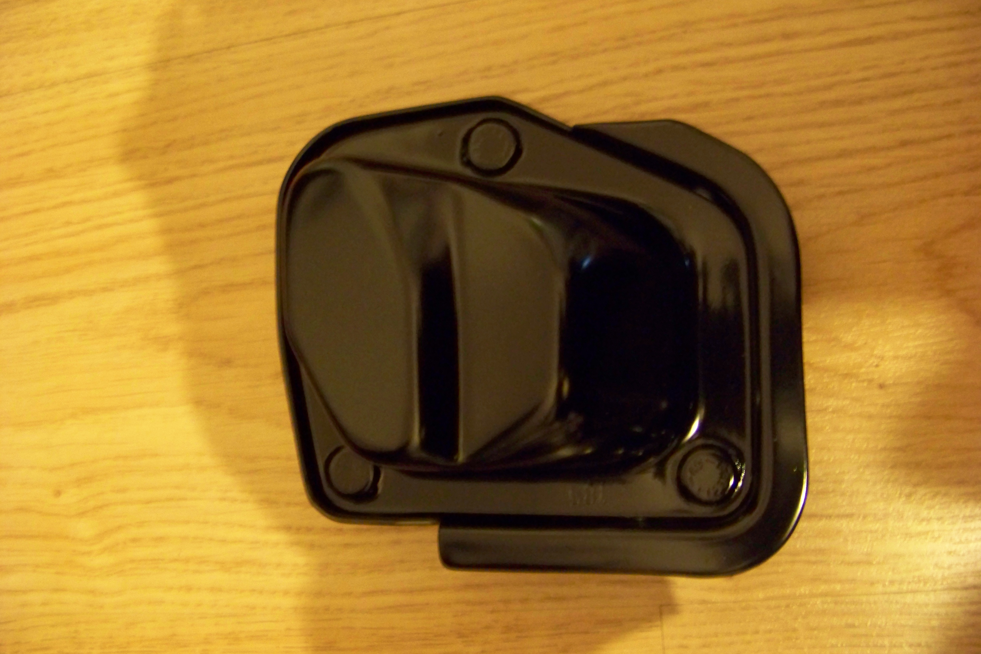

Due to the weather being nice yesterday it got me in the mood to do some stuff. In this case, some painting.
Had a look around the bay and saw the brake pedal blanking cover looking shabby (left side of the bay). I still wonder why they have that cover there on the Nova's. Why would there even be a cut out in the firewall if the brake servo was always going to be on the passenger side. The location of that cover is perfect for a servo to sit there. Was it just a case of no room to have it there or is there another reason I'm unaware of? Odd... but needed taking off and painting anyway
Rubbed it down and gave it a good clean
https://images2.imgbox.com/cb/c1/2Thry30Z_o.jpg

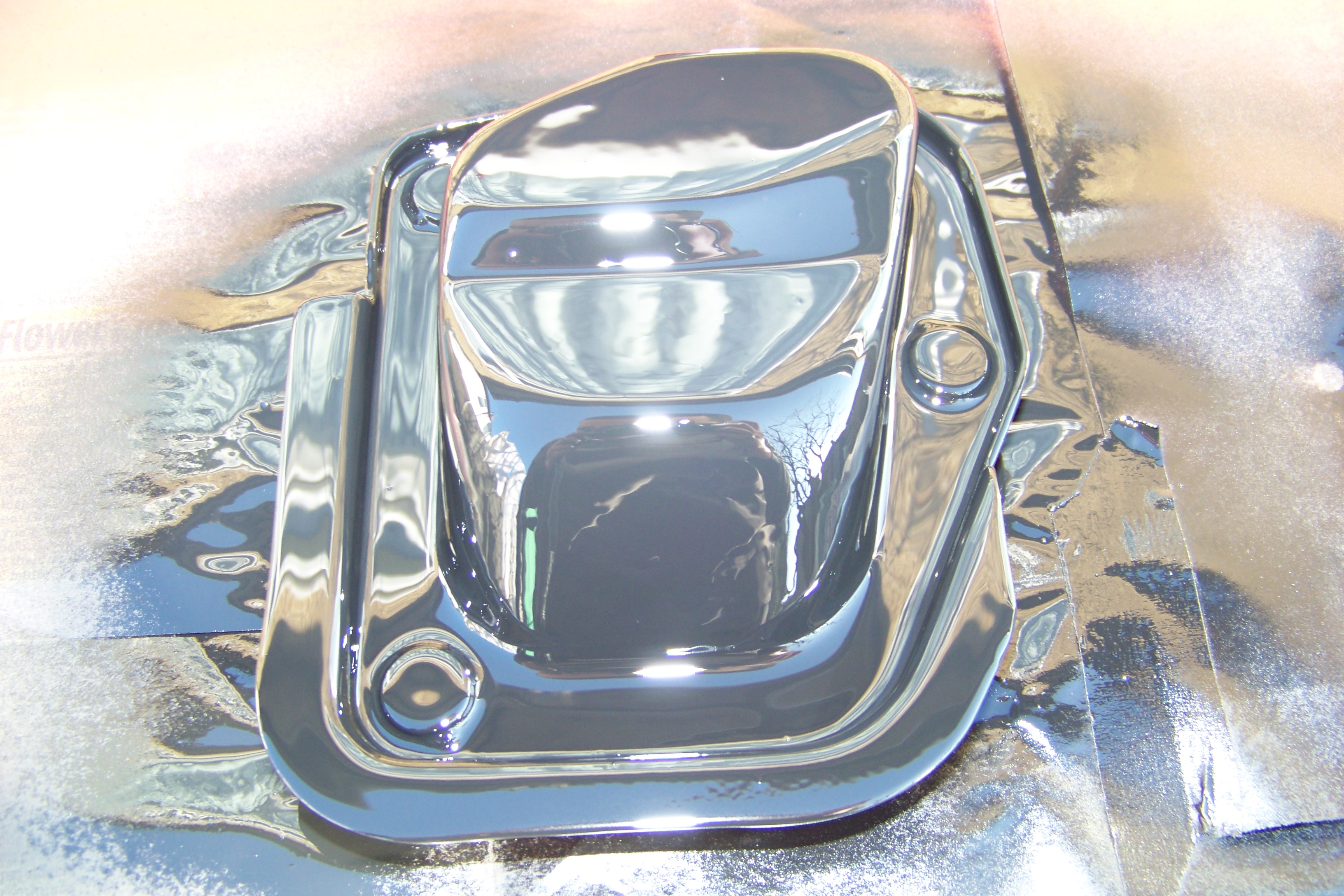

Then gave it many coats of enamel black paint for a really durable finish
https://images2.imgbox.com/63/97/yaBOTNhW_o.jpg

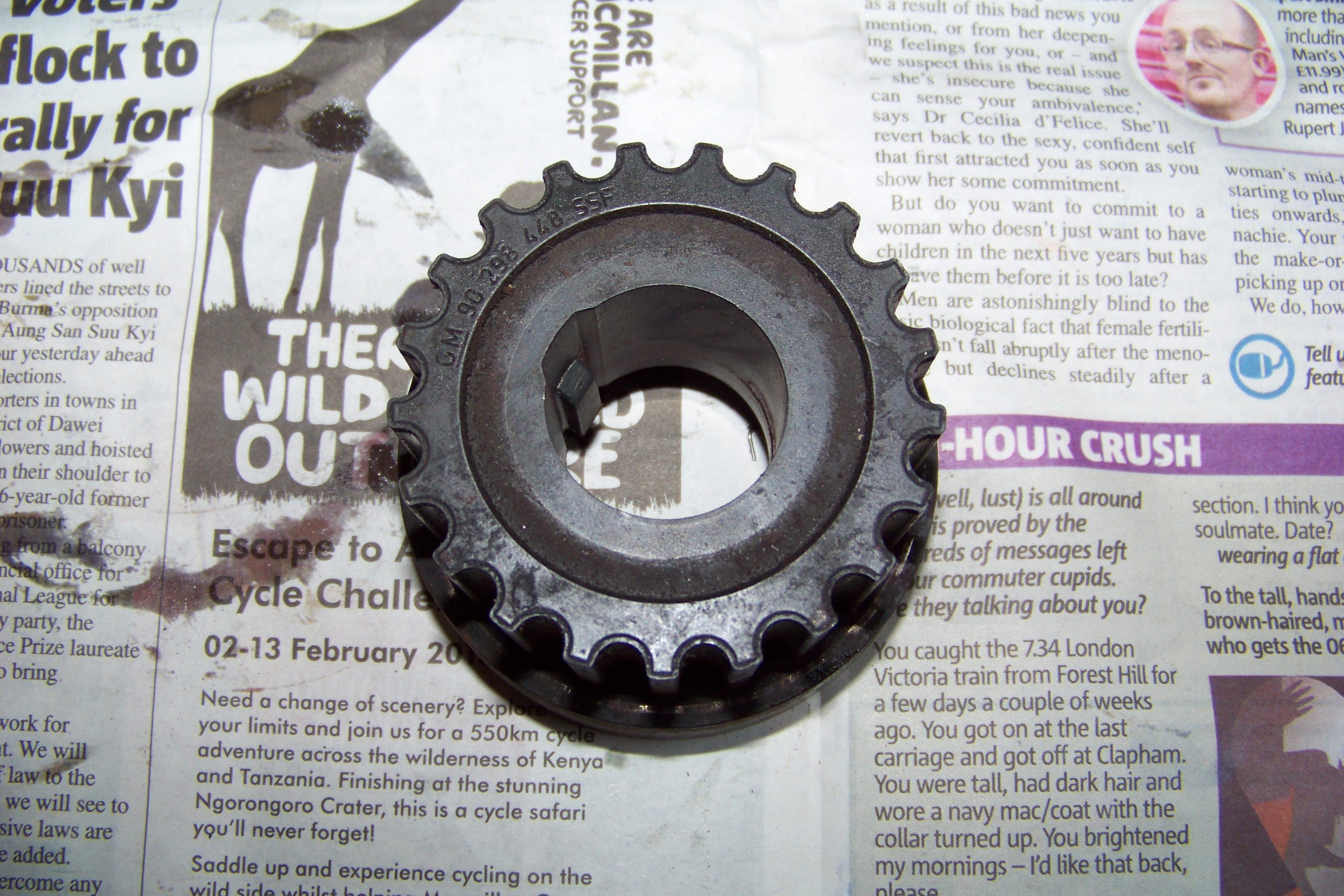

Early toothed crank pulley with an intact clip
https://images2.imgbox.com/b5/00/6tSbFZO0_o.jpg

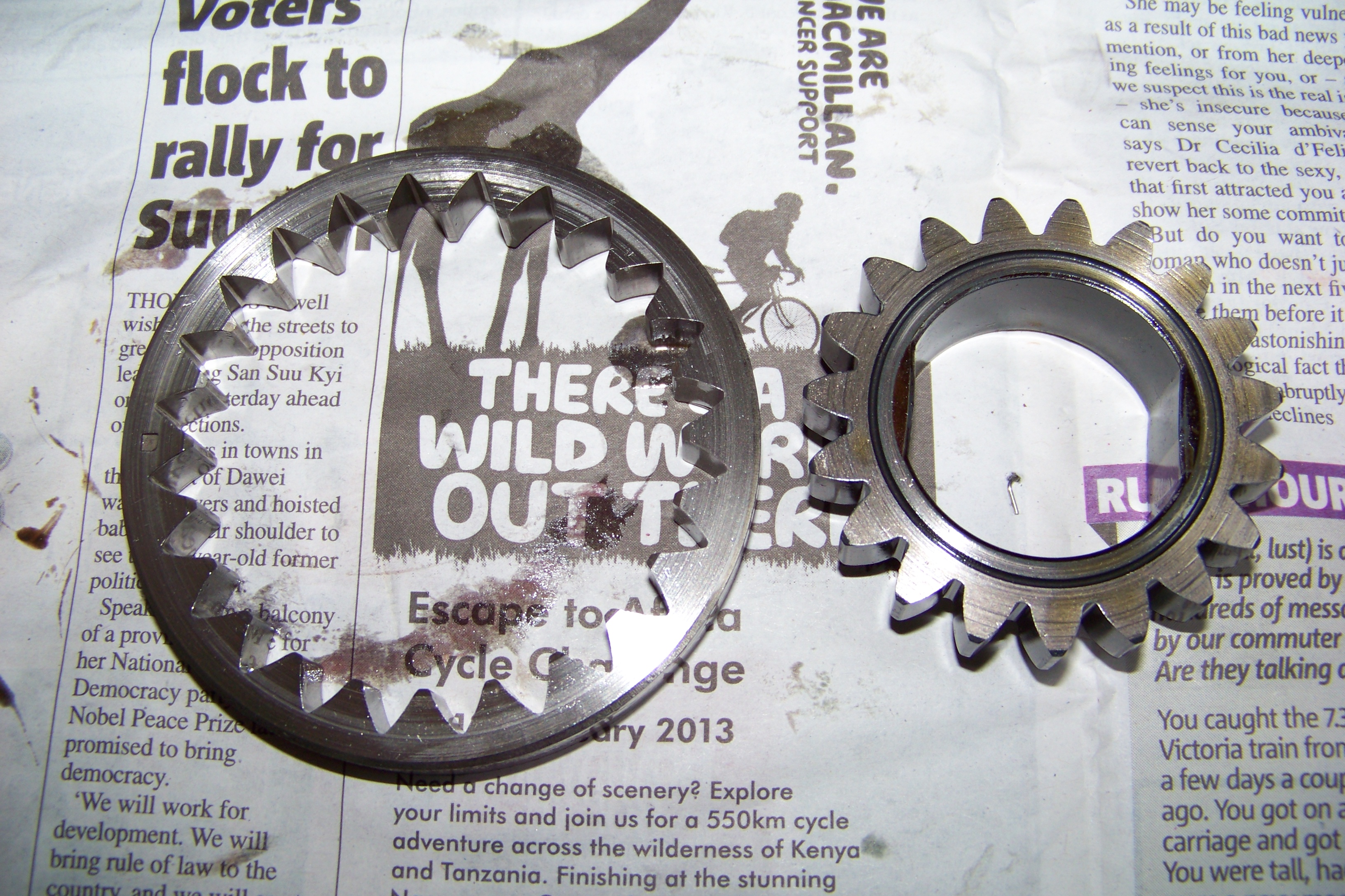

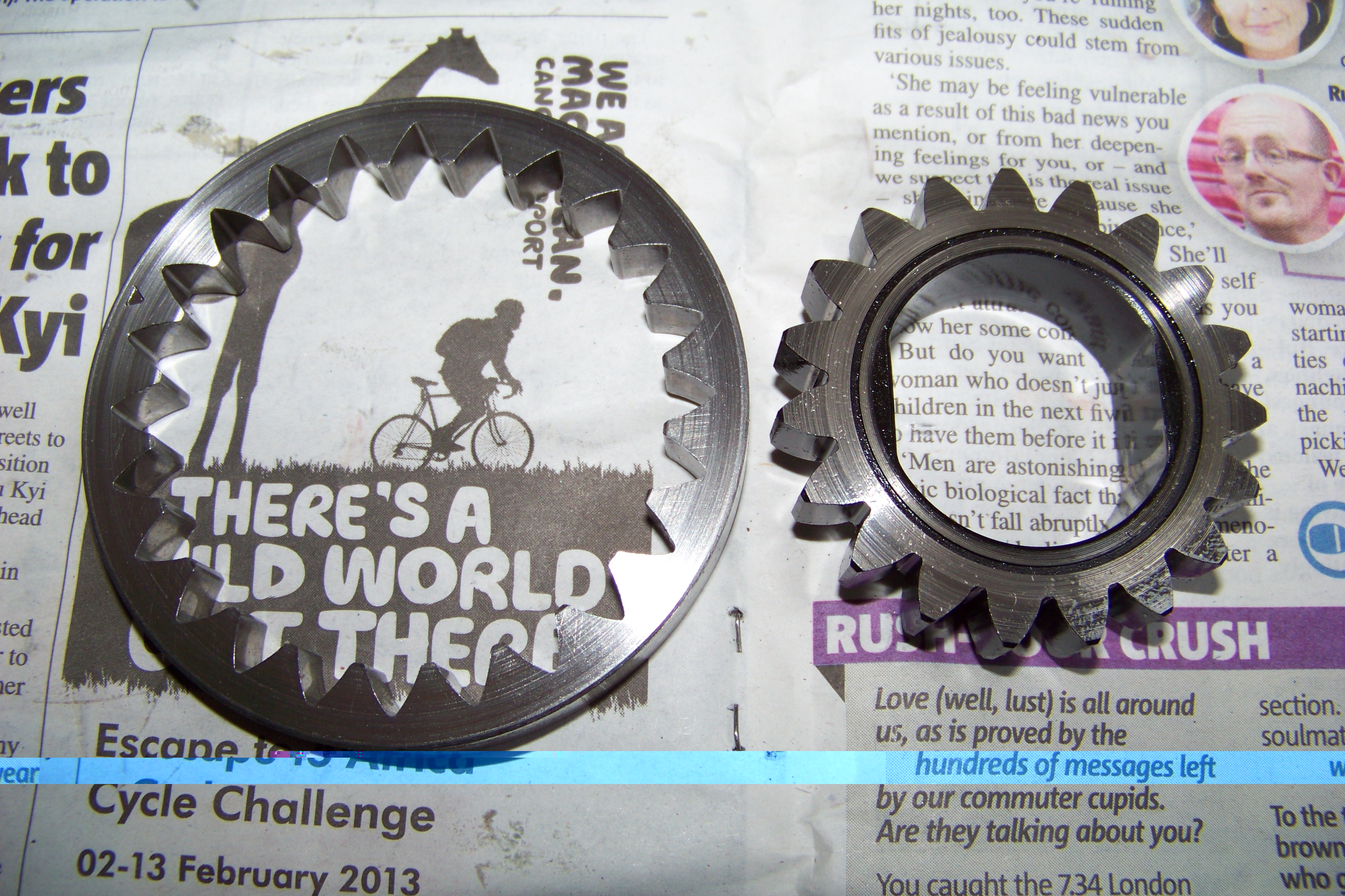

A set of slightly used SBD pump gears (any ideas what the little triangle is on the larger gear?)
https://images2.imgbox.com/3a/98/nmEpBBaB_o.jpg
https://images2.imgbox.com/92/8e/nCYP2bzR_o.jpg

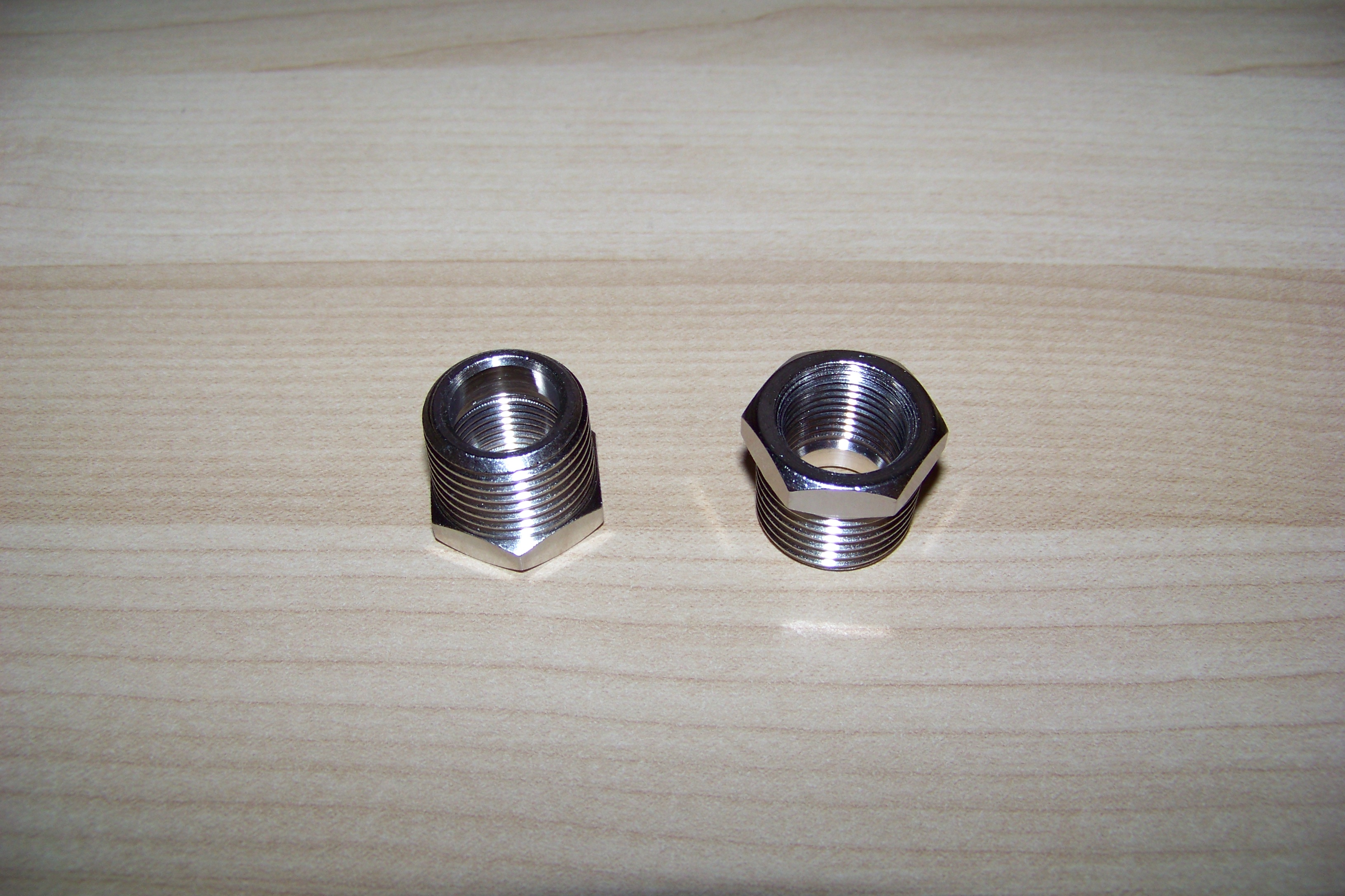

A pair of 1/2bspt to 3/8bsp reducers for my oil cooler. Searched high and low for these and managed to find the correct size and only cost a few quid woohoo!

After leaving the blanking plate in the garage overnight, here's how it looked
https://images2.imgbox.com/5a/3a/pI4K8rqQ_o.jpg

I think the markings on the large oil pump gear is for fitting direction? Isn't there a circle on the other side or something? Haynes tells you which faces outwards
How do you know they're SBD ones, they don't look any different to me
Yes there is a dot on the otherside which is the side which faces you but the old gear had a square mark on the underside and these new ones have a triangle. The chap sold me his pump which had SBD internals including relief valve. He had swapped his oil pump for a modded zLET. He is a MIG member for a while so there were no reasons to doubt him. The gears are tighter anyway my gears were boardering worn. He sold me the lot for a very good price so it was worth it.
