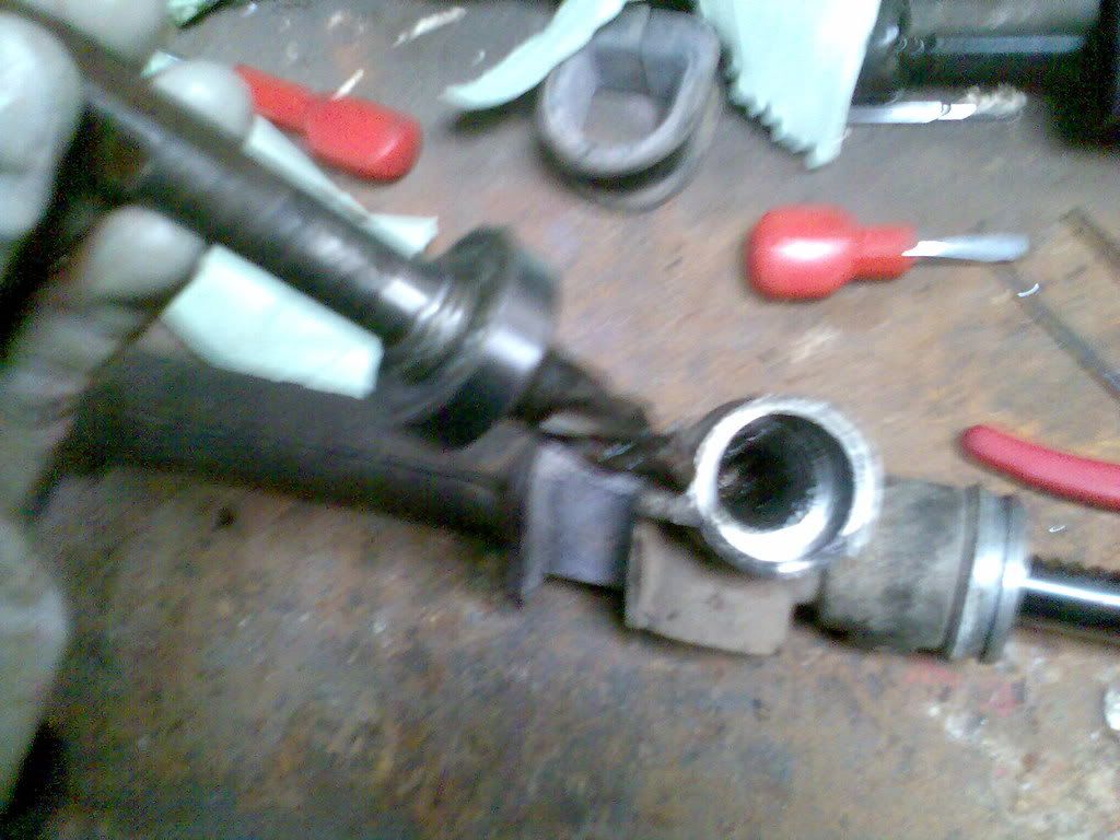

http://i46.photobucket.com/albums/f1.../Oldpinion.jpgQuote:
