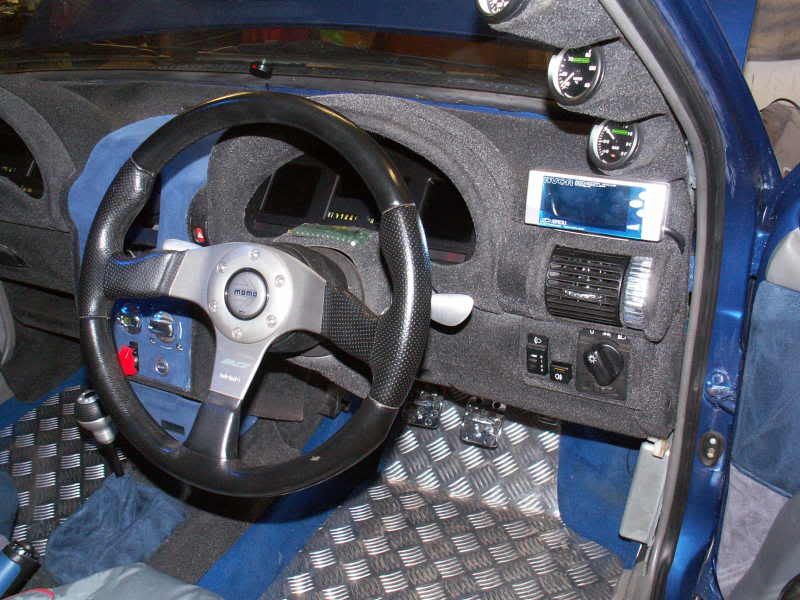

I thought about the best place to put the controller and have come up with here .....
http://i2.photobucket.com/albums/y15...ova/Apexi1.jpg
http://i2.photobucket.com/albums/y15...ova/Apexi2.jpg
Seems to nestle quite nicely on the end of the dash and is in easy reach for the all important tweaking when setting up.

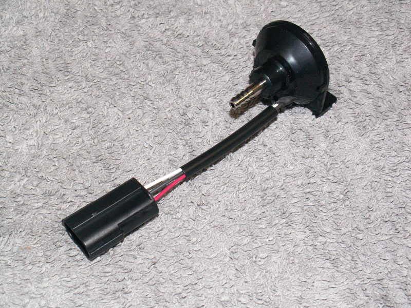

http://i2.photobucket.com/albums/y15...ova/Apexi4.jpg
This above is the boost sensor - easy to plumb in from the feed to the fuel pressure regulator.

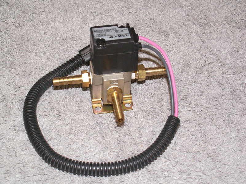

http://i2.photobucket.com/albums/y15...ova/Apexi3.jpg
Now this part above has me foxed a bit - I assume this will take the place of the amal value (which will be left wired in) but I am unsure which pipes should go where - any advice much appreciated !

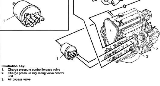

So thats the wiring issue sorted ! The plumbing bit I think goes from the standard piping which looks like this ....
http://i2.photobucket.com/albums/y15...ontroller1.jpg

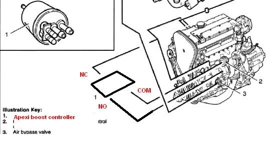

To this with the Apexi controller....
http://i2.photobucket.com/albums/y15...troller1-1.jpg
Can you chaps confirm this is the correct way of plumbing in. Basically capping off the pipe to the turbo and the controller has the wastegate pipe on COM and the breather pipe on NC.

hey joff got some pics and diagrams on my computer at home will pm them over to you myn is different as im running an external waste gate but ill work the plumbing out for you and send it over later
