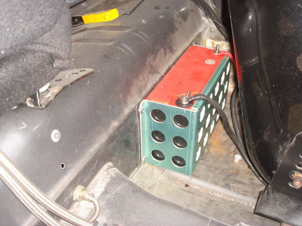

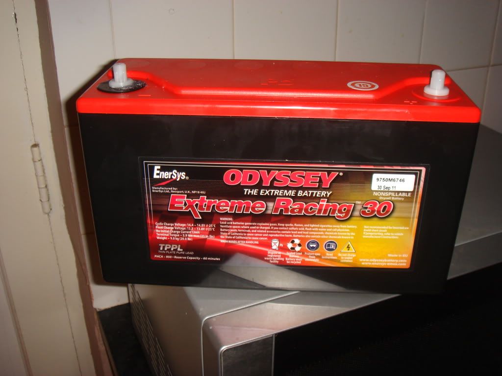

I thought I'd start with my new battery that turned up last week.
http://i761.photobucket.com/albums/x...0/DSC04223.jpg
Fitted in the car with its nice shiny FIA spec bracket
http://i761.photobucket.com/albums/x...0/DSC04224.jpg

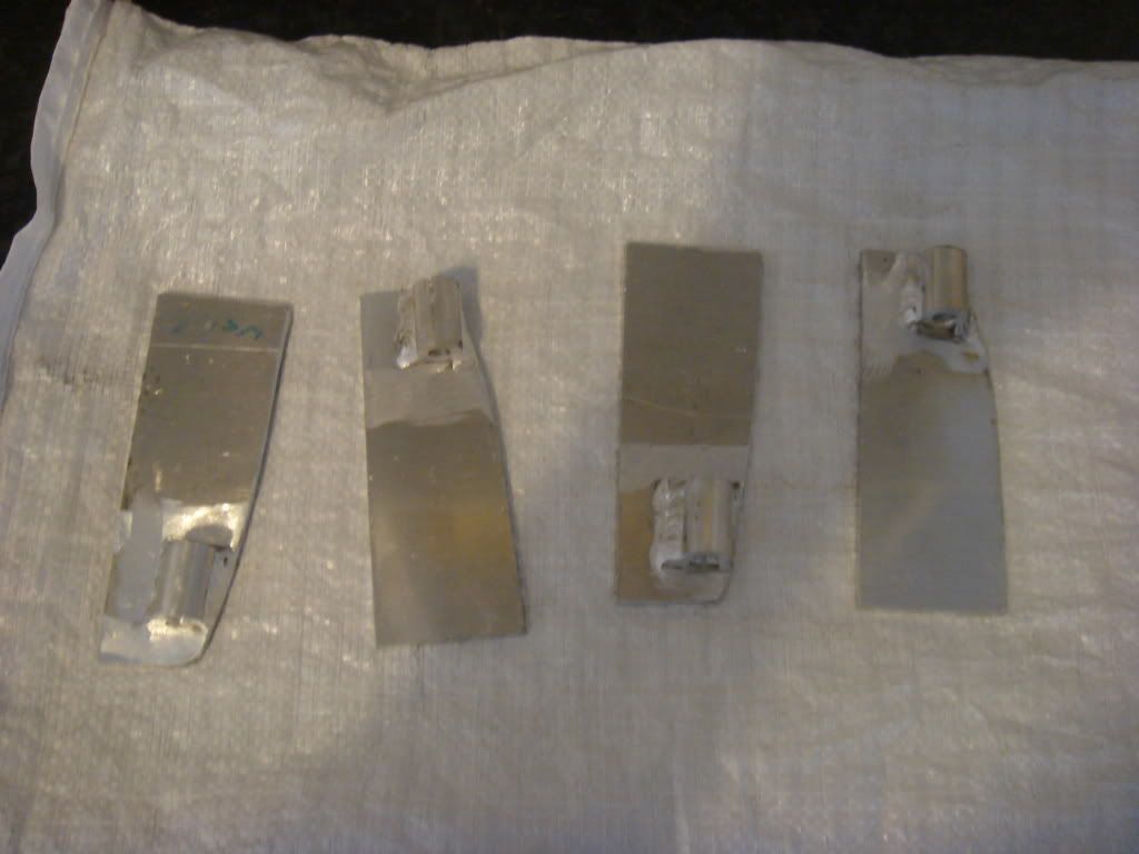

Also manged to get the Aluminuim door hinges tig'd you turned out quite well really
http://i761.photobucket.com/albums/x...0/DSC04234.jpg
The weld.
http://i761.photobucket.com/albums/x...0/DSC04235.jpg

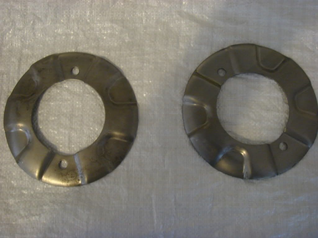

Also bought a strengthening kit from dave of griffin autosport.
http://i761.photobucket.com/albums/x...0/DSC04232.jpg
The strut tops from HHMS

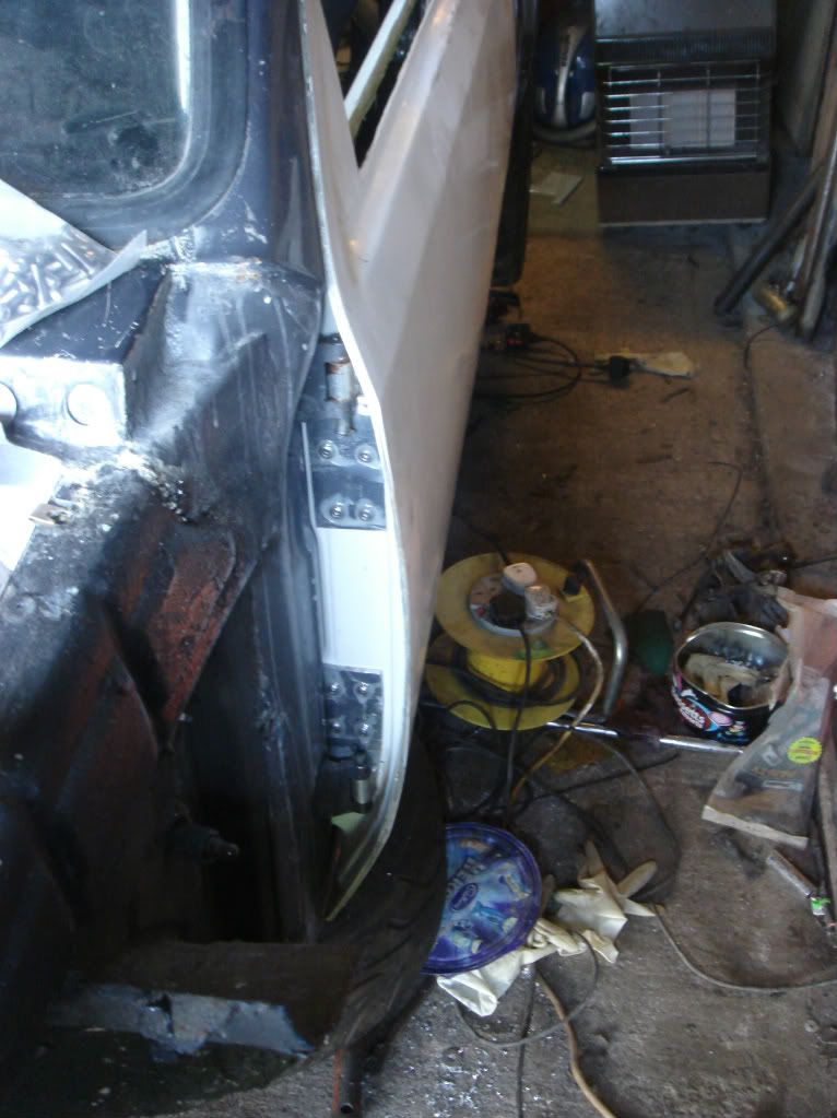

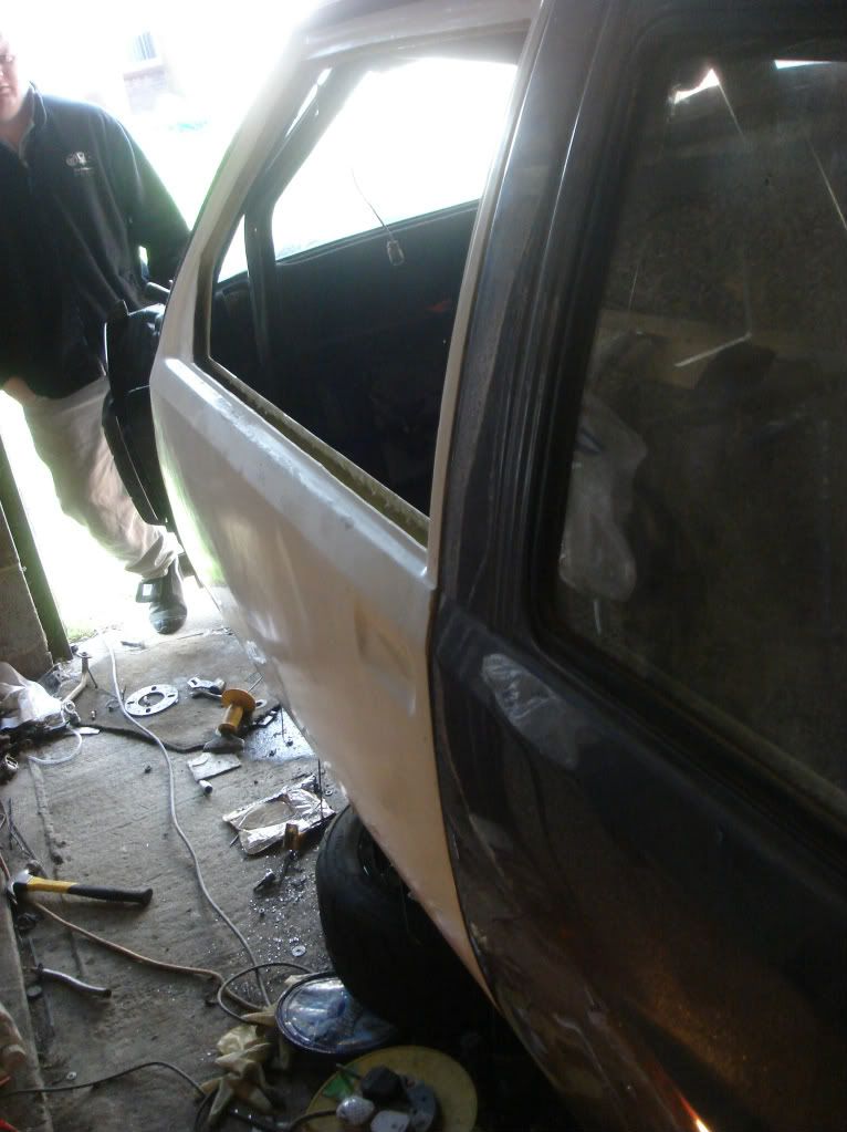

We started by mounting the passenger door because i'd already fitted the lock system to it.
Outside
http://i761.photobucket.com/albums/x...0/DSC04238.jpg

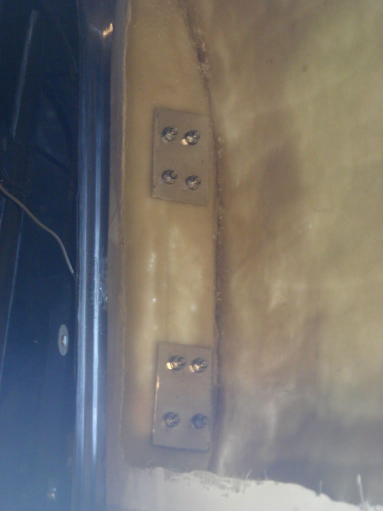

Inside
http://i761.photobucket.com/albums/x...0/DSC04240.jpg
As the door sits
http://i761.photobucket.com/albums/x...0/DSC04239.jpg

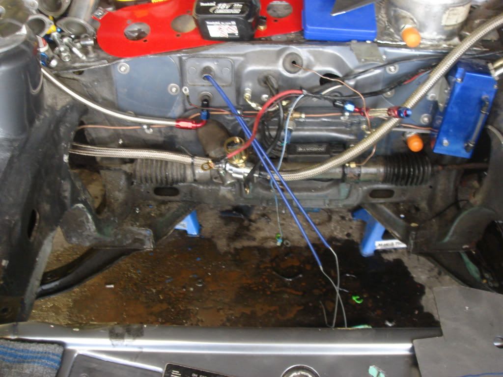

We then spent the afternoon taking the engine out as carefully as possible Took myself jed and wwmnw about 2hrs and we were left with this.
http://i761.photobucket.com/albums/x...0/DSC04241.jpg
Its going to My mates paintshop next weekend so he can colour in the outside and boot floor area but I'm not sure if i should rattle can the engine bay or get him to paint it properly. :confused:
We fabricated the aluminuim hinges by getting some 4mm and some 5/8 (16mm) aluminium bar. I had the bar turned into barrels on the lathe at work 25mm in length with a 8mm hole in the middle. We then cut and filed the plate to match the contour of the door lines and drilled four 5mm holes in the hinge and through the door skin, then tapped the hinges to M6.using some M6x20mm button head stainless bolts, they were threaded through the hinge and the head was smeared with epoxy glue so they wont wind back out. the holes in the door skin were enlarged to 10mm so there is movement to adjust the door. we then copied the hole pattern on another piece of aluminium to go on the inside of the door. which we tigthened up using M6 washers and nyloc nuts.
