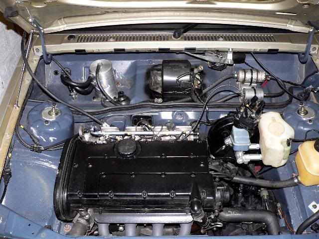

Thanks to Dar (again, broken record lol) for sorting a MBE loom out for me, the one I was sold was for a RWD car
First thing, fitted that
http://i136.photobucket.com/albums/q...ure/nc0499.jpg

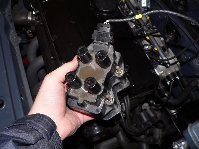

Anyone know how to tell which which plug is which pot on an SBD coilpack? there are no markings on it whatsoever

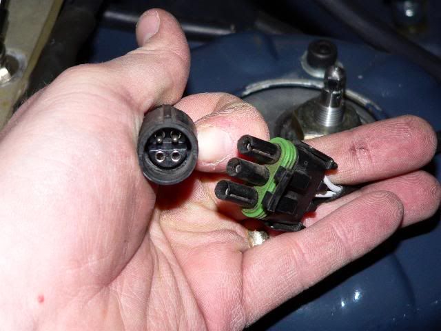

Throttlepot plugs are different to each other - are these interchangeable items?

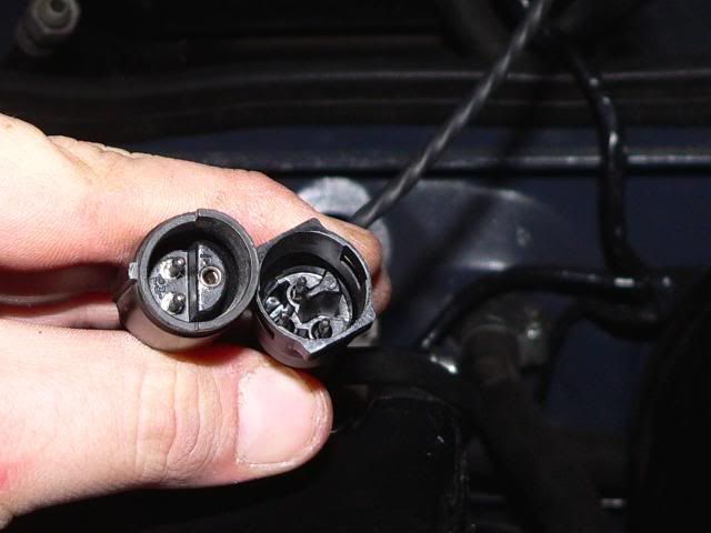

As is lambda, again - can I change them?

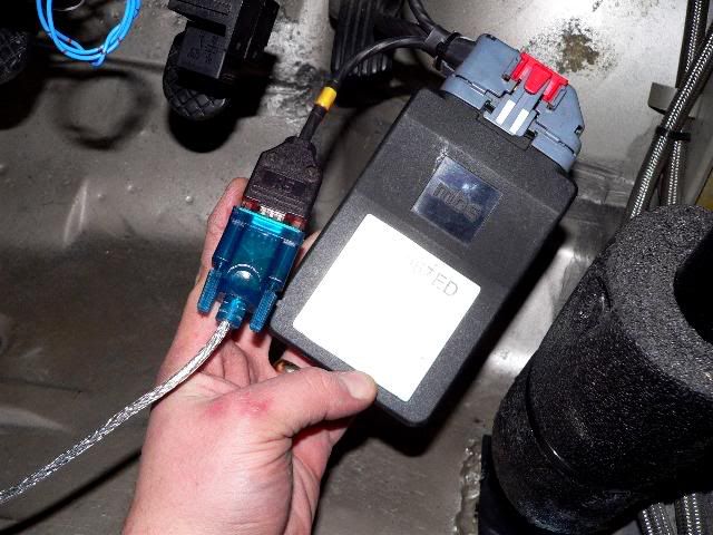

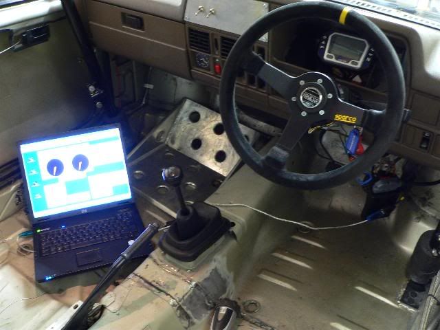

For some reason, having difficulties still, connecting the laptop to the ECU
http://i136.photobucket.com/albums/q...ure/nc0503.jpg
Using a USB-Serial lead straight into the COMMs port on the loom to the laptop, but just doesn't want to know...... ?

I take it you have loaded the drivers for the serial adaptor? If not then it probably doesnt know what the feck is going on lol
Do you have any other serial devices to make sure the ports actually working?

Some software wont work with a usb-serial adapter. See if you can borrow an older laptop with a proper serial port, or cart a PC into the garage to rule that out.
Lee - do you have a SBD coilpack? can you tell me which plug is which pot, if possible, can do it by the electrical plug, going clockwise or something
Ol im sure mine has them numbered up, very small inprinted numbers by each pot.Quote:
Ill look through my pics, but no promises.

Oli - Please don't tell me you just put the loom in there and that you wired it up and powered it up first to make sure there are at least no dead shorts:eek:
If you haven't wired up the interface plug yet then take off your MBE system!
Now thats out of the way you can forget about the lambda sensor since your ECU will not be taking advantage of it. Find the SBD Taper Throttle Bodies installation instructions and go to page 6 for a diagram of the coil pack. It will show and tell you all you need to know.
For information on what interfece wires do what go to page 15. But here it is below.
You should really strip off the casing on that loom and make sure that the wires are still ok and that the insulation is intact before plugging in your MBE system.Quote:

Once you are happy that its all ok, you need to give the loom power (I would also fuse the +ve side of the loom). Then turn on the ignition with Easymap 5.5 loaded and your laptop connected to the loom. If all is well you should hear a little ping from the laptop and you will be connected.
You will find that sometimes the data speed needs adjustment on the laptop although I only have this problem with the innovate wideband not Easimap.
Go off pin numbers too not the colour of the wires as there have been changes in certain plug adaptors as I found out lol
He will be ok the interface he needs to wire up consists of just four (known to be correct)wires and not the actuall ECU plug.
