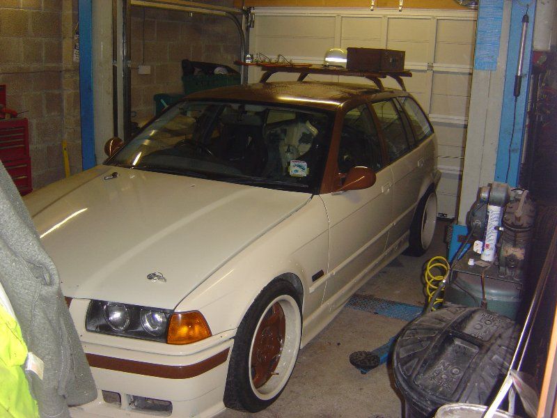

Had to drive the car tonight to make way for this thing.

Drift car?
Aye, easy to spot arn't theylol
nice wagon Dar.
strange, I didn't find my 4 paddle that harsh... thinking on it, it is sprung lol
I saw that beemer turning off your road when I left the other day, didn't reliesed it was stripped tho. What's the story?

It's a drift car so the diff is welded, we fitted the hydrolic handbrake this evening as well as a few other bits and bobs. It has HUGE wheels on it which isn't great for drifting. Nothing mental about it but it's awesome fun. It has different suspension etc etc and a modifyed M3 engine, nothing to mental though.Quote:
Originally Posted by Ash
The most intresting thing about the car is that the genuine German WWII firemans helmet on the roofrack glows in the dark :D
