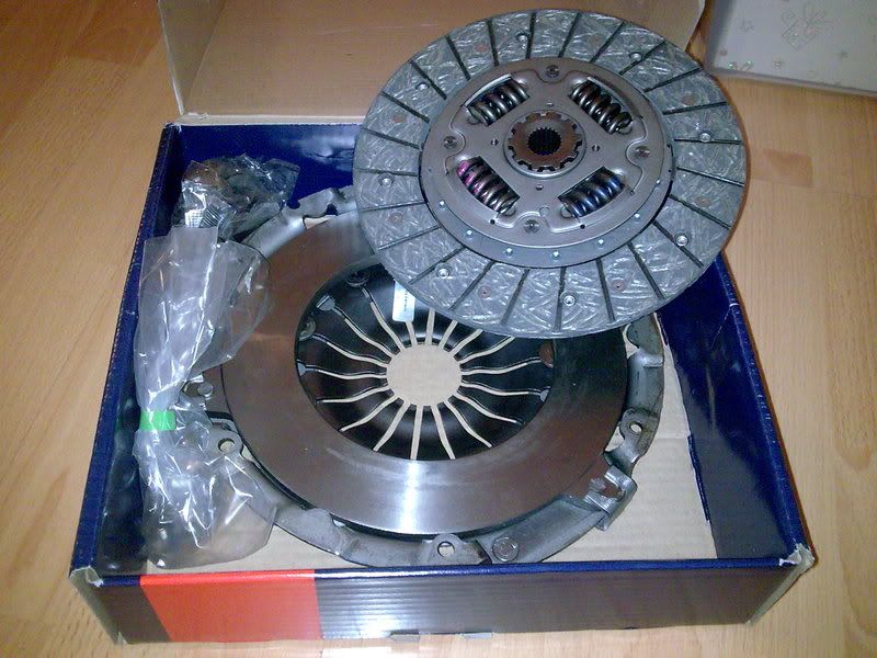

Update time. Got a QH clutch kit for the engine build. Just need to get my ARP's and then thats everything I need for the bottom end:thumb:
http://img.photobucket.com/albums/v3.../ClutchKit.jpg

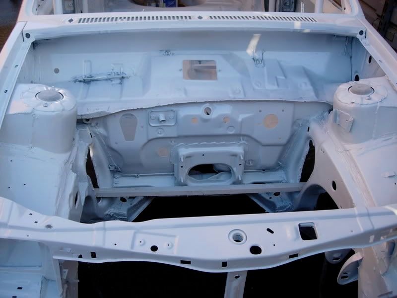

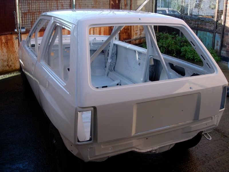

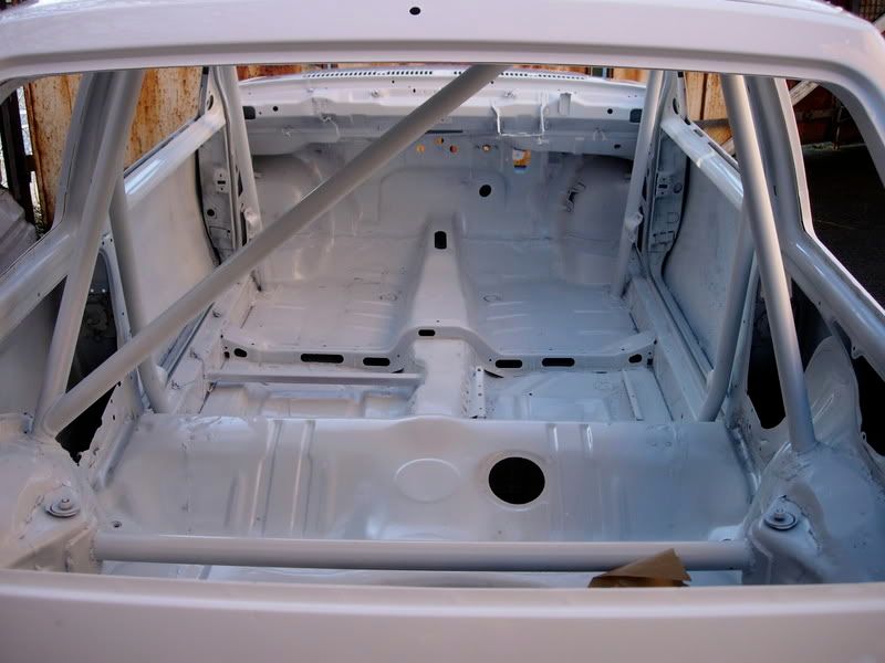

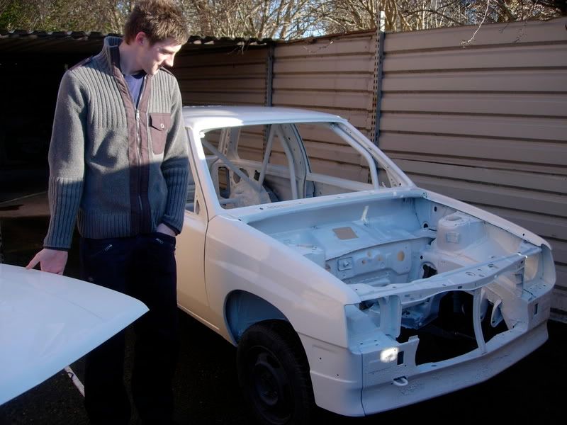

Another small update... Got a phone call in the week from the bloke who was meant to be painting the car, said he could do it this weekend :thumb: So got the shell over to him friday afternoon and left it in his hands. Been and fetched it back today. Im well happy with it :)
Its by no means a concourse job and isn't even a vauxhall colour. Its just a 2pak white but looks spot on as its nice and bright and clean! I only decided to have it white as it was finicially more effective! lol and at the end of the day its being built to go round a track and have fun in so no point in spending x amount more for it to be a different colour.
Anyways heres some piccies :D
http://img.photobucket.com/albums/v3...a/DSCN2329.jpg
http://img.photobucket.com/albums/v3...a/DSCN2328.jpg
http://img.photobucket.com/albums/v3...a/DSCN2333.jpg

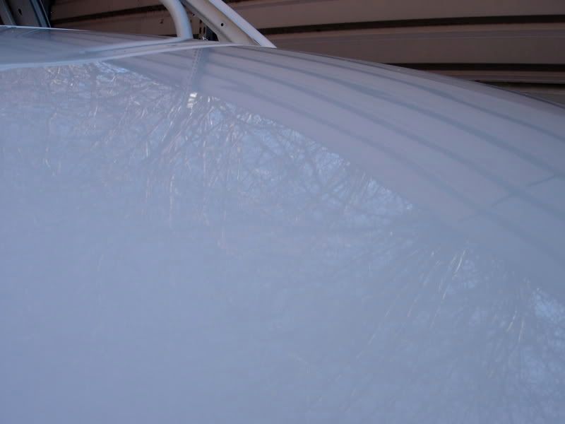

The paint finish is as it came out the gun, has not been flatted or polished
http://img.photobucket.com/albums/v3...a/DSCN2330.jpg
http://img.photobucket.com/albums/v3...a/DSCN2331.jpg

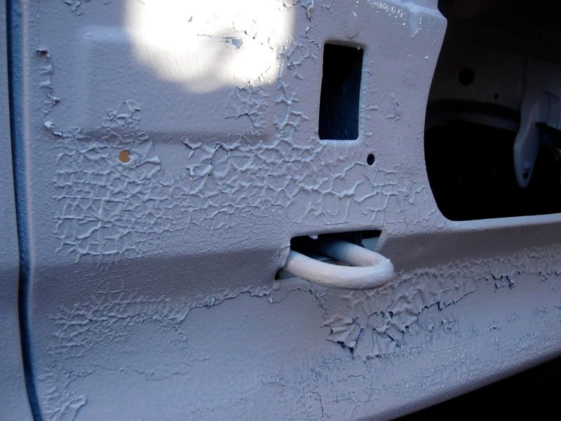

The only downside is the crossmember reacted as I had hammerited it!! I will rub this down and stoneguard it, and it'll be hidden behind the bumper anyways.

looks good from the pics buddy, does he want another nova to paint lol
That looks great Ian, nice one. At least it only reacted where it won't be seen :) Time to start bolting bits on now eh?
looking good mate, you must be chuffed... three years work almost finally complete!
now time to enjoy it :)
Cheers guys, as you said Iain I sure can start bolting bits on and Olz, Im mega chuffed mate! Its getting there!
time to start building it back up now then :thumb:
looks a good paint job also
Looks really good mate, as you say dont matter about the front slam etc, but dont let that water sit on it, as the paint will be soft still and it might leave a pull/blister type mark.
All good though.
Looks good now
always nice to bolt bits to a nice clean shell
keep up the good work
Car looks fine mate, at long lastlol
Looks awsome mate :) Can't wait to see more pics of it
Thats super mate!
Now wear cotton gloves ad take your time putting it back together! lol

Looking sweet dude, i do like a bit of cage action.:D

Looking great ian, looks like its rolled straight out of factory
You should be very proud of what you've done with that shell mate.
Looks the business and I'd say its good and strong.

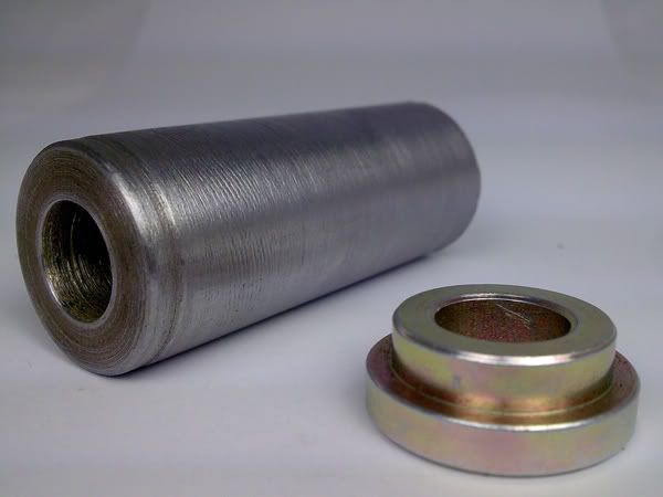

First things first I had a spacer made up to mount the topmounts to the coilovers so as theres no play. As when you bolt them up with the 2 supplied spacers theres still like a 10mm gap. So rather than pack it out with numerous washers I had this spacer made up to the same outside diameter of the supplied spacer and the same size internal hole. The pic shows it as one length as I've cut it to the exact size I needed
Spacer I had made on left and supplied spacer on right
http://img.photobucket.com/albums/v3.../spacer_01.jpg
Comparison of diameters of the spacers
http://img.photobucket.com/albums/v3.../spacer_02.jpg
Will get some pics of them fitted on the coilovers. Got to have them lathed down a little so as there 100% flat as I couldn't get the straightest of cuts!

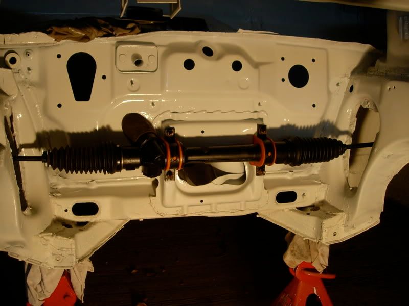

- Quaife quick rack internals fitted into a reconditioned rack along with a new pinion bearing

- Rack mounts painted and fitted with poly rack bushes

Quickrack internals in reconditioned rack with poly rack bushes bolted up

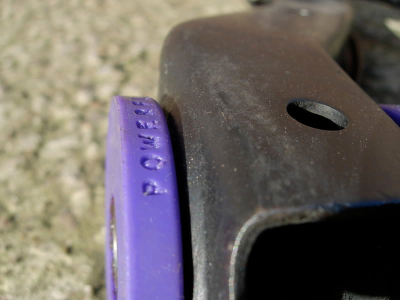

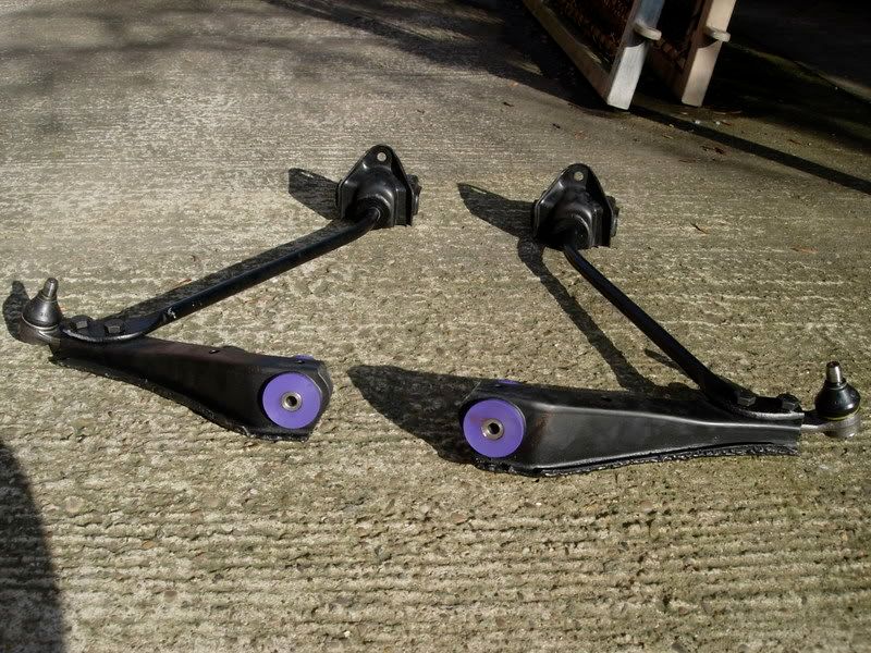

Strengthened bottom arms, tie bars and powerflex bushes all painted up and bolted together with new bottom ball joints
http://img.photobucket.com/albums/v3...a/DSCN2347.jpg
http://img.photobucket.com/albums/v3...a/DSCN2348.jpg

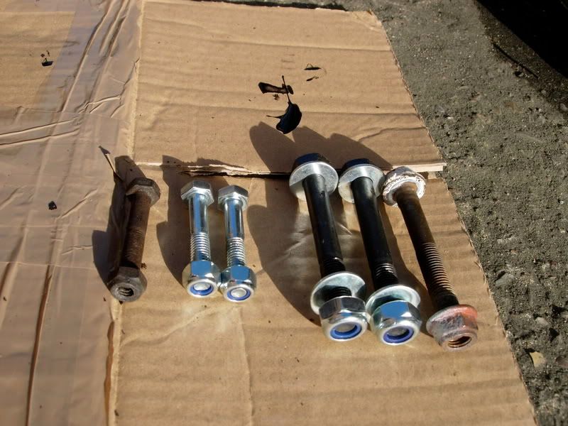

Picked up some new bolts for the TCA's and Bottom Ball Joints
http://img.photobucket.com/albums/v3...a/DSCN2349.jpg
Where you get the new TCA bolts from? I need one lol
